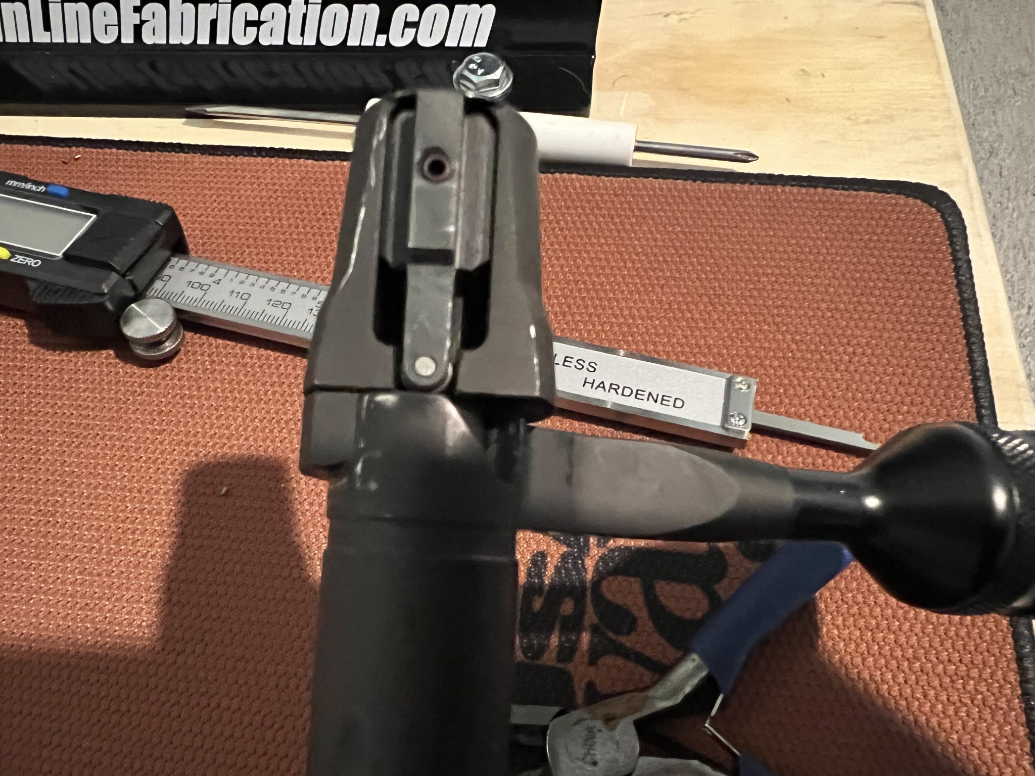

I relubed everything. I'm not sure what you mean by the bolt being in the decocked position. I'm pretty certain the bolt is put together properly. It really only goes together one way. Everything feels fine until I dry fire and try to lift the handle. Here are some pics, let me know if these are wrong.

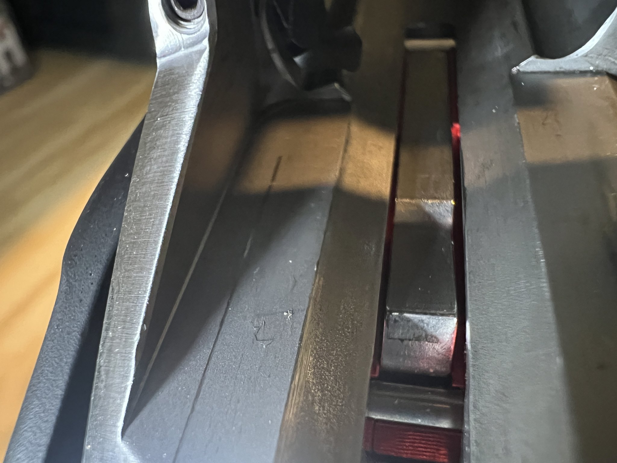

Is the front of the bolt handle rubbing on the chassis? Doesn’t really look like it, but…

I was just concerned that there might be wrong with the cocoking piece tip and thus result in extra friction when opening the bolt. But from the photo everthing seems fine.
