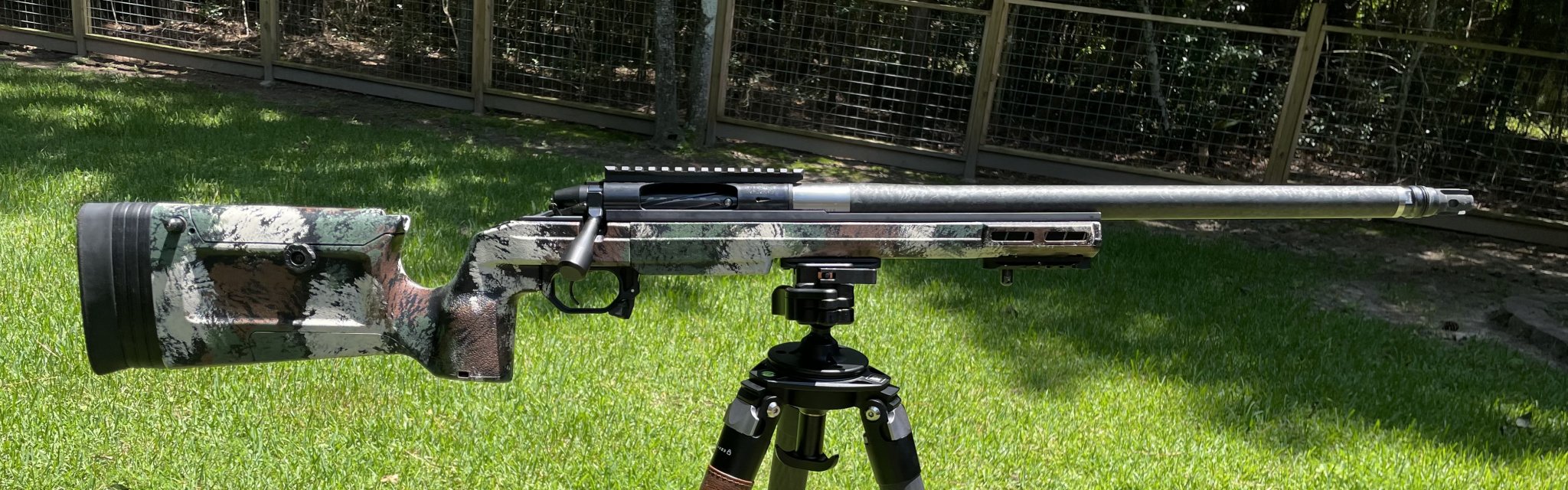

That led me to a Bighorn short action Origin to start with. It was a great action and I had the ability to run barrels cut for a TL3 or an Origin, with an HLR recoil lug. Found a great deal on a 20” proof 6.5 cm prefit for a TL3, threw it together and slapped it in a Bravo.
Here is the old SA build:

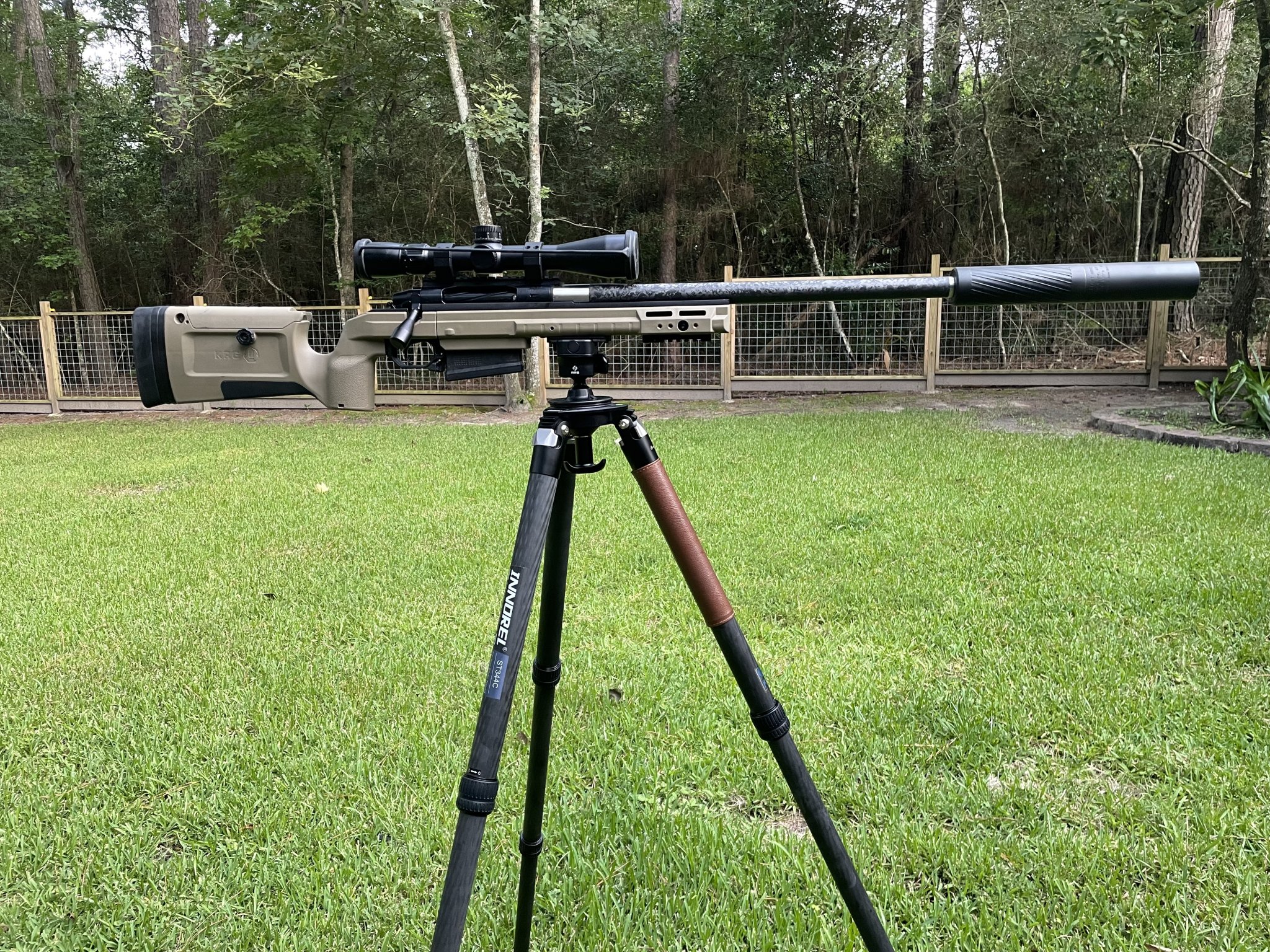

I ended up trading my SA origin+bravo for a LA origin+bravo from another hide member. Slapped the barrel and trigger on, checked the headspace with the 6.5 proof prefit, and low and behold it’s good to go!
The next unknown was how to reliably feed the 6.5cm from LA mags. For initial trial runs, I purchased magpul 30-06 mags that are the standard long action mags. All I had to do for them to feed correctly was the extend the follower spring some to provide more force on the follower.
Great thing about the bravo is it comes with a spacer for running standard LA mags and it can be removed to allow room for CIP mags. But, not all BMs or chassis come with this option to accommodate both sizes of LA mags. I’ve been eyeing the XLR Element Magnesium and if I wanted to feed it 6.5cm along with cartridges that would benefit from CIP mags, I would have problems. The 6.5cm kept nosediving or the case head would be too low out of a CIP 300wm mag.

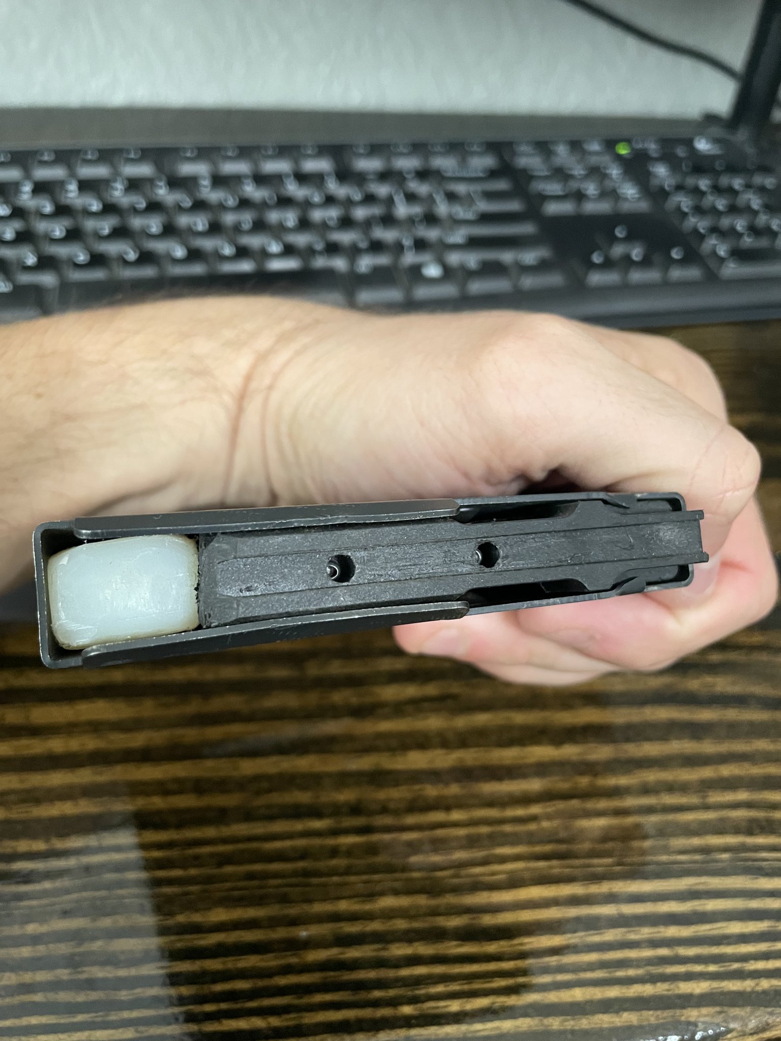

I’ve seen the 6dasher kits for 308 mags so I thought why not try it with a CIP 300 wm mag? Welp, I hacked off the rear of follower, fit a chunk of plastic in the rear of the mag, and still had problems.
The follower spring kept getting stuck on the indentions inside of the magazine as it was pushed forward with the spaced. Made the spring narrower to clear the indentions, then the spring did not have enough force on the follower to feed reliably. Scrapped that project and went back to the drawing board.

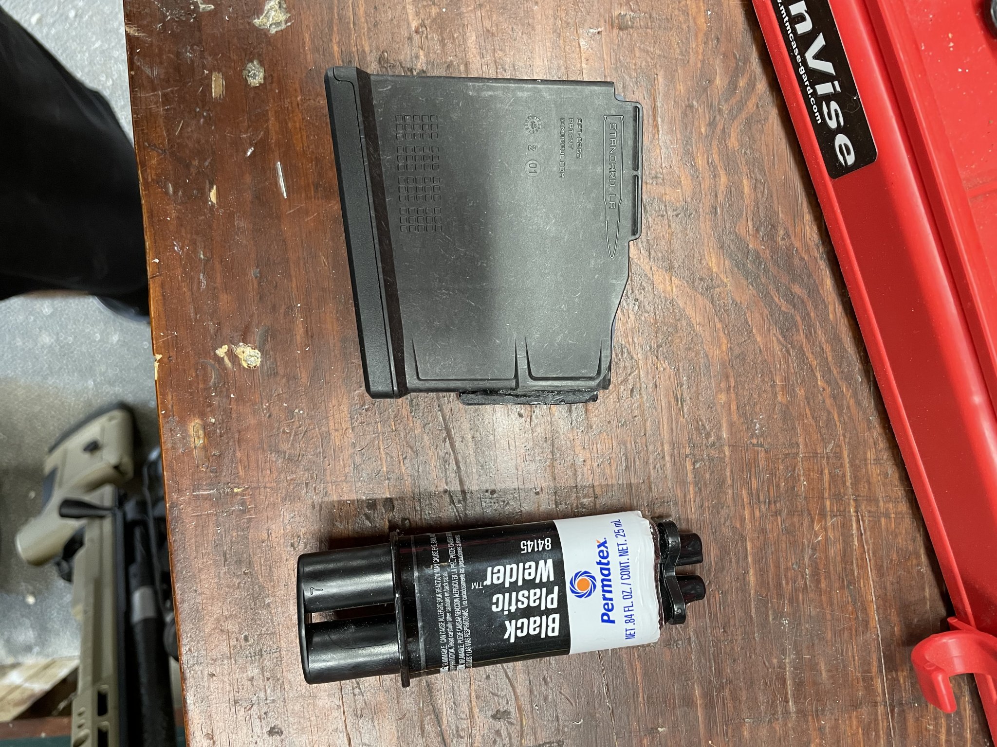

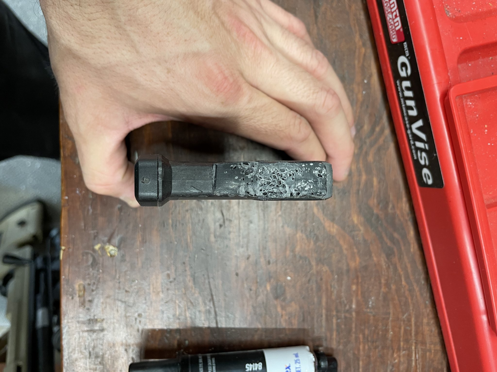

With how well the 6.5cm fed from the 30-06 mag, why not make it fit for a CIP well? With the use of plastic welder and my Macgyver skills being on point, I added length to the 30-06 mag. The plastic welder adhered to the magpul surprisingly well too.
Even though it looks like hammered cat shit, it runs the 6.5 cm rounds through the origin like shit through a goose.
