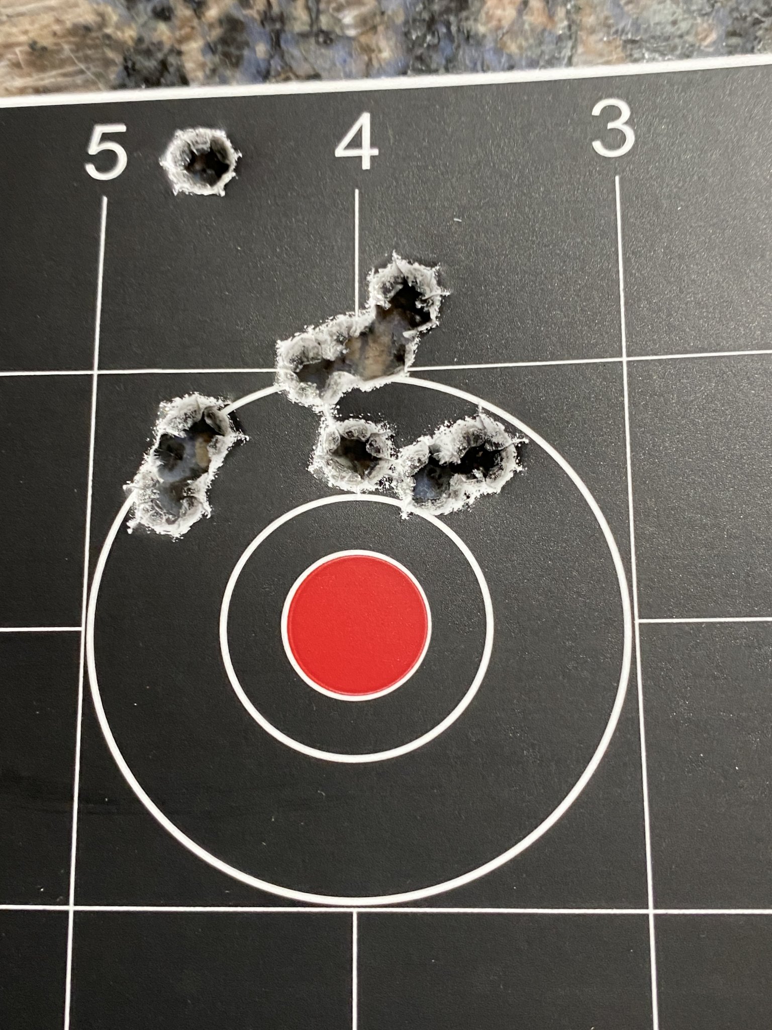

Here is today's shots after sighting in my new scope with the 6.5 CM Edge 16.5 barrel with a Thunderbeast Can. This 10 shot group was with a hot rifle on shots 20 - 30 in about 30 minutes. It was good shooting for me at my skill level. (100yds) indoors off bench. Hornady Bulk American Gunner 140 HPBT not the Match Grade
