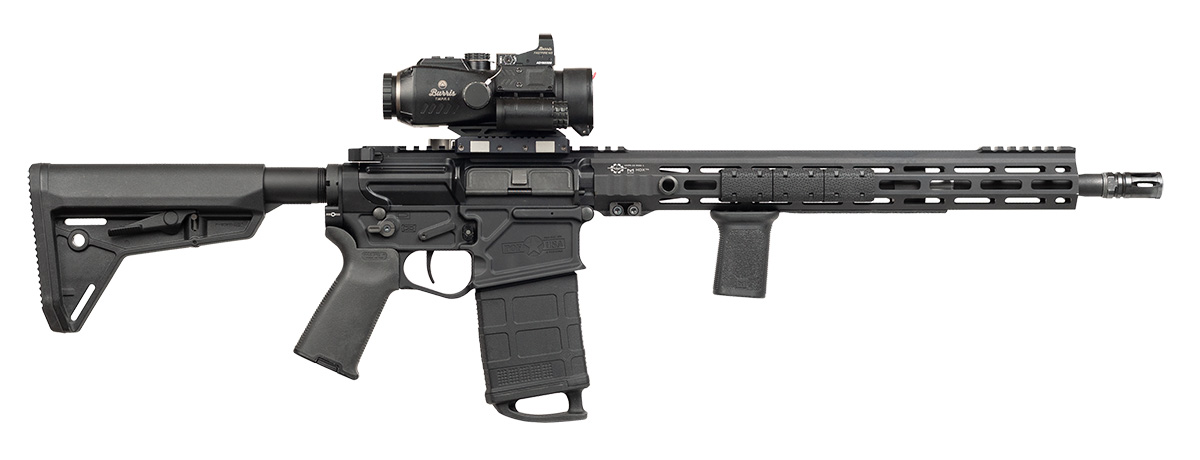

I have POF Rogue 16.5", and so far I've swapped out:
- handguard + barrel nut (handguard anti-rotation tabs even fit perfectly on upper)
- muzzle device (it is 5/8x24RH threaded)
- pistol grip
- charging handle
- ambi safety right side lever (interchangeable with BAD-ASS levers)
- mag catch (using a Norgon AR15 ambi catch)
- recoil buffer (went to an AR15 H2)
- buttstock
I guess there is a lot of proprietary stuff happening with the BCG, but there are tons of AR15 standard parts on my Rogue.
Looks great! POF does say there are numerous parts that are interchangeable with an AR15 like the ones you mentioned above and even drop-in triggers. But many are proprietary. Even the take down pins are proprietary to POF and don't match anything else out there. It's tough to drop weight and not loose some functionality of the original design like the finned barrel nut (and the barrel extension itself).
