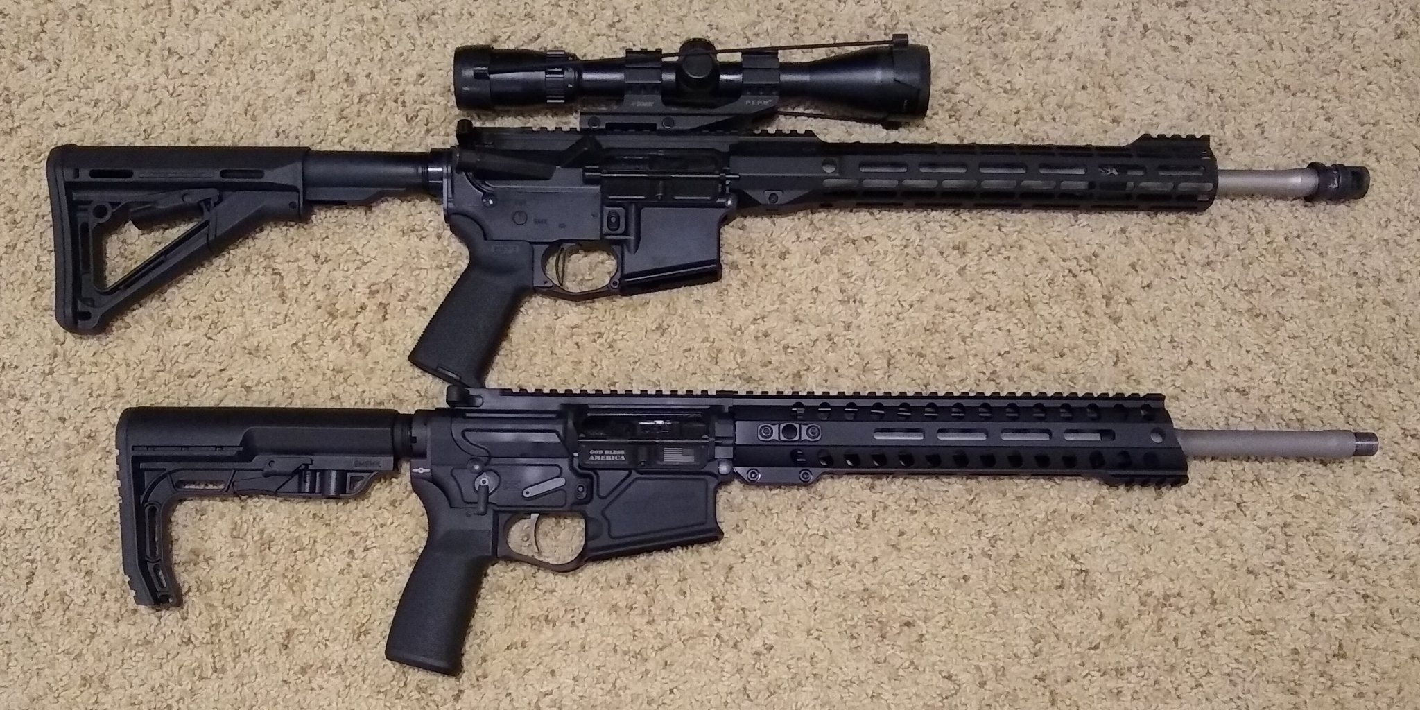

I've been experimenting with various bullet weights and I've shot everything from 147gr. up to 200 Gr. ELD-X. I'd say the rifle tends to like bullets in the 160-180 gr. range although it'll do well with lower weight bullets in the 150 range. I'm still trying to see if I can dial in a 200 grain and I've not tried any 110 grain rounds yet but those sound really fun. I've managed to get sub-MOA with everything from 150 grain up to a 167 with relative ease (4064 or less so with Varget).
