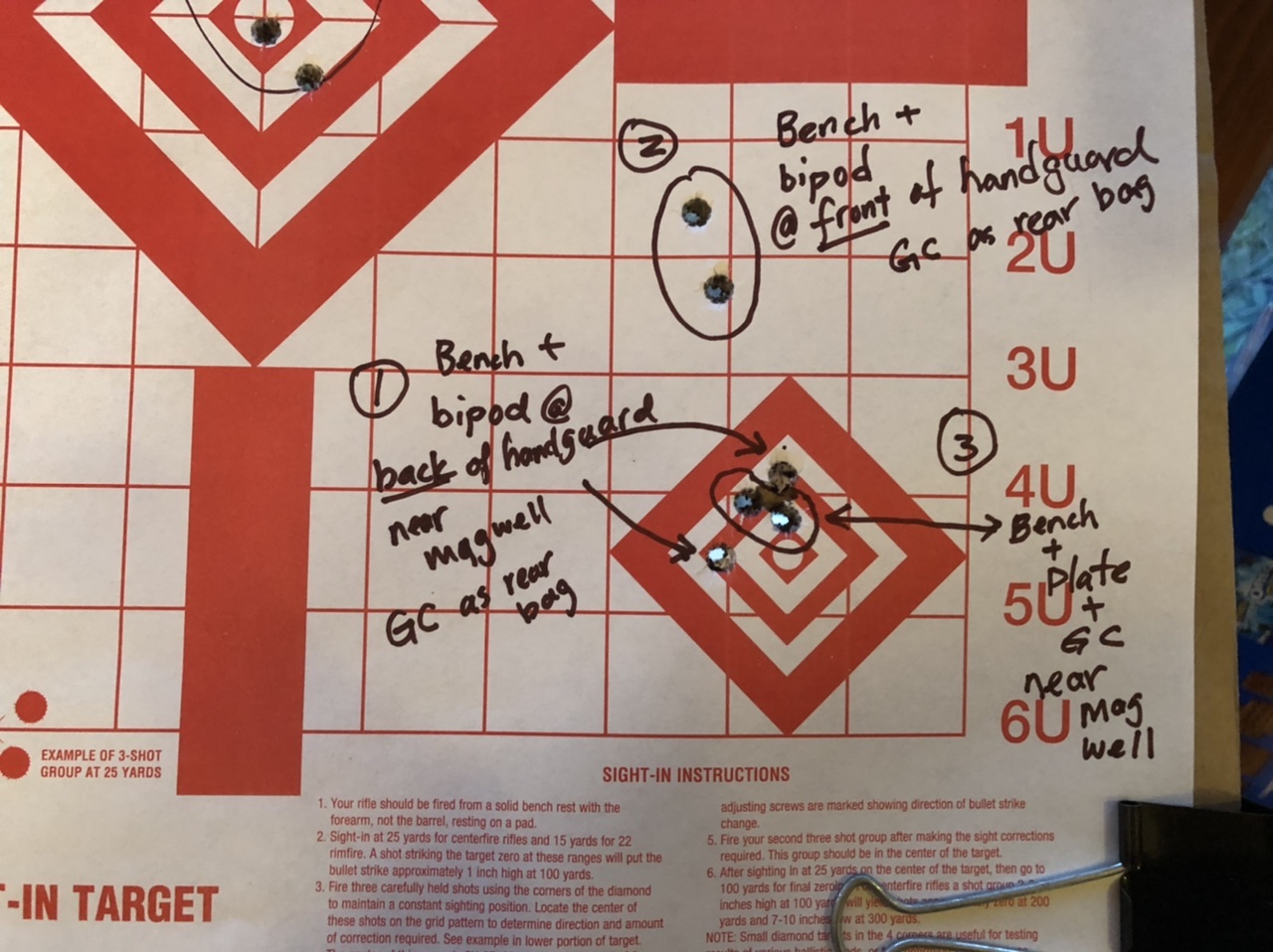

Knownothing: I can’t believe it! you are right on the money, so let me first say thank you! I did 2 separate exercises proving the theory first my targets and then #kraftdata. Pics to followed.
ETA: just to clarify, I zeroed from standing position, so bipod at front is now high which is the same as the subject title.
3 setups all shot on bench. 100yard.
1: bipod near magwell
2: bipod very front of handguard
3: Plate on top of GC near magwell

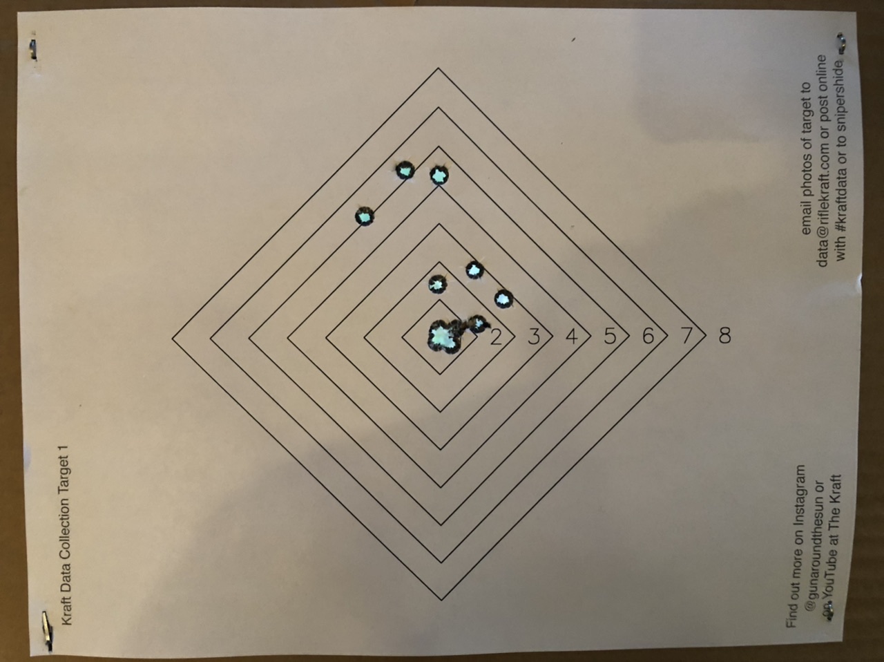

Pic is a rifle Kraft esque target from all positions:

Same result using Caldwell (The Rock) front rest. I actually wasn’t aware of the POI shift since I’ve always shot off bench using front rest or Atlas bipod - shooting for group, dialing in my reloads. The scope was zero for Benchrest type setup and has always been consistent (albeit off) so never realized the issue. It’s safe to say it’s not due to bipod loading.
My feelings after all these is the flexing and/or what knownothing suggested, The rifle is a RPR so it has a free floating barrel…but it’s really hard to convince myself it’s the rifle’s fault.
Look at the Kraft target. I had 9 shots from standing,kneeling, and seating without rear support at ~1MOA. I’m more than happy if I can shoot that at match. So If it’s any fundamentals issue it seems to only shows up from bench/prone with support up front. Any corrections idea are welcomed.
ETA: A buddy and I will do the Kraft target both using his rifle (also 6.5CM). I think that will put the suspicion to rest.
Some video of you shooting standing with a bag and then prone would be really helpful….what does your prone look like, where’s your left hand when standing, etc.
Also, prone is different than “from a bench” which has its own set of problems because of the terrible angles/difficulty getting behind the gun, hard surface, etc.
That Kraft target has a few centered shots and three that are starting to drift high and three more that are high misses. In my view, one of the other positions is also not right.
Try some NPA drills with no rear bag in PRONE (not off a bench). Can you support the rear of the rifle entirely with your shoulder/body/hips, through 5 dry fire cycles, without the reticle moving off target at all? With a rear bag, can you center the reticle, close your eyes, take three breathes and open your eyes without he reticle moving at all? Once you can, try getting completely stable, close your eyes through a breath cycle, and send a round without reopening them.

Unfortunately didn’t get to try another rifle last weekend but I did shoot my rifle again in prone in other “different fundamentals” to get POI to shift down.
What I mean by different fundamentals are free recoil, hard press with the cheek, light press with the cheek, hand on top of scope, hand holding down the area419 plate, support hand squeezing the rear tight/light, pay extra attention to center of eye box, verified no parallax shift, etc.
Ran about 30 rounds, not a SINGLE round I got the POI to shift down. Basically I tried lots of things I don’t normally do and same result, can’t imagine I can be that inconsistently bad.

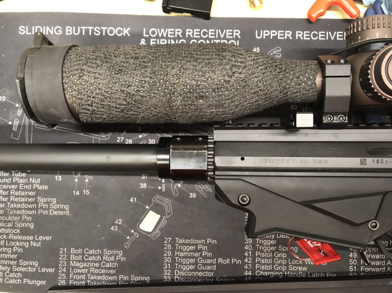

Went home took the front end off to check everything. Barrel nuts are 100% tight, the design makes it impossible to backed off anyway cuz it notched.
The forend nut is sitting in front of the barrel but also tight, but seeing the forend nut is touching the barrel , it does made me think that it COULD interfere with the barrel. Harmonic perhaps. So I’m not even sure this is considered a free floating barrel cuz the forend touches the barrel thru the forend nut.
Barrel nut is up against the receiver. The wider nut next to it is the forend nut.
