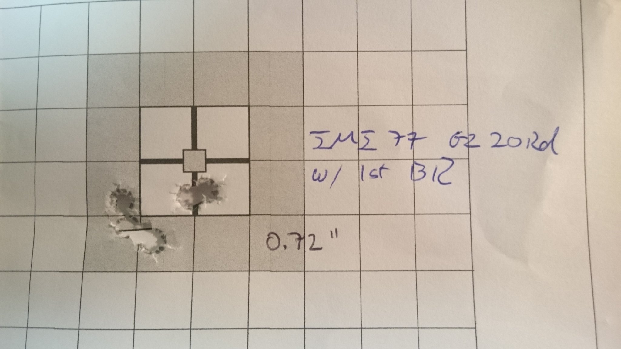

Possible. I noticed some odd flyers a few years ago from my AR. Isolated it to a Gen2 20rd Pmag. This is 2 separate 3 shot groups on top of each other. The first round out of that PMAG would consistently have a different POI from the rest of the group. 1st round is just below the bull, next 2 rounds low left.
I switched a G3 Pmag and it went away.
Reactions: Greedmoor
