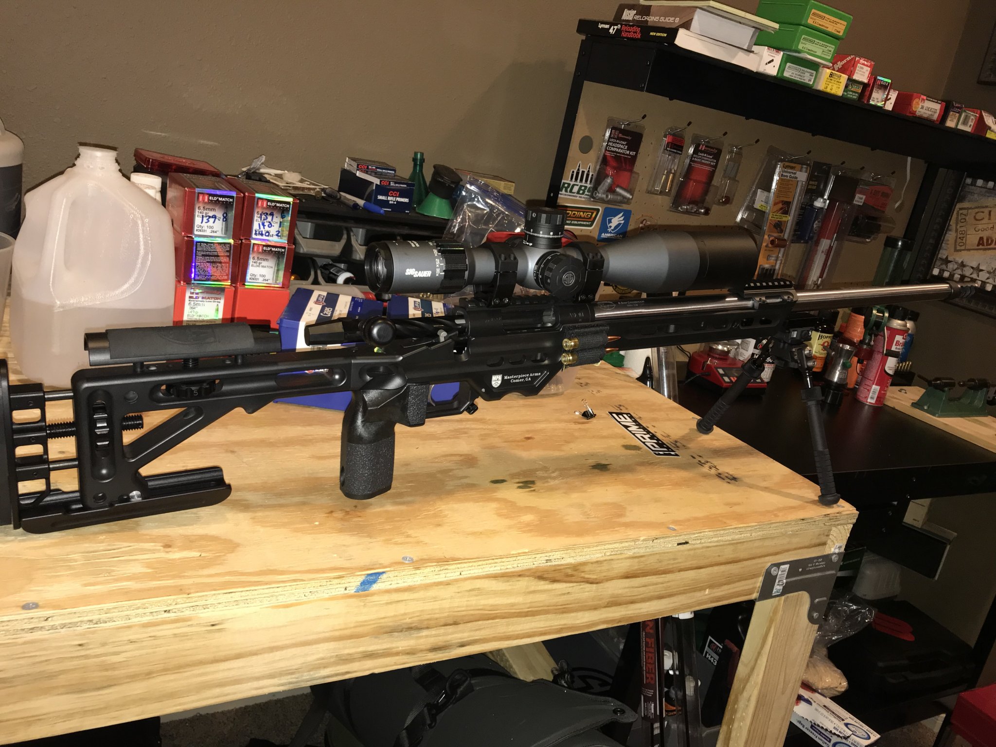

No worries definitely just constructive criticism. Those who cant take it never learn and that is my intent so thank you. All makes perfect sense. When I first started shooting seriously (within the last 1.5years) I pretty much just shot off the bench at 100 yds. Then got more interested in long range precision shooting and here we are. So I think I will tweak rifle setup to prone and like you said adjust to everything else. I know there are tons of thoughts on LOP but how do you personally set LOP for the prone. MPA chassis so pretty adjustable. Thanks for all the help btw
I adjust my length of pull by 2 factors. (this is my way, others may say different and you'll have to find what works for you)
  1. Head placement on the cheek rest. I want to place my head near the center of the rest. This is a position I can index each time I mount the rifle. This can be indexed from any position. With a good cheek weld and good recoil mitigation you can spot your shots much easier. Having the cheek rest at the correct height for the optic is critical while doing this. Sometimes you'll need to take a photo of this position to fully understand where you head is at on the cheek piece.
  2. Angle of the trigger hand while holding the rifle and squeezing the trigger. Too tight of a wrist angle can make shooting uncomfortable and reduce the 90 degree finger trigger control. If I can not hold a prone position for a good while without resting the wrist I am in a bad position. This factor is different for each person depending on how they hold the rifle. Some don't hold the grip much, others apply pressure to the rear which changes the wrist angle as well. Fundamental Frank will want reward pressure applied equal to about the weight of the rifle.
You'll have to to work with 1 and 2 to find the sweet spot. If 1 is just right but 2 is too close you may have to sacrifice on 1 a bit to get 2 to work as well. Its not worth pulling the trigger if you can't pull it correctly.
Items to note:
  • I like to place the optic on the rifle to find the correct cheek rest height, then remove the optic and work on 1 and 2. After the LOP is set, mount your scope to fit your eye relief needed on max power. Make sure your don't have to 'rubber neck' forward to get the perfect site picture.
  • Shoulder pocket placement is critical during this setup. You have to know where you are going to put the rife every time. Have a look at this thread for more on that topic--> Shoulder Pocket (watch Phil's other facebook videos and you'll see how he holds the rifle with his trigger hand as well, its a bit different than Frank)
  • While setting this up clothing is a factor to think about as well. Summertime is T-shirts and wintertime is a thick coat. I set mine up in a T-shirt for summer shooting, when I do most of my shooting. If I am shooting a lot in the winter I might reduce my length or remove a spacer (during the winter only) to account for the thicker clothing.
After you have gone through all of this, you'll likely change or slightly adjust things the next couple times your shoot. Frank's analogy is: you have to adjust your car mirrors and seats the first couple of time too. Its a process to get it just right. I find dry fire can help with the initial adjustment, after that its fine tuning while shooting.
Best of luck
