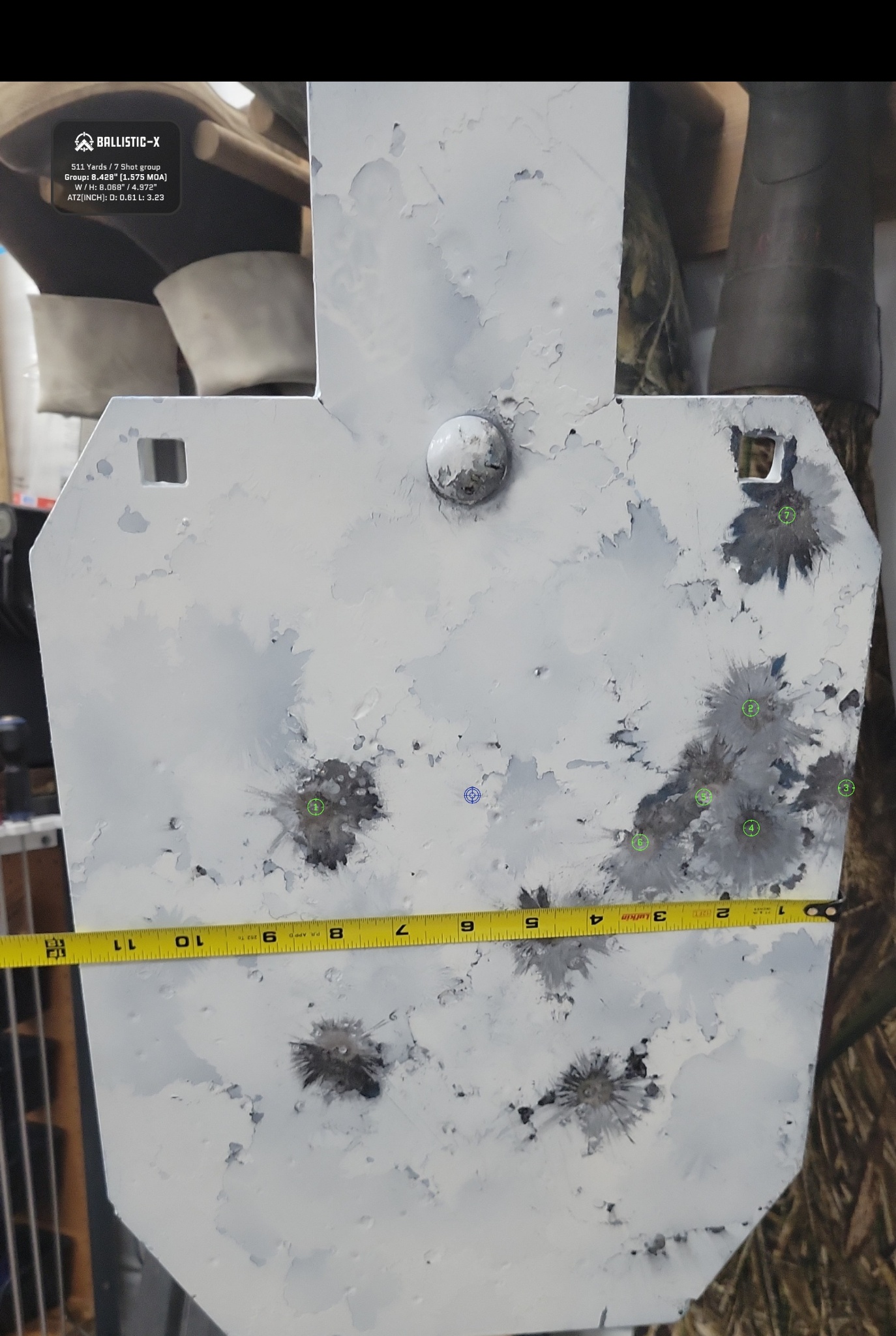

Maybe this will help (or hurt) the discussion.
Another reason I am thinking brass prep and maybe a shooter issue or a combination of both. I shot the far right group at 511yards prone (taking my time) to get dope on the gun( shots 2-6). The shot above the group was shot 1 then I adjusted my elevation.
I grabbed another round of a different lot of brass that was not the same length trimmed but loaded at the same time (same lot powder, primer and bullet) and I got shot labeled number 1 to the left .
Now there was 0, i mean 0 wind, and what wind I did have was from the left @ 10 oclock.

Maybe this will help (or hurt) the discussion. View attachment 7940122
Measuring shot groups at 500y plus for purpose’s of tracing said group size to an ammo production issue is pointless. Trim length variance (unless its literally Yuge) wont make any difference either.
All the target tells me is that the load appears to be performing fine but you didnt hold quite enough for l-r wind/spin drift.

I was using this as an example of what I see at 100 yards, a random but consistent 1 moa shift.
