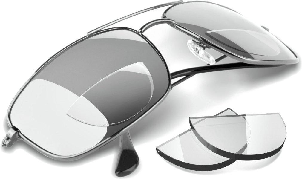

They make plastic stick-on cheaters, I've used them. Put one on the lens of the eye you are not looking through the scope with ( in the bottom half). They are crescent shaped. They come in different powers. That eye can read the turrets and not mess with your scope. I think by closing your eyes you eliminate one fundamental- follow through.
