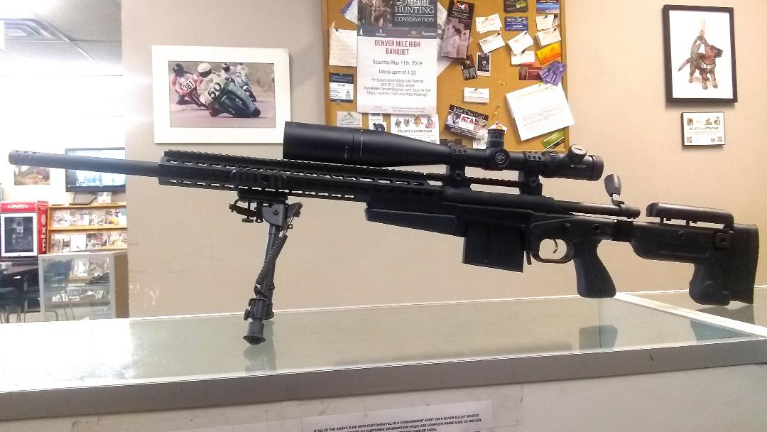

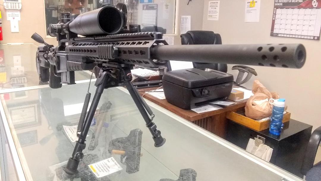

I have this Rem 700 MLR in 338 Lapua.
It's the model that came with the AI stock.
Load is Berger 300gr over 81gr of H1000, 2470fps, pretty mild.
Not my most accurate rifle, but then again I am the limiting factor.
What puzzles me, though, is the POI shift that I experience every time I shoot more than 5 rounds in a row: impact gets lower and lower, walking probably 2-3MOA down from zero by the time I get to round 10.
If I let it cool 5-10 minutes it returns to zero.
It is the most I have experienced with my rifles and it gets me wondering whether it indicates any hardware issue (action screws etc...).
All screws are torqued to specs, action screws, base, rings etc.
So guys, is this to be expected on a24" barrel .338 Lapua rifle or is there something I should be double checking?

First off... That scope is garbage...second it looks like it's touching the rail

Thank you for your replies.
The scope does have clearance from the rail, no contact, definitely a picture angle issue.
Huskydriver, as far as the scope being garbage, it is your opinion and you are entitled to it, but it was not requested, nor it's relevant to the discussion.
The rifle does return to zero after cool down, so, unless I am missing something, the scope is not a factor.
The question was: is such a POI shift possible to such an extent just because of barrel heating?
It is indeed a large caliber and the barrel is quite hot by shot 10, I just never experienced it to that extent...
It is not a problem, since the rifle as such is not meant for "rapid firing", just a curiosity.
