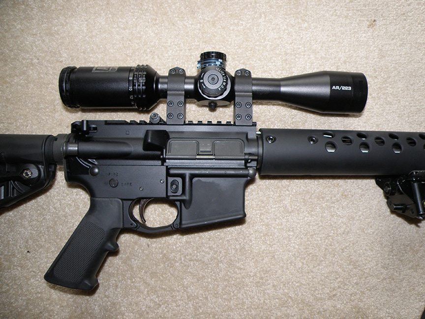

I haven't read all the posts, but the first BIG PROBLEM is your mount for your scope. I can not imagine how you can even see through it. Your cheek weld must be lined up with your eye socket. For me I need 1.5 inch from the top of the Picatinny rail to the middle of the scope rings. Your rings are made to be used on a bolt action rifle where the stock drops down to fit your shoulder. The AR 15s stock comes straight out from just below the charging handle so to get a good cheek weld you have to move the scope UP. This means new rings.
The second problem with your poi shifting as you shoot is usually caused because the barrel is too thin. A heavy barrel that is Fluted does not heat up as fast and the Fluting helps to dissipate heat and saves some weight.
Take a close look at mine which is set up pretty good. It has a Colt lower with a Geissele SSA-E trigger. The upper is a WOA 18" Varmint upper with a 1 in 7" twist and is Fluted. I have a Bushnell AR/223 scope with 4.5-18x44mm zoom with tactical turrets which are very repeatable. The scope mounts are Warne QD ULTRA HIGH ALUMINUM rings. They are very strong and light.
PS: The scope is not bent the photo is distorted.
