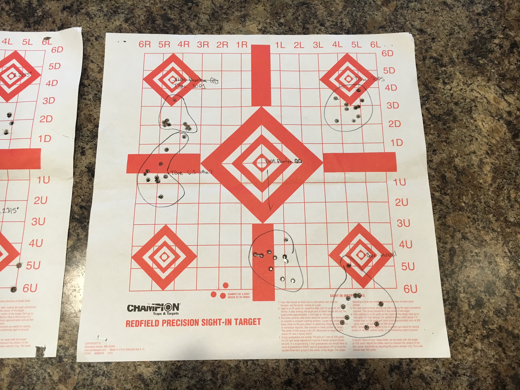

    I’ve posted this before. These are 2-5 shot groups with 4 different suppressor. Not all tbac. The bottom right is with a bare muzzle. I shot 5 let cool and switch suppressors and shot 5. And so on and so on. The 6.5 ultra 7 actually raised my poi. Each group was aimed at the center of each diamond.
    Sako 75 varmint 223
    Fiocchi 55gr vmax ammo
    Rifle was threaded leaving the factory crown
    7118671

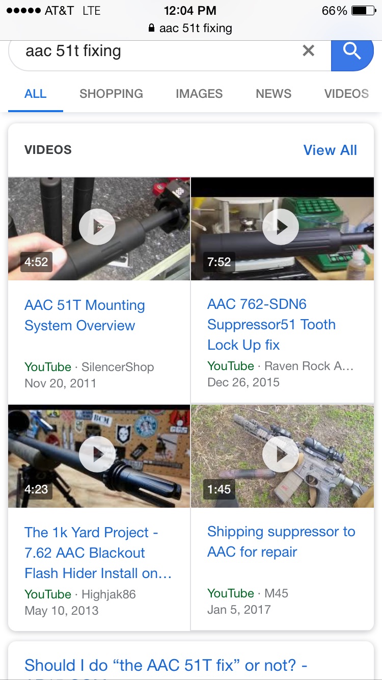

    Here is a video with the SR mount
    Here is the Ultra series
