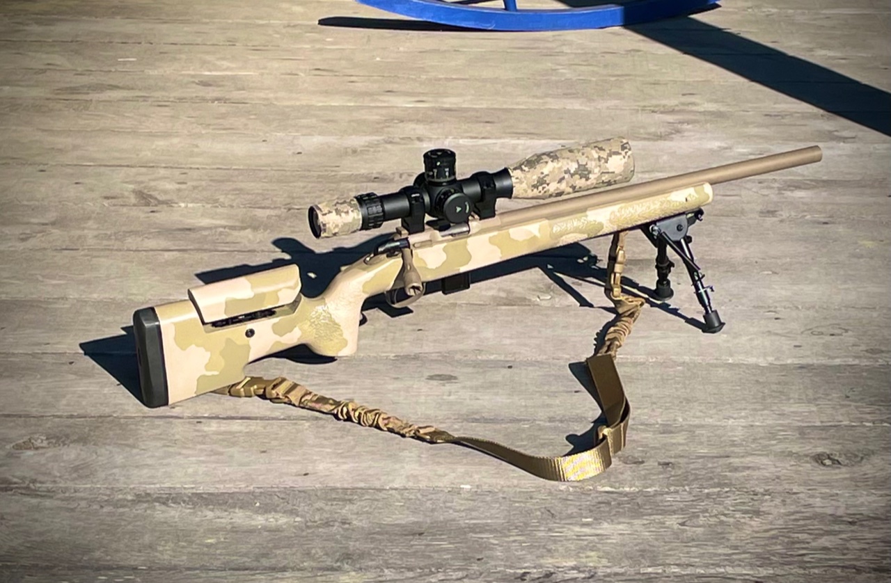

    I used Polar Biathlon in a 35 spd with good effect last winter in my CZ457 Factory BR rifle. It recorded a couple of perfect ARA cards in competition before it ran out. It worked in my Sako Quad Tactical very well also. I used it in temps ranging from below freezing to 65 deg F. It is faster than CX/Midas/Xact but at 50y that was only one or two clicks down on the scope. I liked to joke that the ammo was "Bi-Polar" it shoots high sometimes and then it shoots low sometimes, lol. But, truly it shot very well all the time. About the same time, I got some Biathlon Extreme. My CZ did not like it but my Sako shot it into amazing tiny little one hole groups. The catch is that the match chamber in the 20' Lilja bbl would refuse to eject about every 3rd round. I talked to Luke about it and he said that the Bi-Xtreme has no lube on it since in super cold the lube gets hard and gums things up. In the cold it shrinks the round and in theory it fits and functions but in practice, it is an issue with rifles who sport a tighter chamber in some cases. He suggested spraying some dry slide or case resizing lube on it but some sanctioning bodies prohibit such treatments. Lapua is discontinuing that product. It only shot OK in the CZ. I have one brick of Lapua Pistol King. Its speed code is 17 which is 317 M/s or 1040 f/s. This is much slower than all of my other ammo. In my rifles it did not shoot all that well. Seemed to have more variance in the vertical. Also, seemed less stable than the faster ammo. Have never had any Pistol OSP.
    My experience with Lapua is that most of their ammo is very good but certain speeds will shoot better than others in different guns or different conditions. I had a lot of X-Act that shot so bad last winter in the cold that I had written it off, but later in the spring after then temps reached 60+ deg, it became amazingly accurate and was used in several matches with great scores every time.
