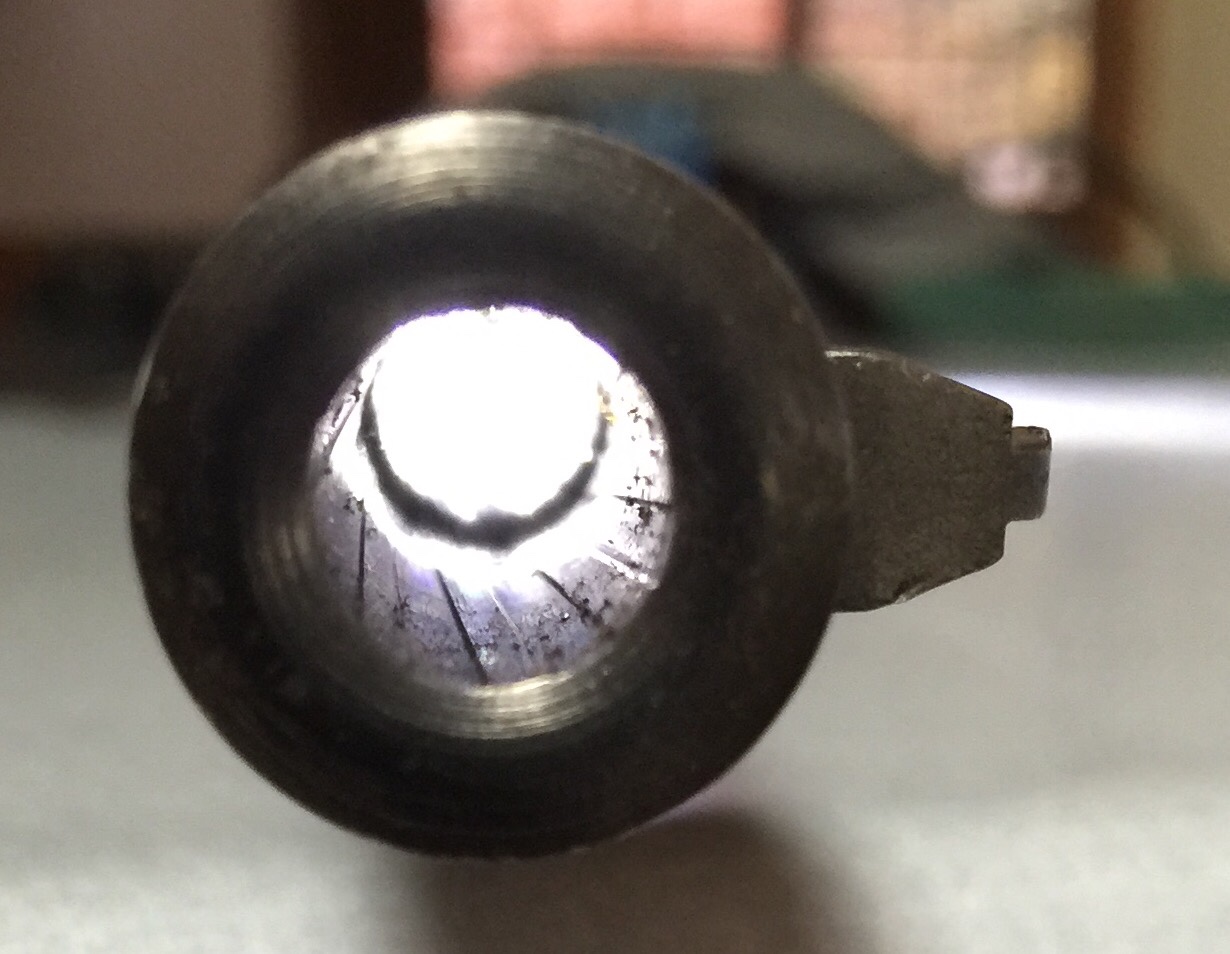

Thanks for your insight. My chambers have always had a good finish with no imperfections right off the reamer. I like the idea of honing as you describe. Thanks for your time!

Thanks for the information. I respect your position on this and can say I share many of your views.
I have always been of the opinion if everything is to proper dimension surface finish (within reason) bears no role in function.
Thanks
Post a picture of a fired case if you can. Depending on how bad the ring is below the shoulder it might not be worth the time/effort messing with it vs. letting Ruger fix it.
