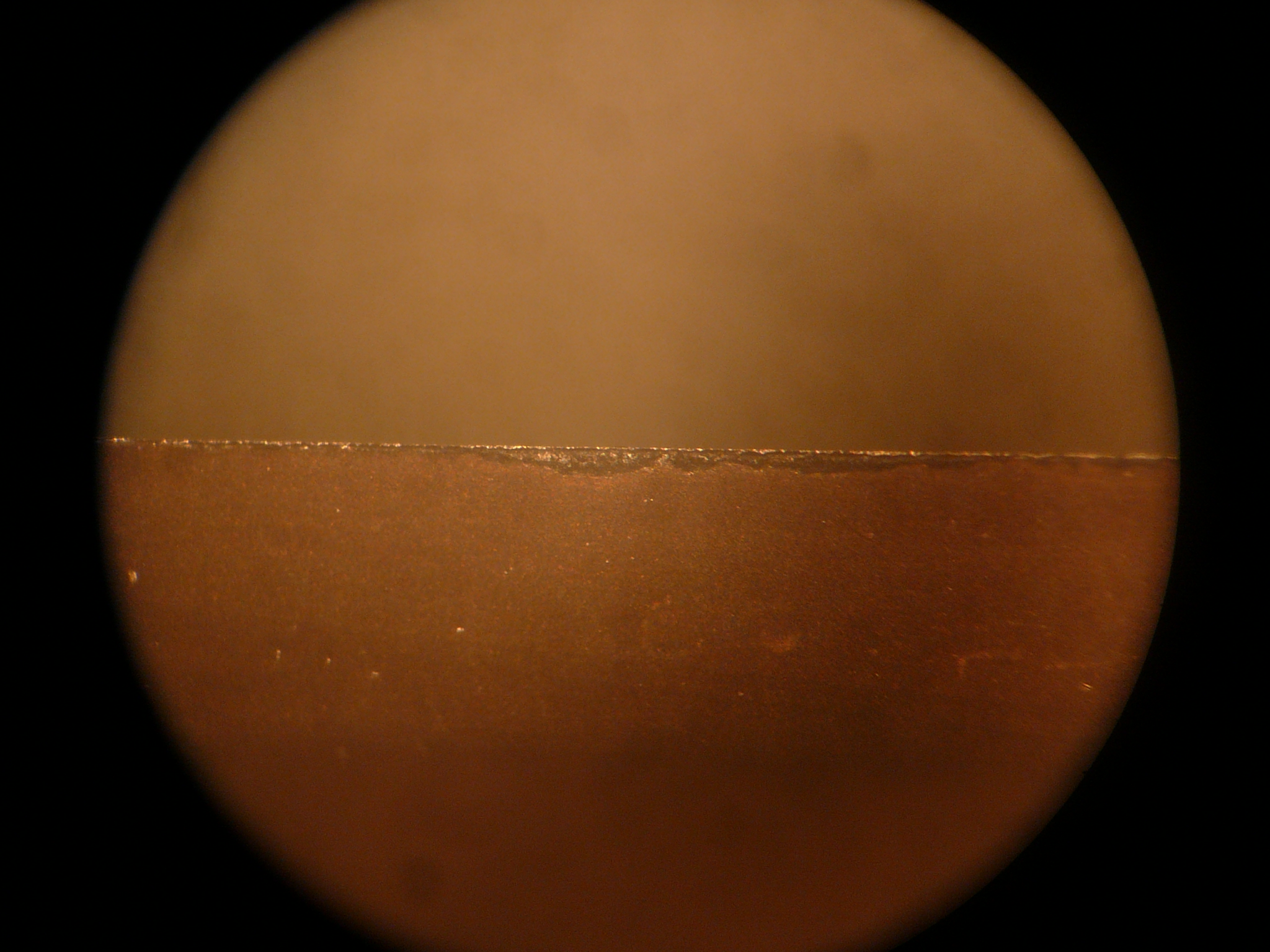

Everyone I do. During the life span of the reamer the finish changes. Also not all reamers cut the same when new. Below is the face of a flute in the body area.
