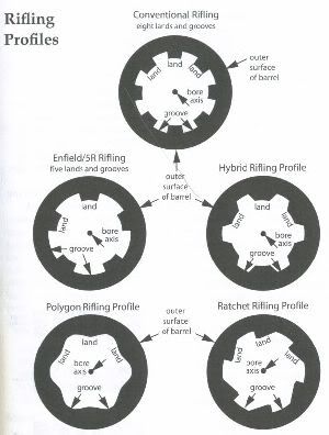

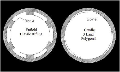

    Every barrel is a polygon so you could call any barrel a polygon and not be lying BUT HK, Glock and Lothar Walthar are true polygonal barrels. Some are female type and some are male type. Some barrels called polygonal are really more like a 5R sloped land kind of rifling(Noveske). From what I have seen of the BHW/Columbia barrels the lands are shaped like triangles very pointy and not very wide.
    No, it is not.
    Polygon means multiple corners.
    A polygonal barrel has no lands or grooves, it just has corners, its profile is a hexagon (most of them) or an octagon, etc.
    Just sometimes, what I know, the corners are rounded.
