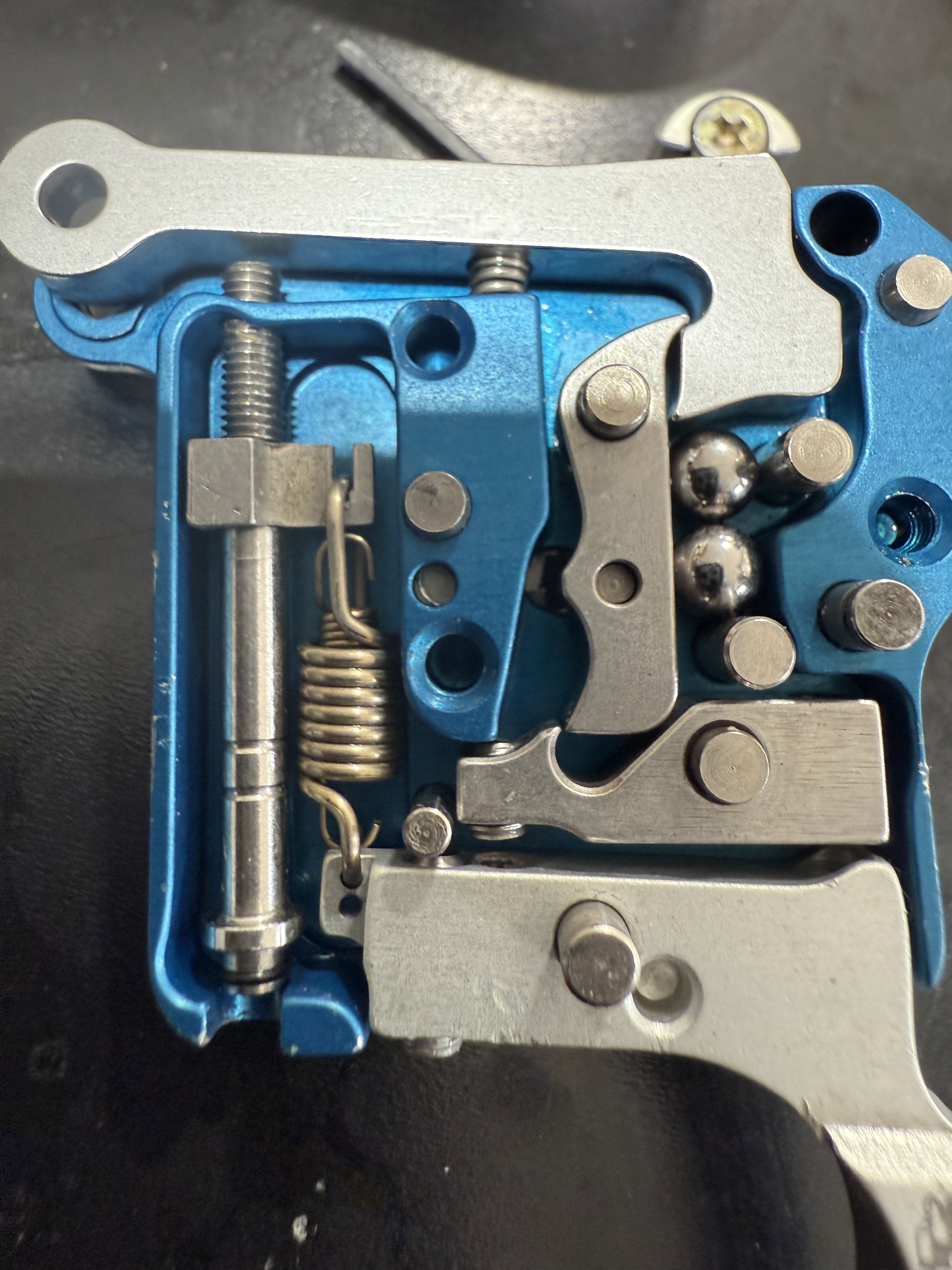

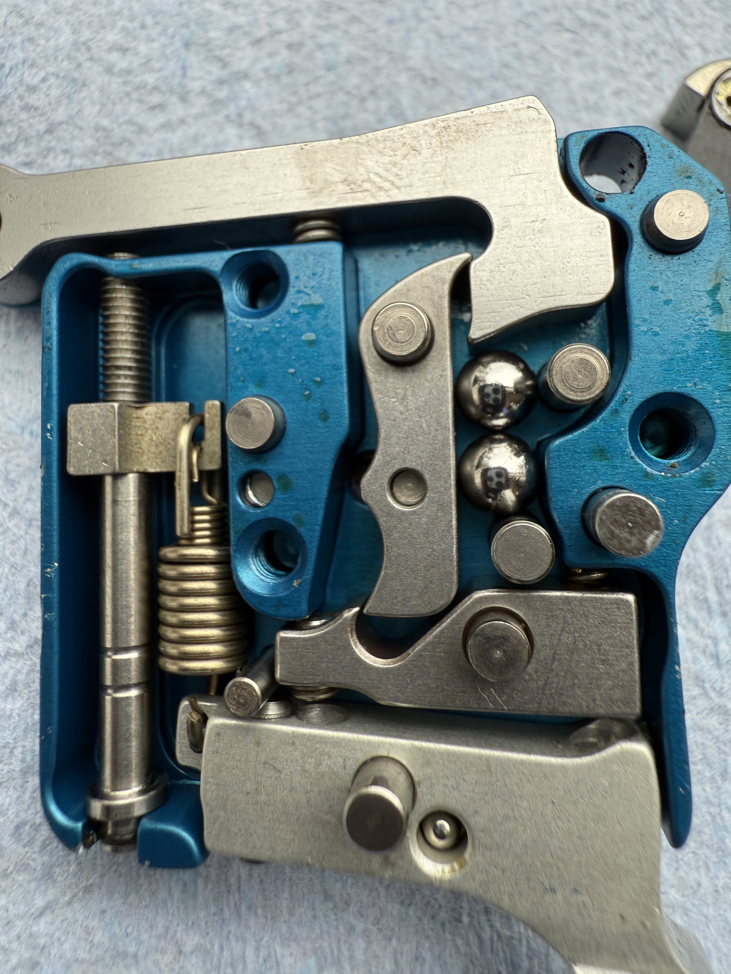

Loosing component. Oh my god. I nearly lost the top seat spring twice and one of the balls once. Spend 45 min finding those. I just hope I have not lost anything that’s why it’s not working.
Is there a Bill of Material you this trigger anywhere. Will cross reference and see if I am missing a spring or something
It’s been amazing experience today 😀.
I will learn too. I am a tinkerer. It’s just very frustrated right now with the whole things (and some takedown comments here 😀).
Thank you appreciate it. Posted here with hopes of this type of help.
Of small parts
1). I have two large balls
2). 1 small ball by the trigger
3). One small spring that goes under the small ball
4). One large spring that goes under top sear
Test are larger parts. Is there anything I may have dropped lost small parts wise.
Edited for clarity - I have tacsport Pro 2 stage and single stage. Not familiar with the Comp model personally.
That really small ball and corresponding tiny spring are not required for function. It serves to center the trigger shoe. For me, that is the toughest part to get back in place, so I just don’t mess with it. I have 5 Bixn Andy triggers at last count, and have helped others get them running.
The times I have seen trouble are when the trigger gets water or solvent inside it, or when the sear is adjusted incorrectly. I helped a fellow shooter sitting on the steps of a cabin disassemble, clean, and reassemble one before a match last year.
That’s about the trigger. The customer service does seem shockingly poor. I have had good experiences with them, but don’t dismiss yours.
Well. It’s not the company the person you get. And I don’t have issue paying a bit for that. But I did feel rubbed the wrong way with the suggestion that you need some kind of pixie dust to own a BnA trigger
Also I guess likes it Seekins and MPA and even TT have spoiled me by being extra kind when they don’t have to be and in return they get huge loyalty and $$ from me and everyone else.
Have people seen how Glen Seekins and crew behave when there is customer service issue. That’s what you need in customer service business.
Anyway. I was super angry. Now I am lemonade of lemons. Let’s bloody master this trigger. If Jacob can do it I can do it 😀
This is how mine looked this afternoon when j put it back.
dont forget this as well
Yes. That one I figured out just poring over many many pictures over two days. It’s the return spring that I was not clear on. I should not have disassembled under time pressure to send a pucture to BC that I disassembled everything and cleaned. I should have taken the time to first understand each part. That’s how I lost it.
