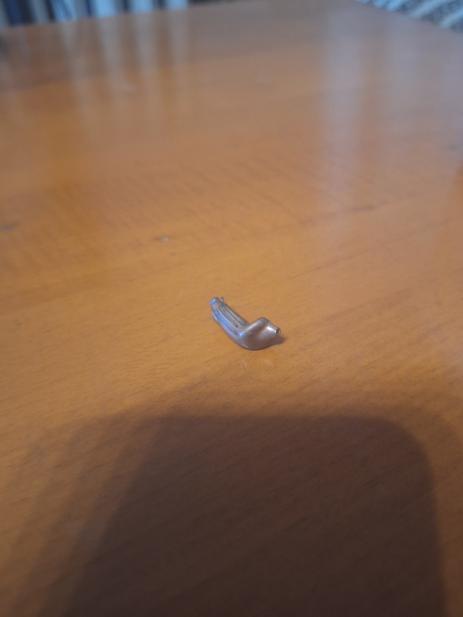

Just happened to have this bullet sitting next to me. I belive it was a 62gr HP we shot a large pig with under 50 yards. No expansion just tumbling.
