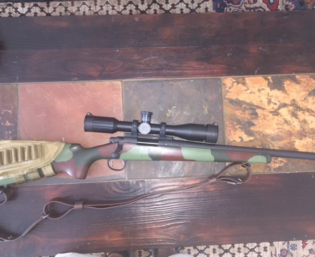

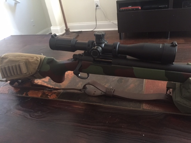

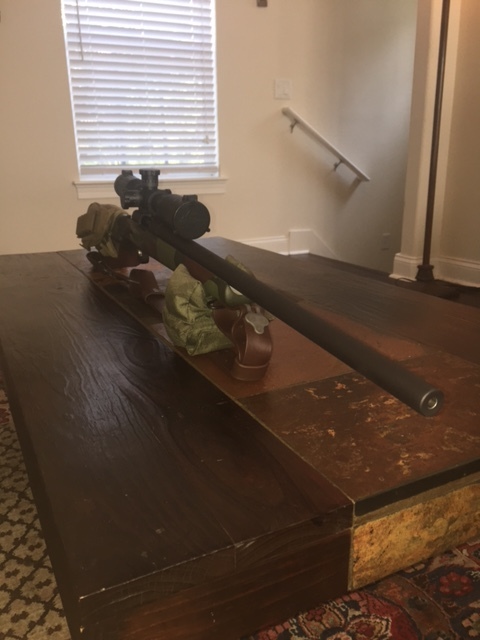

I received and put together my M40a1 inspired project. It's designed to (a) be a decent shooter (b) not break the bank and (c) follow the aesthetics of the M40a1, while not being a true copy by any stretch.
It's a Remington 700 5r "Milspec" with Varmint contour, cerakoted by Yeti Firearms. For now it has the stock X-Pro trigger, but will probably upgrade to a Timney if the X-Pro proves inadequate.
McMillan M40a1 stock with BDL inlet. Stock bottom metal for now. May use heavy duty PTG or something else down the road.
SWFA SS 10x42 with MOA Reticle and MOA adjustments. Butler Creek scope caps. I was on fence of MilDot and MOA, but I tend to think more in "inches" and fine them more intuitive, as is the math for the rough IPHY formula for MOA range estimating. I have a Kenton Industries custom scope cap coming for 168 gr Federal Gold Medal Match and local (hot, low sea level) conditions. I also have the zero stop shims.
DNZ one piece rings and mount for now. This system makes a lot of sense to me and is well reviewed. It's probably the furthest off the mark appearance-wise from the original, and I may someday add IBA style one piece base rings. But for now it's in "shooting shape."
Turner AWS brown sling. I realize the original M40A1 was usually a lighter tan. I always thought it contrasted quite a bit, and I've seen them this dark or darker in some photographs after presumably being wet, dirty, covered in saddle soap, and all the rest after life in the field. The brown matches the brown in the forest mold stock almost perfectly.
One Tigris stock pack.
Anyway, off to the races.
All in this cost approximately $2,650 to date.

Nice job.
I have a spec M40A1 and what I call my M40A1ish.
I like my spec A1 for the appreciation you get for guys that used them. Its a great rifle....

Point being...Don't let your variance from historical accuracy bother you if it makes your rifle a better shooter.

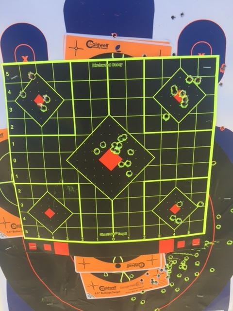

Sighted it in this weekend. Went to Tenoroc in Lakeland for the first time. Not a bad range at all (though only 100 yards).
Took a little while with adjustments to get on paper, but it (and I) shot OK, in the 1-1.5 MOA range. I have along way to go, of course. Also, the bolt was stiff and I learned all about greasing the cam surface in addition to lugs after I got home. Hope it's not a timing/headspace issue.
One of my biggest problems is just holding the center of the crosshairs on the center of the target. Breathing and movement seems to make it jump all around. Need to focus on shooting positions and squeeze technique. Also, while I didn't find the weight of the XPro trigger a major problem, I didn't like how smooth and slippery it was relative to the old ribbed style. I ordered a Timney.

Nothing wrong with that for first time out. A lot depends on ammo, if you don't reload FGMM should work well. Are you shooting off bags front and back? A good solid bag rest will help steady the cross hairs. I like to have my front bag closer to the mag well than the fore end. If the trigger was an issue for you you are probably going to get good return on investment with your new one.
Keep shooting!
Just a front bag. I'll need to experiment with rear bag a bit. I've never used one before.
Thanks!
You will like it, it really helps steady the gun.
Fill a sock, preferably one of your friends clean ones, fill it with sand and give it a try, Lock the gun in your shoulder pocket, squeeze or unsqueeze the sock to adjust your elevation.
No need to spend big money trying it out.
I really like this build - simple, functional, sleek. Of course though, I'm biased...
Sling: Yep, they didn't stay bright for long, I used saddle soap on mine whenever I would get a brand new one, and a lot of other guys would darken them up with cammie paint or whatever too. A bright ass sling in an FFP is a bad thing.
Trigger: I don't blame you for wanting the grooved trigger shoe, I really don't like smooth outside of (some) handguns or shotguns either. Timneys are good, especially for the money, but there's many out there that will work. To stay in the spirit of the M40A1-esque build, I would at least stick with a black curved shoe.
Rear support: A sand sock like pmclaine is talking about is perfect, although I gravitated away from those on the M40A1 for most usage outside of long strings of 100yd groups as they're slow and I'm not in the prone a whole lot anyhow. Other common (and cheap) fixes are dry beans or rice in a sock, poly pellets from the WalMart craft section in the same for real lightweight, or what I mostly use is a rag in my fist for the non-firing hand while grasping the rear sling, started shooting that way not long after I graduated school and haven't gone back since on that gun. I'm always needing the rag for wiping sweat off my head anyhow, nice to have it handy that way.
Scope: I'm a big fan of the rear focus classic SWFA SS models, hard to beat for the money, and it will serve you well. I'd only upgrade if I came across an ERGO equipped used USO ST-10 or S&B 10x PMII for a good price. I like the Weaver T-10 (especially if old US built), but lack of anything other than a basic reticle leaves me wanting more.
Employment: Relax behind the rifle, gain a good prone position directly inline with the barrel, keep it snug in the pocket, get the parallax out of the reticle, and go easy on the trigger. Did you bed the action into the stock? If not, that could be part of the issue. Otherwise, try running some 175gr FGMM through it, that's a well known favorite in those 5R actions.
Nicely done rifle though, hope it's a true shooter for you once everything settles in.

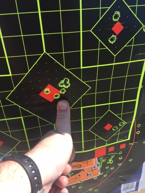

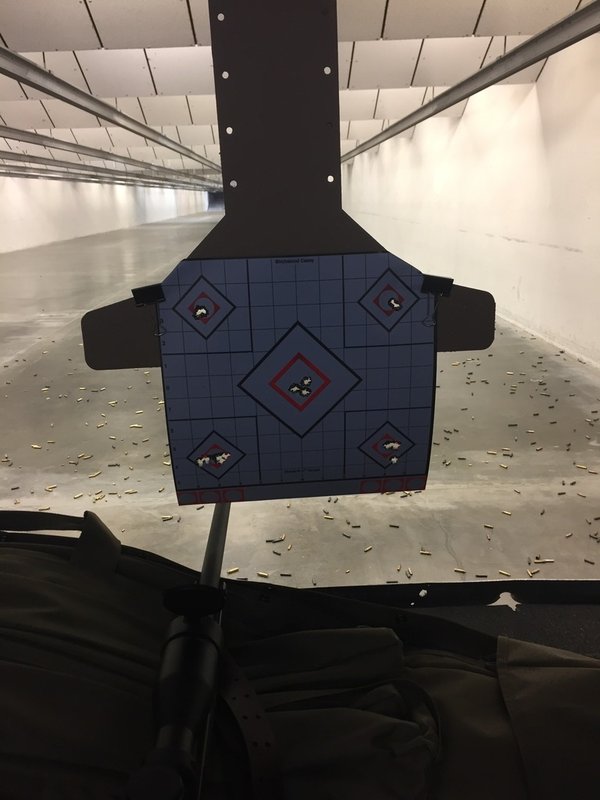

Took it out again (this time at Shooter's World in Tampa).
I also added the Kenton Industries BDC knobs. Note that these knobs sit higher on the SWFA optic than the OEM knobs. Whereas the OEM appeared to sit at three revolutions from the bottom, this appears at 7, even though it's zeroed either way.
In addition, I had the Timney Thin 510 Trigger added as well. Not a dramatically different trigger pull, but lighter, and ribbed, unlike the smooth OEM trigger. It was marginally better than stock.
I did experiment with the "rear bag," and the change from that was dramatic. Best group was about .5", three in one hole, at upper left. Upper right is just two shots.

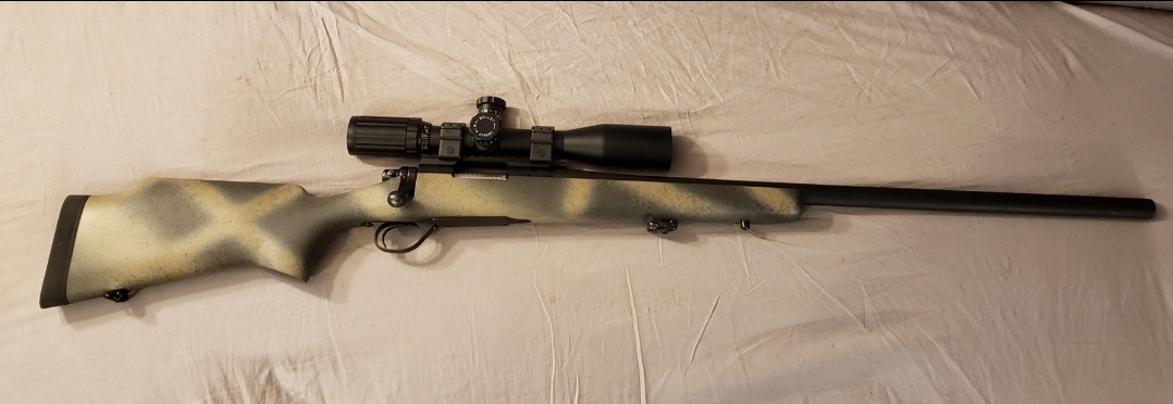

Always a fan of DIY M40A1's that aren't butchered. Very nice build! Been working on one myself with the new Grayboe Terrain stock and SWFA 10x SS. Used badger base and rings just for that extra rigidity.
