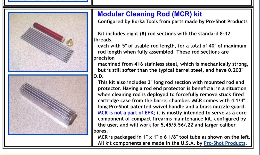

Isn't Borka the entire kit with the pro-shot?
You are correct. The rods are made by pro shot but he assembles his kit
Has anyone been able to prder just the cleaning rod from Borka? The website says that it is not available for sale separately. I ordered 2 different torque wrenches and didnt add the cleanign rod. Idk what I was thinking.
Yes, Pro-Shot is our exclusive supplier for stainless steel cleaning rod sections of a specific length and other components of the MCR kit. Pro-Shot modular cleaning rods are very high quality, and made in the U.S.A. Borka MCR (Modular Cleaning Rod) kit allows to configure the cleaning rod length from 5" to 40", which works for all handguns and just about any long guns.
http://www.shooterstools.com/Pages/ATD/atdkits.html#MCRinfo
Boris
Borka Tools
