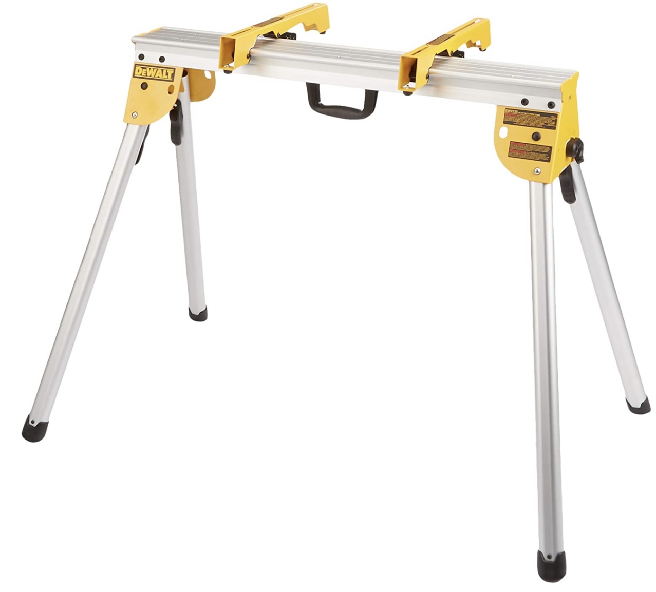

If you would go the DIY sawhorse route, the aluminum Dewalt folding sawhorse is lighter then that stout Stablemate I linked to above. And you could use the saw brackets (included, but can buy without) to attach to a piece of plywood.
The quick-release top would allow for splitting the package if you have two people carrying.
Has a handle too. I own these; they are very good. Haven’t made a shooting table, though.

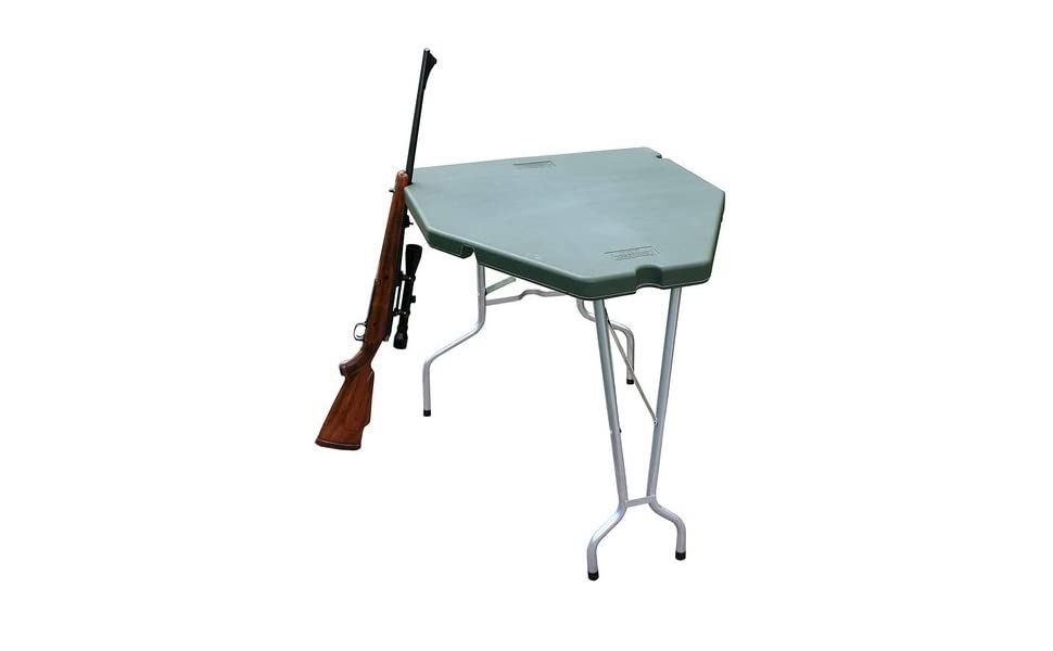

Re: plastic
If you go plastic, do not buy this: https://mtmcase-gard.com/products/predator-shooting-table-portable-benchrest
Seems good, but is too light. I own it and it is used as a cleaning table, stuck in a tiny storeroom.

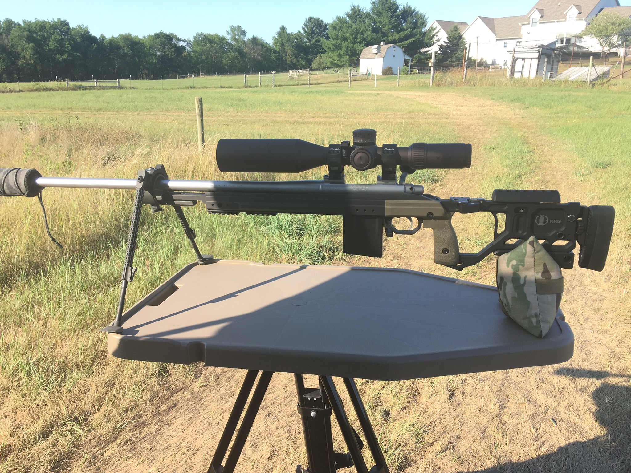

This below, by the same company, is better. It’s fairly solid, but nothing like a picnic table or range bench. Or, for that matter, is it quite as solid as my rotating bench (linked to above). But it IS light. I’d sell you mine but I don’t want to ship it.
The bottom setup was the most stable, but the sandbag is 14lbs.

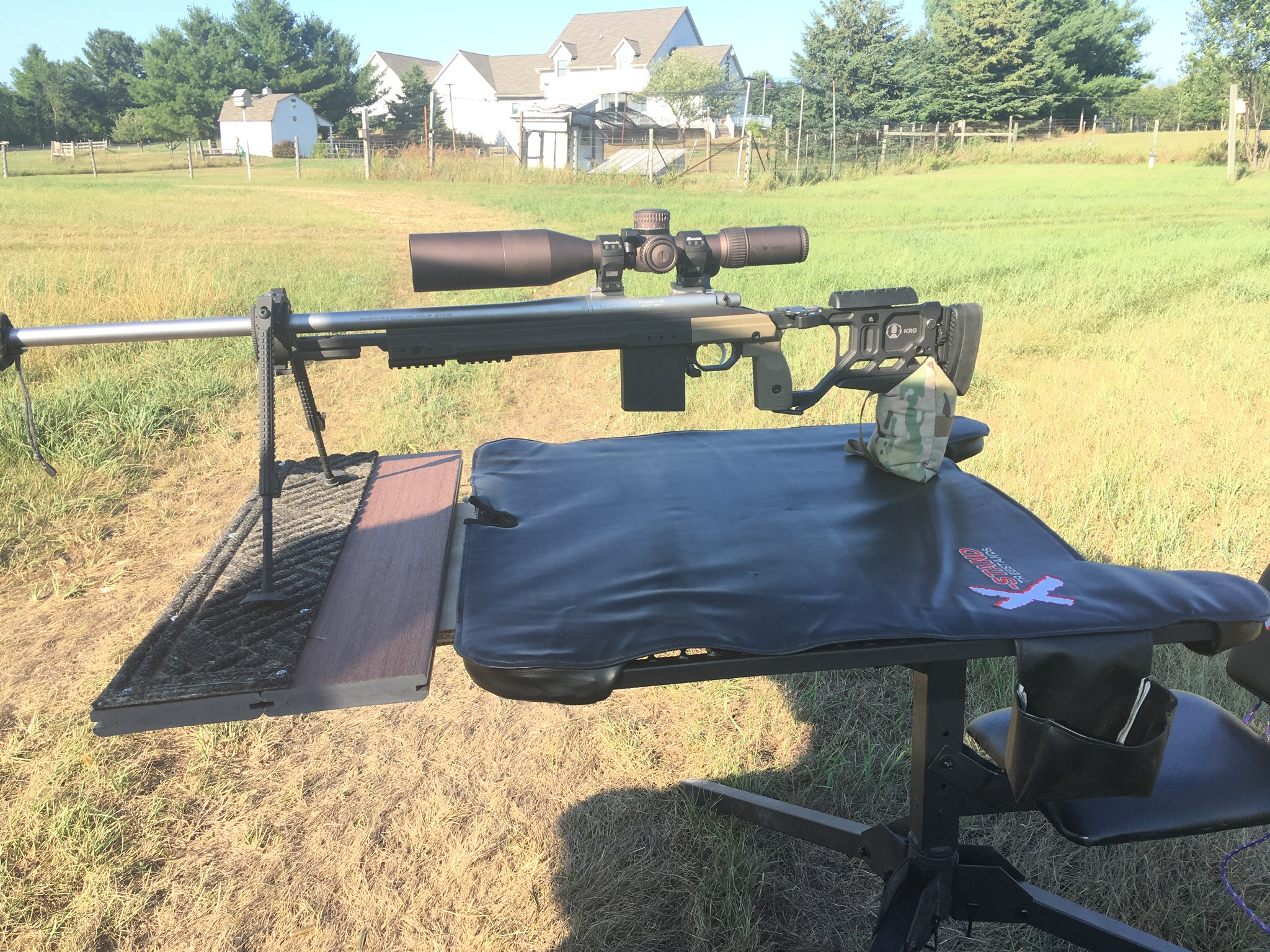

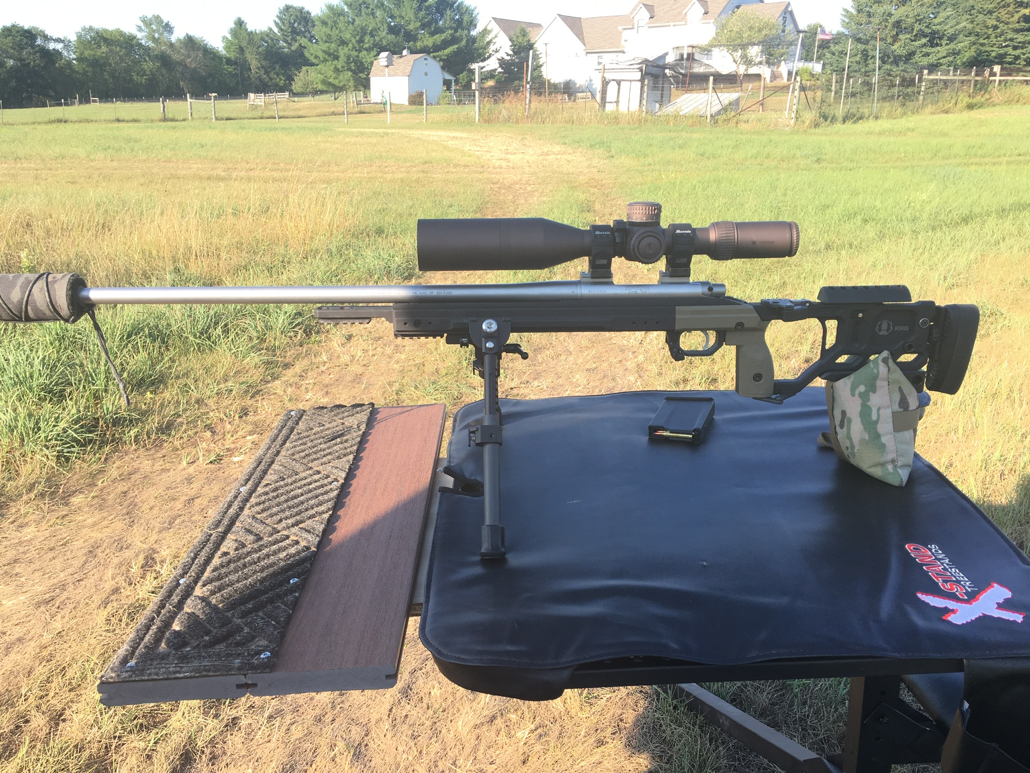

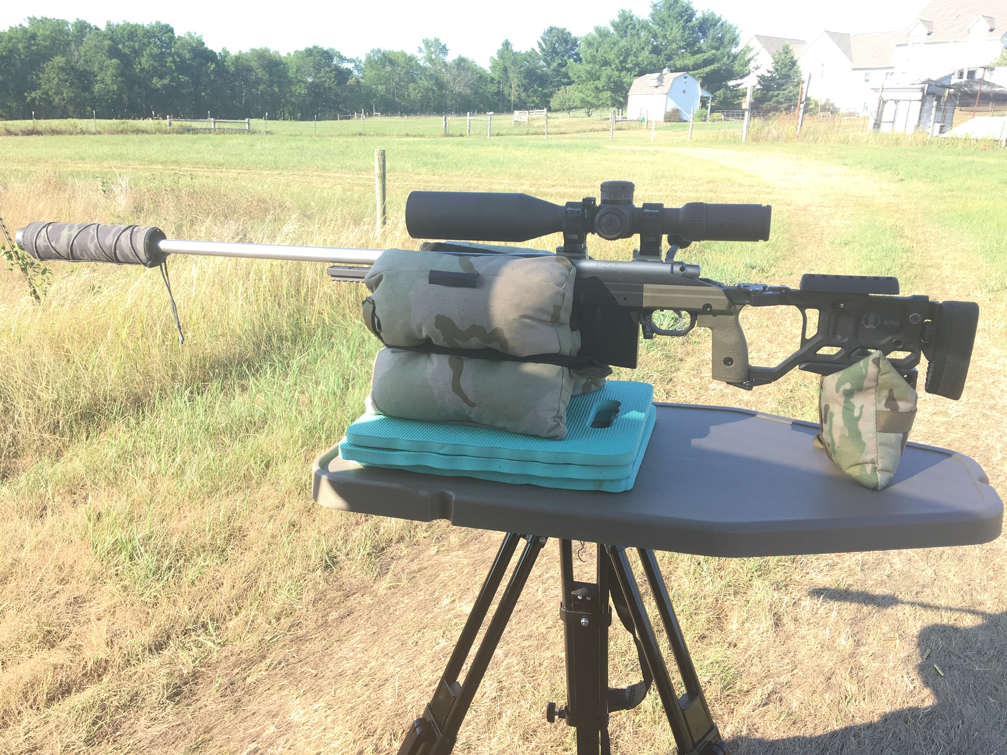

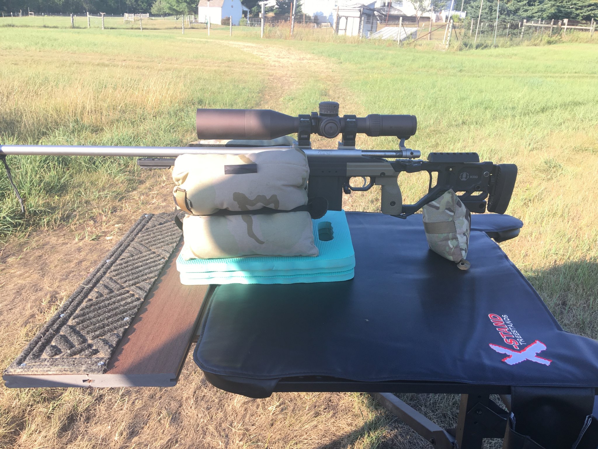

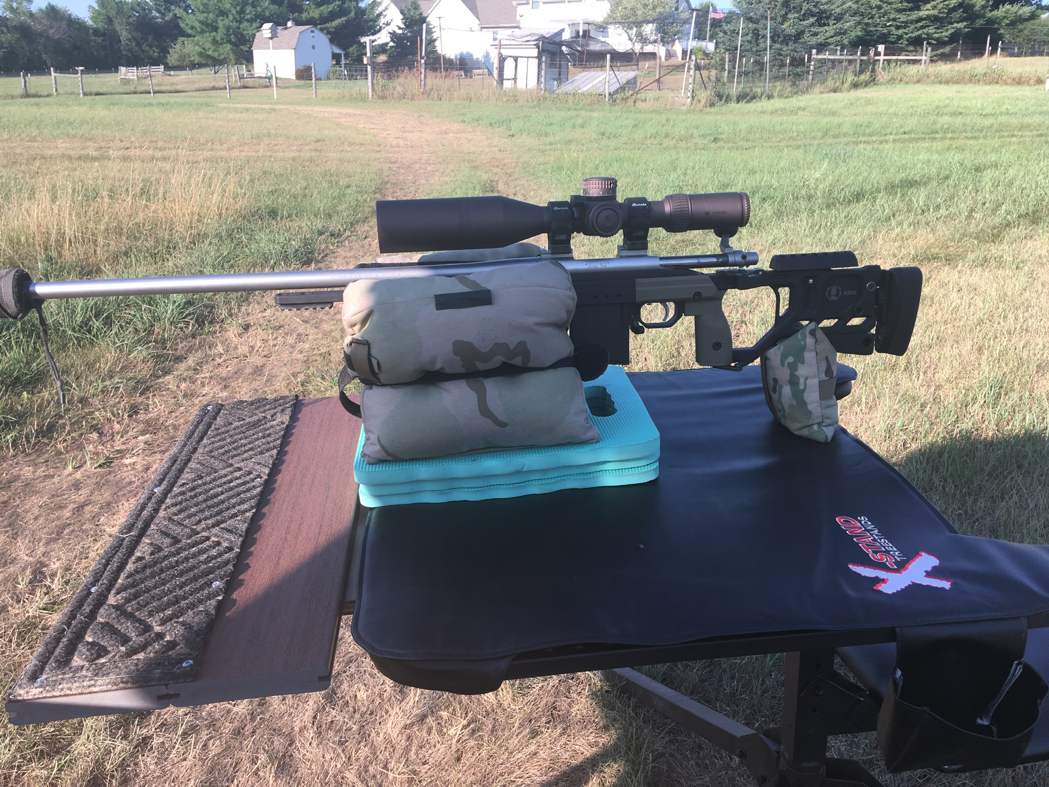

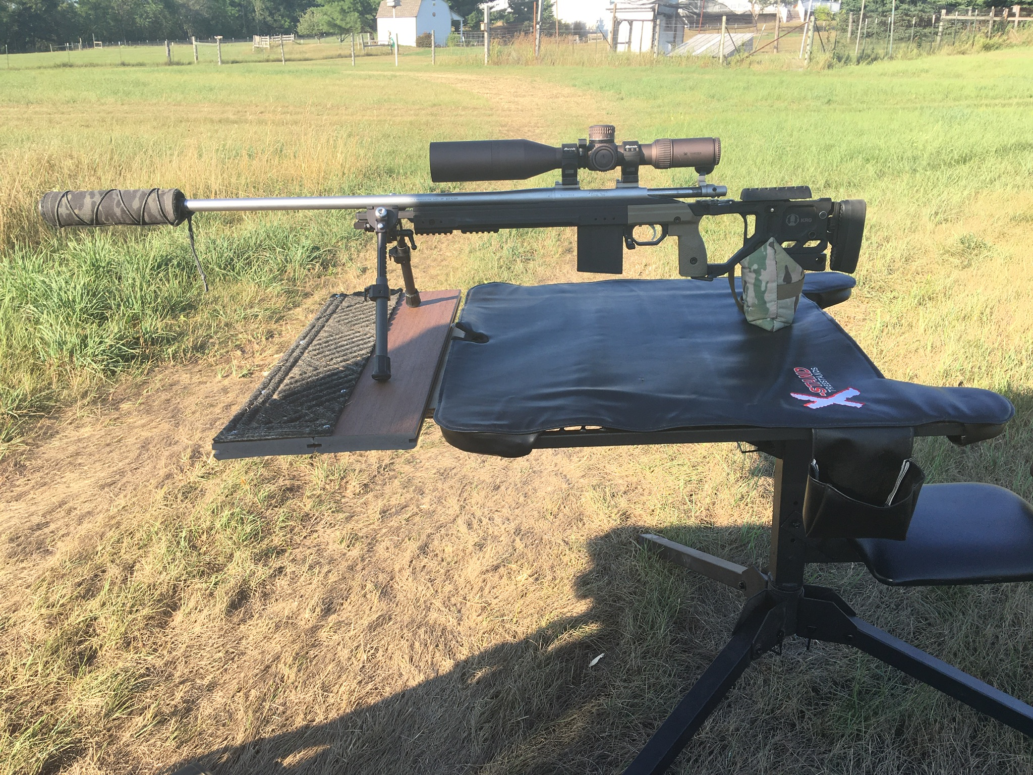

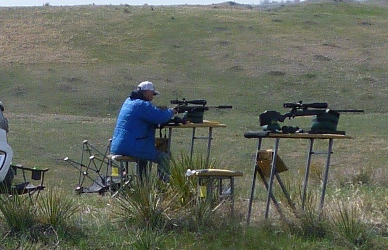

If you do get a commercial bench, plan on extending it. Here is my bench in a few configs:
I eventually landed upon using the sandbag with one board extension vs two in the pic. With my bench, I found that weight towards the rear made for less slop. Shooting downhill doesn’t work (too much slop).
The sandbag’s weight is really the deciding factor between the bipod and it. It’s windy where I shoot, and weight matters a lot.

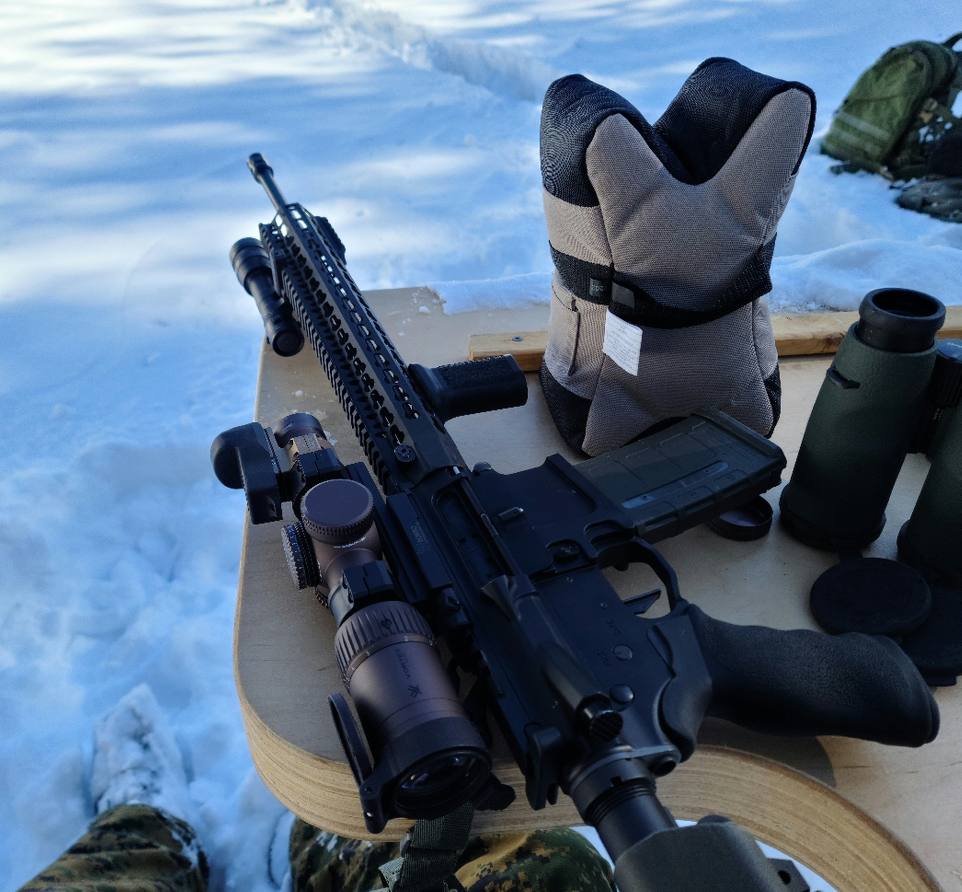

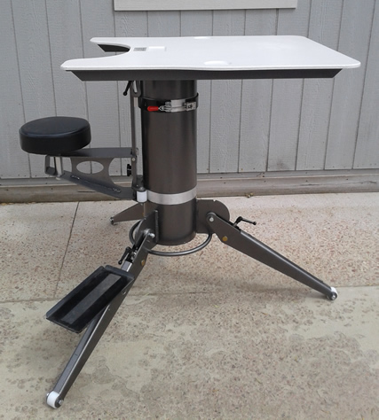

Here is a picture of me at a 1 MOA steel shoot . Here I am shooting Here is a picture at a 1 MOA steel shoot . Here I am shooting off my DOA table. Had it for about 5 years no complaints. Take less the 5 min to setup or take down. Very well built. I did win this match that day.

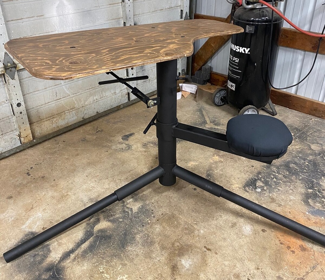

Is there any back and forth slop in that DOA? With the Caldwell BR-Pivot (another high-end rotating table) I know there is slop.
This one is the highest of the high-end rotating tables lol. $4300, 114 lbs. looks like the design was to mitigate slop.

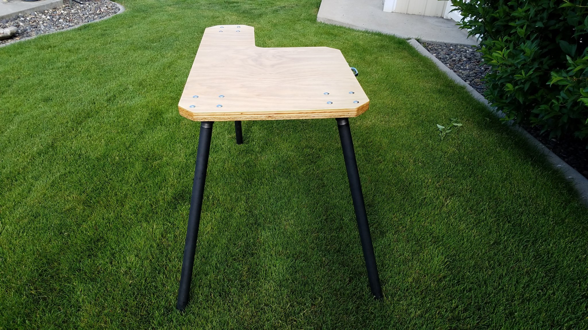

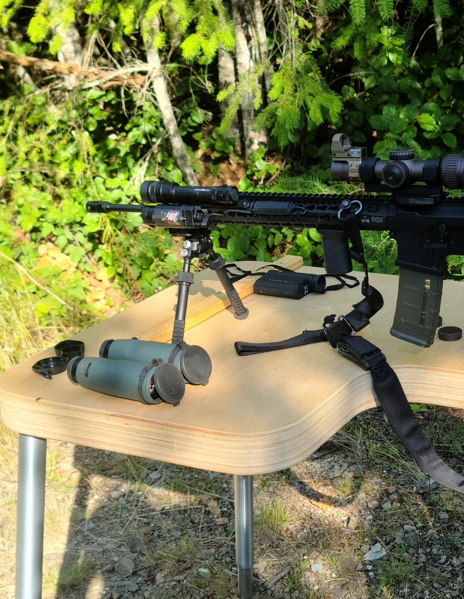

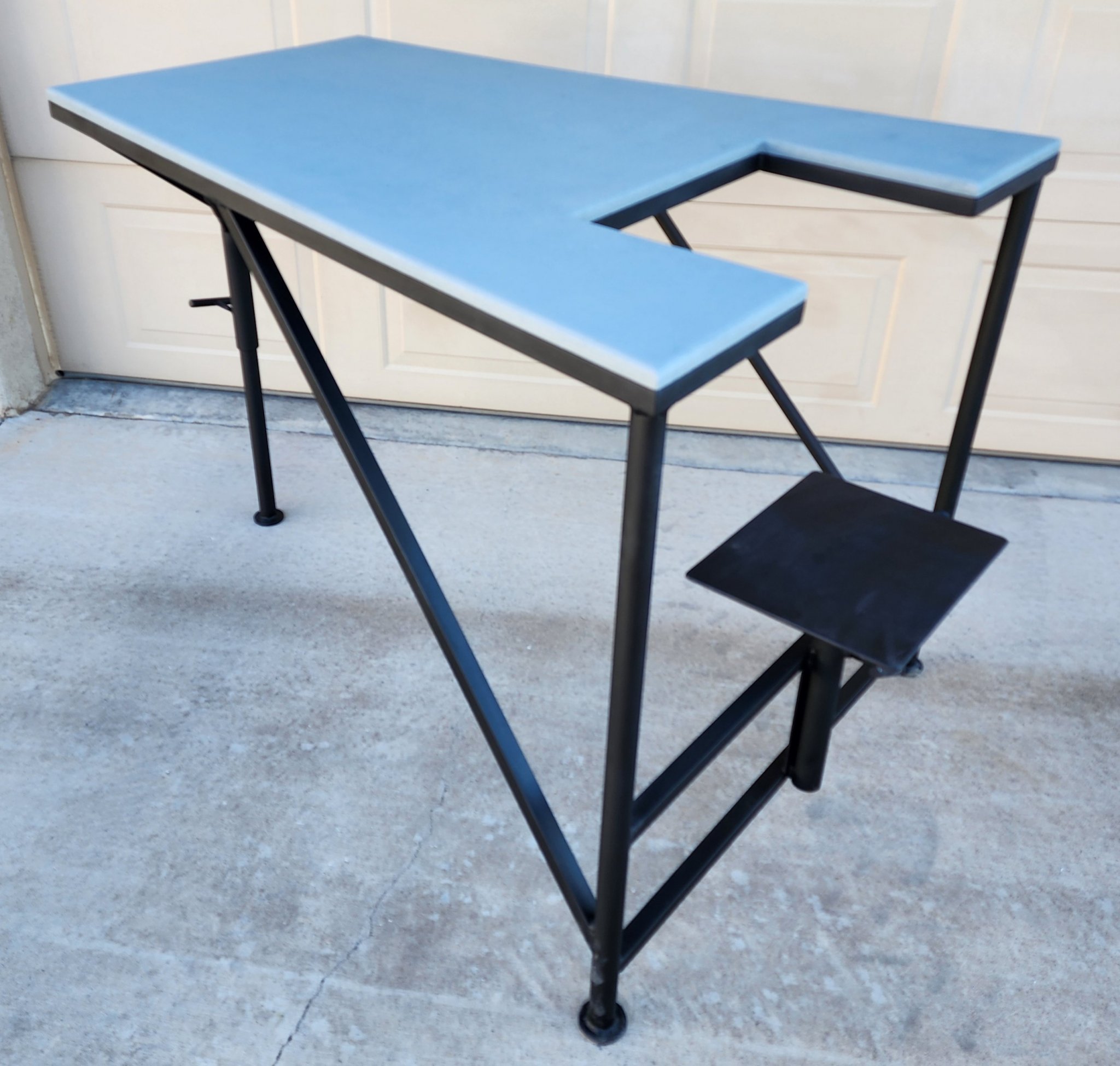

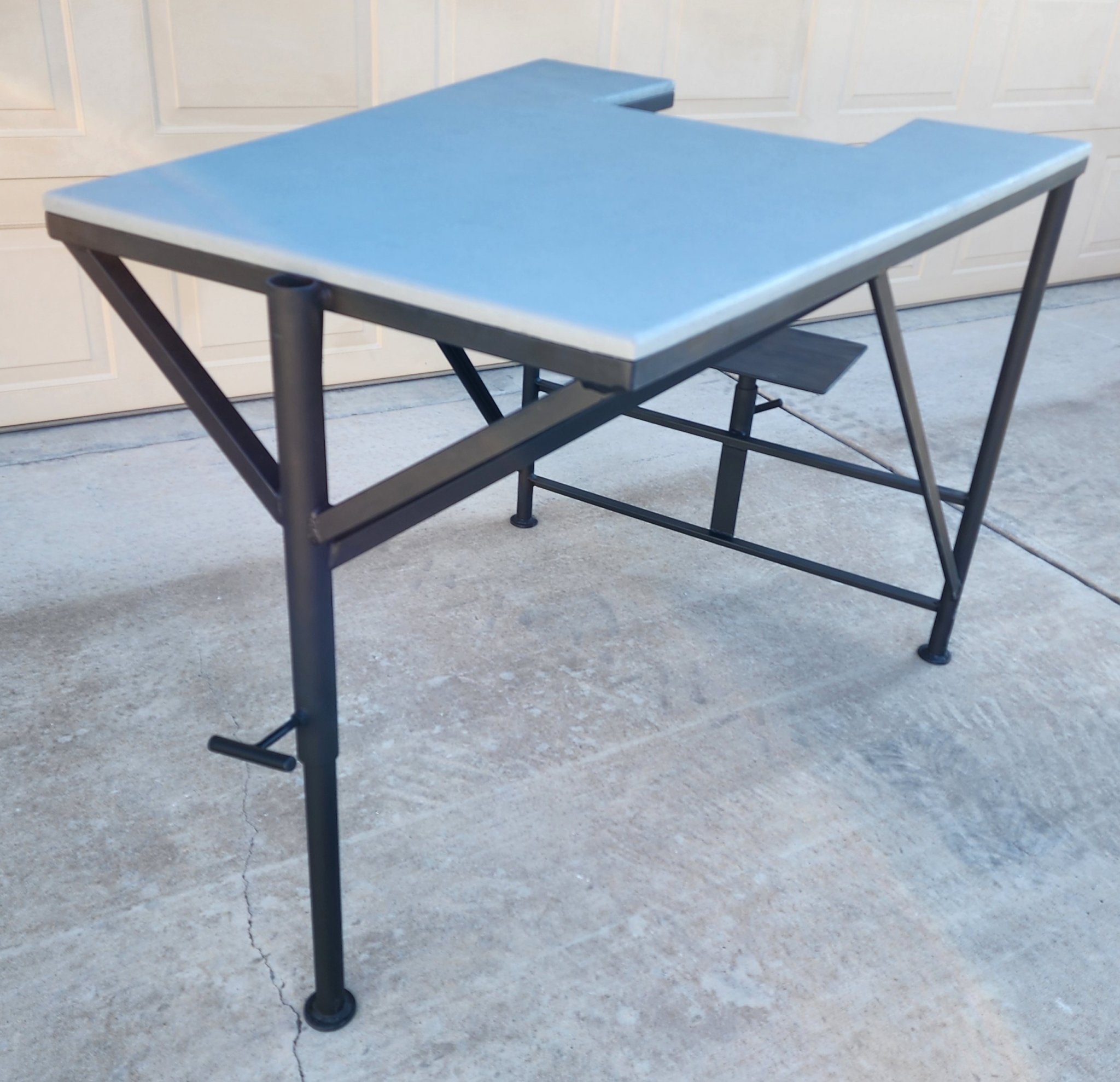

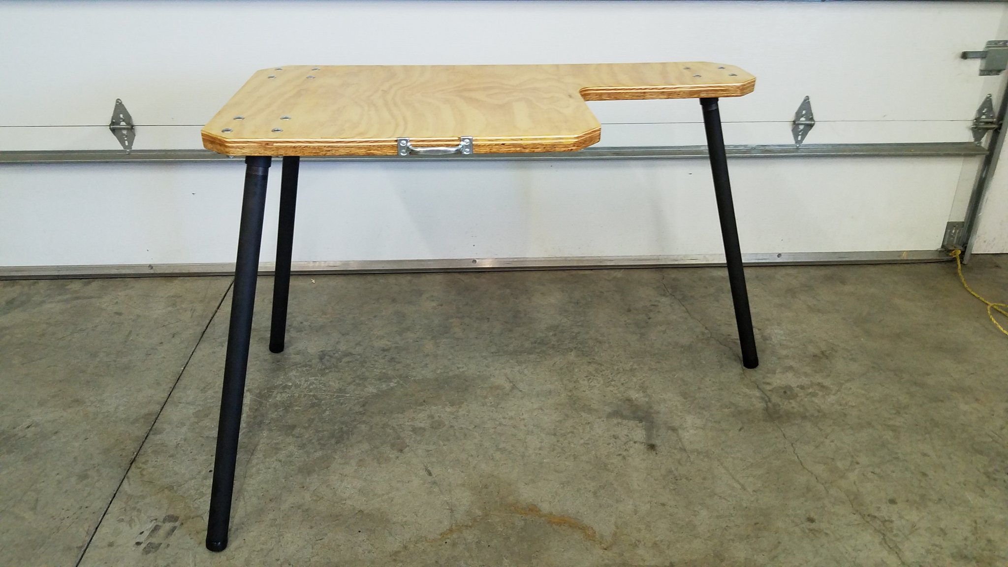

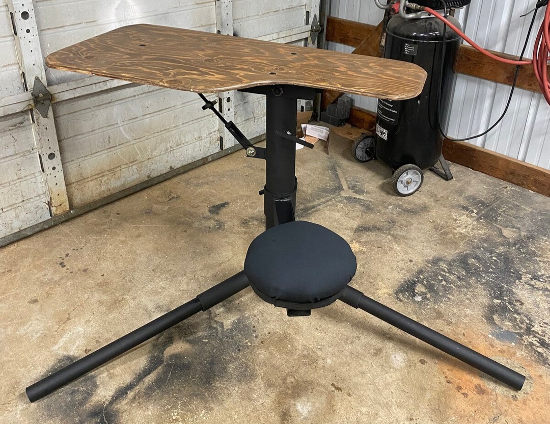

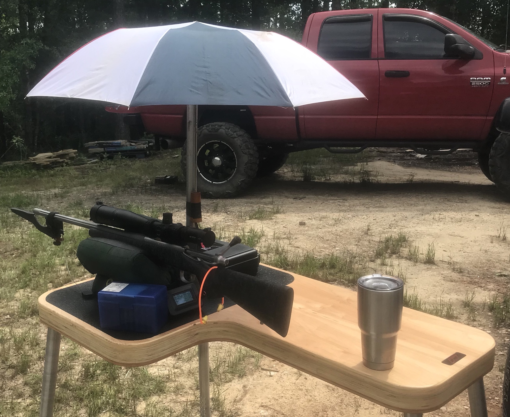

I will take a few pics of mine Thursday when I go shoot. About $225 bucks into with angled flanges from a guy off Accurate Shooter who has been making them for years. Super stable, easily transportable and super comfy. I have an old ratchet strap from a tree stand I leave on for a bipod contact point and have indoor/outdoor glued and stapled. Here's the basic setup, but mine has 4 legs:
View attachment 7939255View attachment 7939256
If you don’t mind sharing, who is the maker? PM is need be.
That is a reasonable cost vs $1500-$1800 for the Stukey table of the same sort of design (Stukey’s is 70 lbs!). I’m sure the Stukey is a little bit more stable with its triangle bracing underneath (and 70 lbs!), but I’ll bet yours is just fine.
How much does yours weigh?
I'll have to dig through and find a thread, but if you go on accurate shooter and look up a few terms like 'portable shooting table plans' or maybe 'angled flanges' it will pull up. I remember his name is Lonny super nice guy. I'd say the top is 20 it's double plywood glued and screwed. I take the legs off and transport separately takes about a minute to thread on.

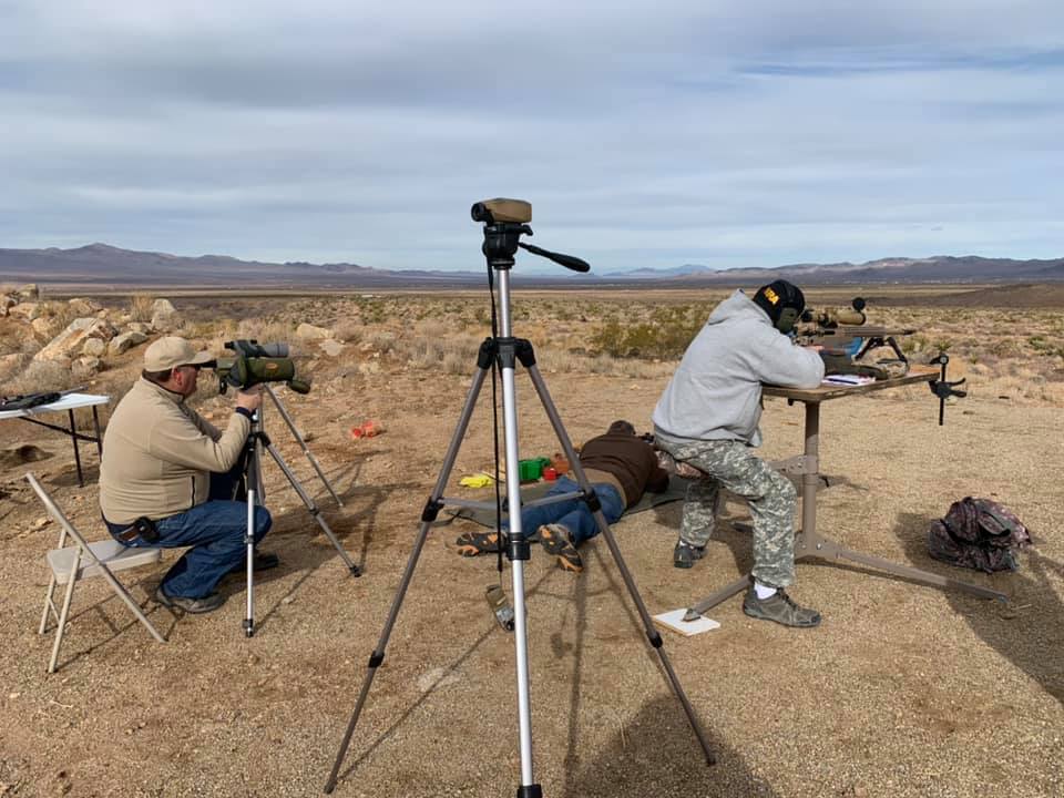

I didn’t see it mentions but have you considered a tripod. With a little practice shooting off a tripod can be incredibly accurate. It’s also much easier to carry and move and serves more purposes……. You could carry a folding camp chair and a tripod and be set.
A rrs tripod is in my future but want a table for wife, friends ect. I ordered up the legacy so we'll see how that goes.

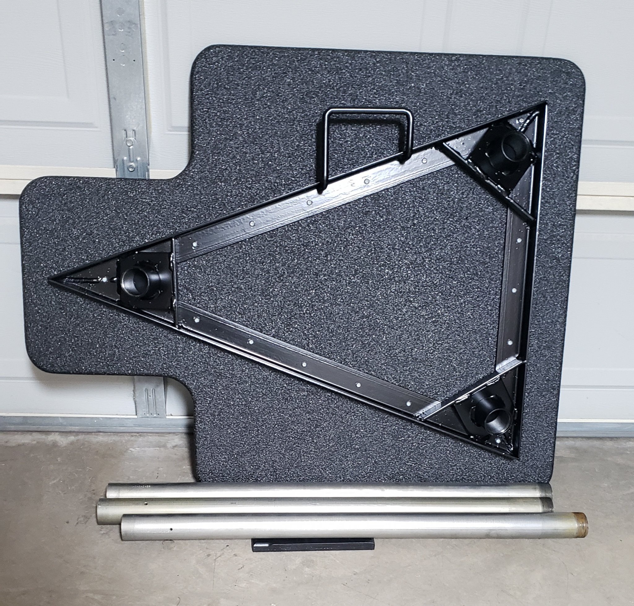

If you ordered the right-hand version, I’d suggest maybe changing your order to get this ambi version of the Legacy (still 45 lbs what the heck).
Why? When shooting from a bench, for accuracy Frank suggests squaring up to the bench and not getting sideways like most shooters get.
Plus, it’ll work for lefties too.
Link??

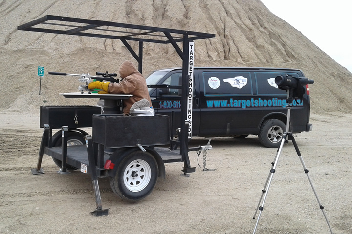

$16k in bench and trailer and then he uses a $20 super-pos tripod. I do like his bench, but it’s $4k and over 100lbs…Christ you need it bolted to a trailer just to make it practical.
And man, looks cold out in the photo. Look at his mittens.

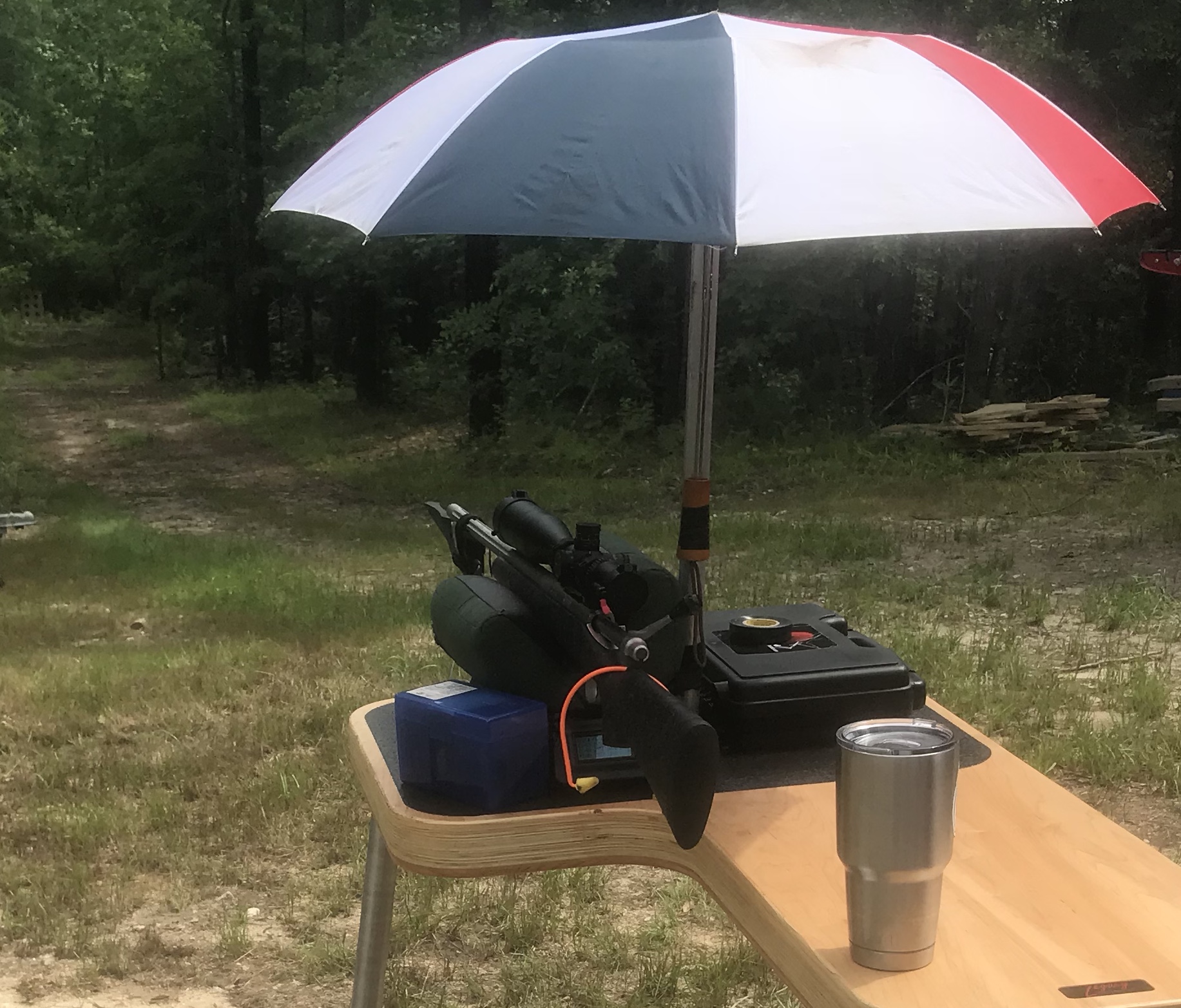

I found this guy. His handle at accurate shooter is Lonny in ID and he made me 4 brackets for $70 in 2022. He doesn’t (or didn’t) have a website but pointed me to this post for a glimpse at his work:
I need to now actually make the bench! The brackets seem high quality and are solid.
