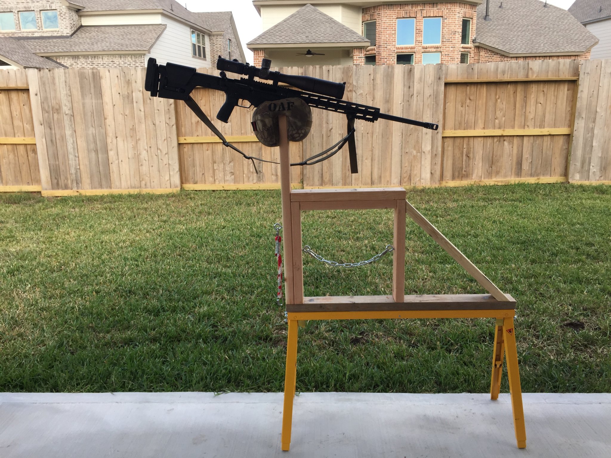

Lots of good advice and encouragement. Thank you all. I had the idea to build a barricade at home, so Def will use all those prop and dry fire ideas.
If you have a tripod just put an arca base on a 1x4 and you have a barricade of any height you want to practice on. A ladder works too. Building one is an option but unless it gets complicated it will only be one height.

The DFAT is the way to go. You can set it up inside or in the garage and shut the door and focus. And it's all about focus.
Specificity is the KEY. Have one thing that you work on until you get it right. Don't do anything else.
One prop. One position. One target. A low magnification on a DFAT on a 1 mil target. Until you perceive zero wobble and then zero movement when you press the trigger. Then add something - another position, or another target, or another prop. Raise the magnification to unhide wobble or issues you did not see before. Go to a smaller target. Then get that right. Then go on to other props and positions.
But., Master one prop first. In dry fire. Really master it. Master means getting off two perfect shots per position with no wobble in ten seconds or less per position with perfect economy of movement. Then take it to the range on a larger target at 400 yards.
For example - start with high standing on a ladder. Then add in the rest of the rungs going down until you are prone. Then reverse it up. until you can run that ladder in your sleep.
