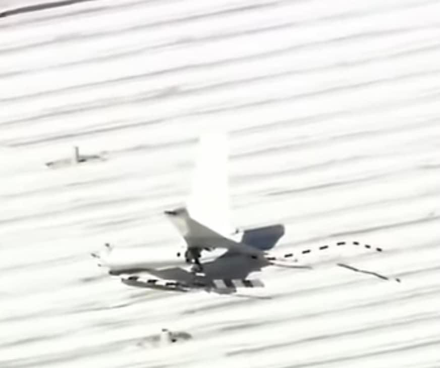

Dumb media cunt, it’s the vertical fin! It was trailing the aircraft in the video! Probably T/R failure? The fin broke off? But it wasn’t a M/R blade they were on until impact.
Yeah, tail rotor was definitely off doing it's own thing. The Robinsons have a semi-rigid rotor system (think see-saw) like older model Hueys or AH-1s. You HAVE to maintain positive Gs in them....UH and AH-1s needed a min of +0.5. Articulated systems on 3 or more bladed rotors can go as far down as -0.5g or less before getting into trouble.

Saw this posted in several FB groups I’m in, and it’s gut wrenching to watch. Possibly low-G for sure, folks had the FlightRadar24 data which seemed to show a few practice VRS recoveries prior to the tail departing. Maybe the student was excessively aggressive when applying forward cyclic during the recovery and hit low-G somehow, but that’s a lot of ham-fisted and incorrect cyclic movement to slip past a CFI, I’d think (hard forward to hit low-G, likely followed by hard left to (incorrectly) counter the right roll that would have developed). But if you slow the video down, the tailboom length is about right at the end of the rotor blade, so that’s a likely cause.
It could also be that the T/R and gearbox departed somehow prior to the vertical fin getting cut. That much weight on that long an arm could cause a sudden nose drop, leading to the aft portion of the boom getting cut off. Hard to tell in the video if the T/R and gearbox are still on the part that broke off. We had a UH-1/B205 go down back in AZ a few years back when the T/R and gearbox sheared off. It’s a significant CG shift, especially on a larger ship.

If you google R44 images a few pop up that look to be M/R strikes because aft tailboom is lopped off. I guessing auto rotation practice hard flair with hard impact. The aircraft in the search were still intact.
