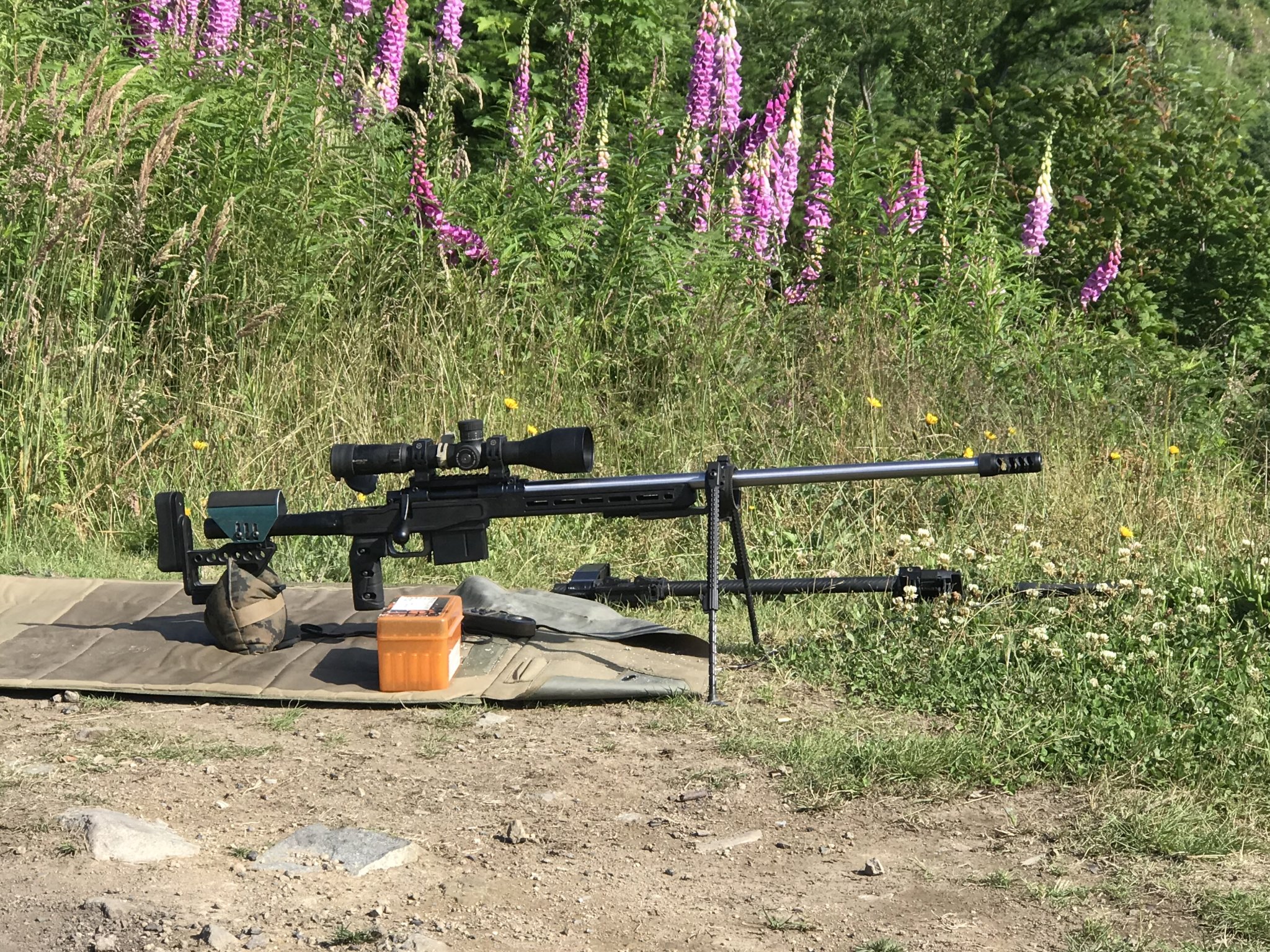

Assembled all the pieces myself, has been excellent out to 1.5 miles.
Personlly I wouldn’t bother trueing up a factory action unless it absolutely needed it and then I’d just consider a custom action.
I ve done 2 of them .if I can do anyone can
Both on bighorn orgin actions. One a shoulderd barrel, the other has a barrel nut .the shoulderd ond is easier, but the barrel nut is not bad either

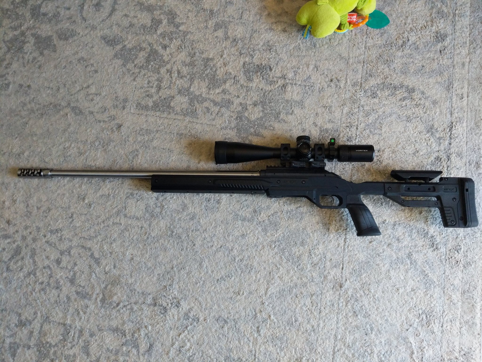

Or if you're on a tight budget like me, get a ruger american (one of the best bang for your buck bolt actions available), swap in a prefit, drop it in a chassis, and profit:
...and yes that's a Proof Research prefit barrel for a Ruger Precision on there :cool:
Also, you can easily swap stuff back if you ever want to use the factory barrel/stock for a lightweight hunting setup
