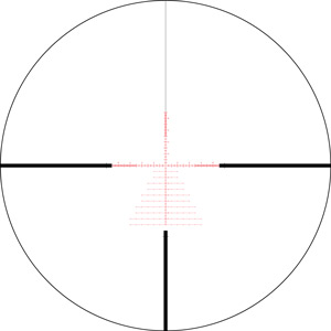

-I have purchased but am on a long back order for a 30mm Vortex PST Gen II 5-25x50 FFP (EBR-2C reticle) (reticle pictured)
--max elevation adjustment on this scope is 20MRAD

2) Does an elevation mount matter since I have the EBR-2C reticle and wont have to turn knobs to adjust?

2. Only you can decide if it matters. If you only ever shoot out to 1000m and have a decent load, you may be fine with a 0 MOA mount. Personally, I'd get a 20 MOA mount, but that's me. I shoot past 1000m on occasion and want the extra. If you think that you are going to hold always, even out to 1000m, power to you. I doubt it, but then stranger things are done.
