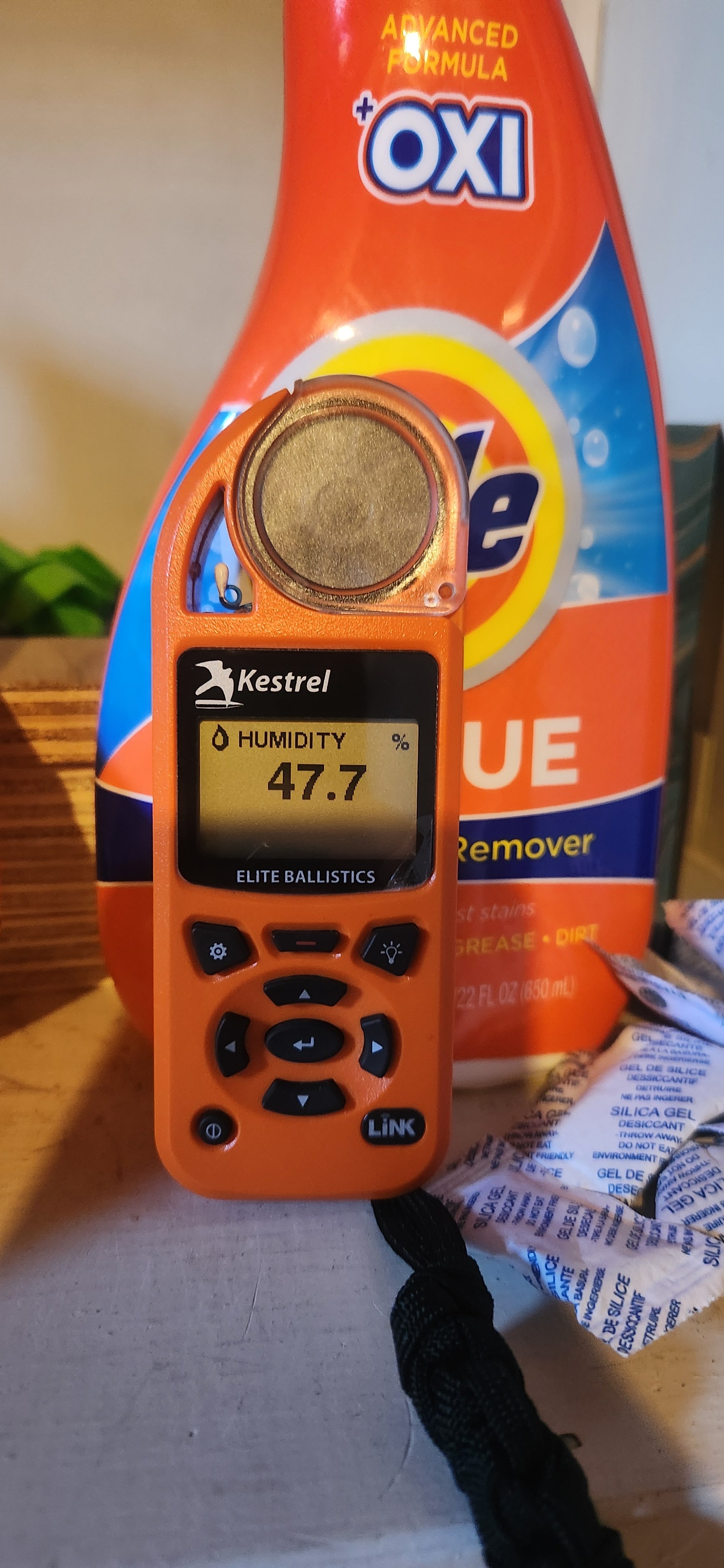

Luckily my basement is very dry. Averages around 45% RH in the summer, around 35% RH in the winter.
I keep one of the rechargeable EvaDry units in my safe and in the 18+ months I've been in this house, I've never had to recharge it once. Its not showing any absorbed moisture whatsoever. Back when I lived in VA I had to recharge it every 3-4 weeks.
I just want to pour this pad in the highly unlikely scenario I get some water in the basement, burst pipe, etc. Also, my insurance requires 6" stillage for anything below grade for coverage against flood/water damage. This is my forever home (I hope) so might as well do it right.

Make sure you control the humidity if it’s a damp environment. I put my safes in my basement this past year. I was surprised to see it as humid as it was 70-80%. My basement is dry with zero water issues whatsoever.
I now have canisters in my safes and a bigger dehumidifier along with another dehumidifier in the gun area itself.
My humidity is constantly monitored and stays 40-50% in the room and 35-40% in the safes
