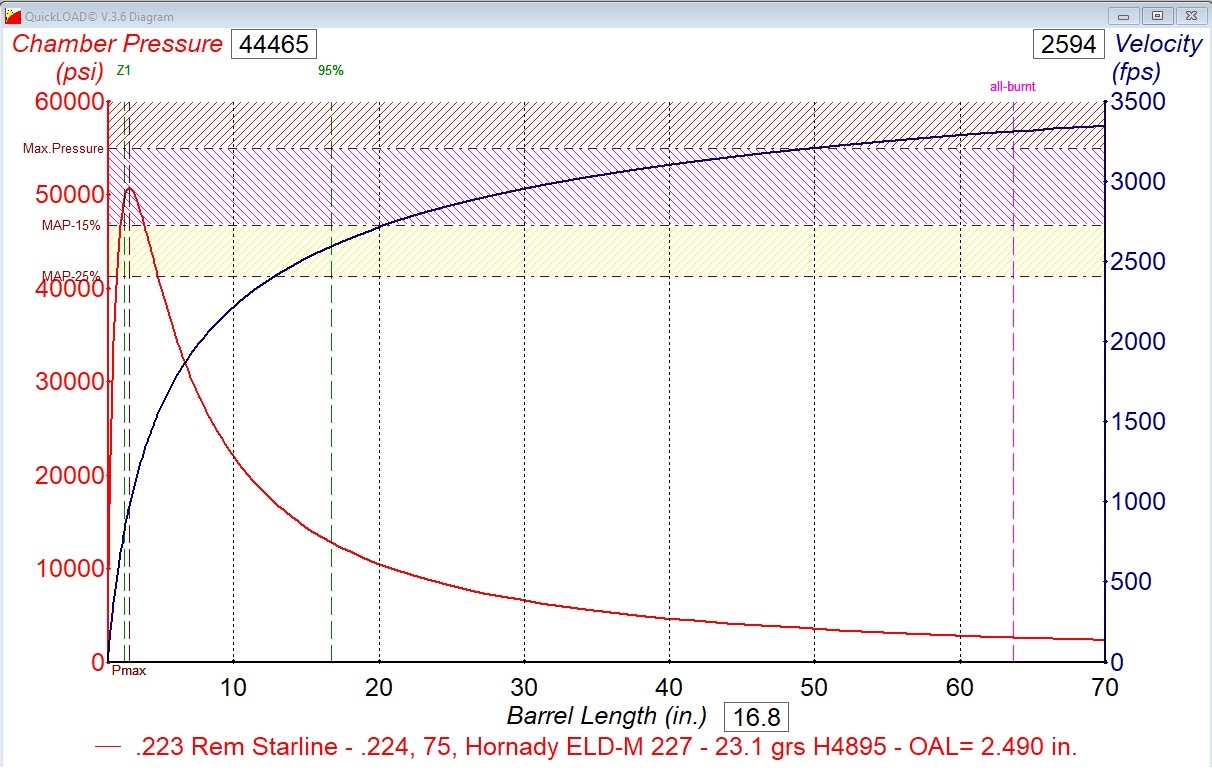

I'm trying to figure out if I am burning all my powder or if I can go longer barrel to burn more powder and get more speed.
Is there a way to tell?
Eh, the limited case capacity of a 223 won't gain much past 24". With the lighter bullets and quicker powder they fall off around 20".
There are many overbore and magnums that you can get quite a lot at 28"+, but a .223 isn't one of them.
dont know if this will help you, but here goes nothing (y)
Took my 75gr .223 example that I have in QL and set the barrel length to 70". You are 95% power burnt by 16.8" and does not hit 100% until 64". Will you gain speed over the 24"? Sure...but it becomes diminishing returns...

Only one person pointed you in the right direction and that is Quick Load. It requires a complex formula. You will need to post certain variables and we can print a chart. I have to work today but anybody with QL and a little spare time can help a brother out once with a QL question. Just send the chart via PM so QL doesn't send LL a complaint.
Also, please tell us you don't need this info because you think you don't want to waste 2% of powder. BTW, you're going to get more speed with a longer barrel regardless of powder % burned. Now that I think about it the powder burn is irrelevant. Nevertheless, QL is still the easiest way to estimate velocity and powder burn. Example, 24" vs 26". Like what is the most common longest barrel length? It certainly isn't 64".

What you and all the other idiots fixated on the length it takes for all powder to burn fail to understand is that the expanding gasses in the barrel continue to do work (work as defined in physics, force x distance....) on the bullet long after the burn is complete. That means the bullet continues to accelerate for quite some length past the point of complete burn.
Looking at the QL graph the slope of the velocity curve (AKA the rate of change of velocity over length) is nearly constant from 20 to 30 inches of barrel length. That correlates to an almost linear acceleration over those ten inches. I know, math is fucking hard...….
