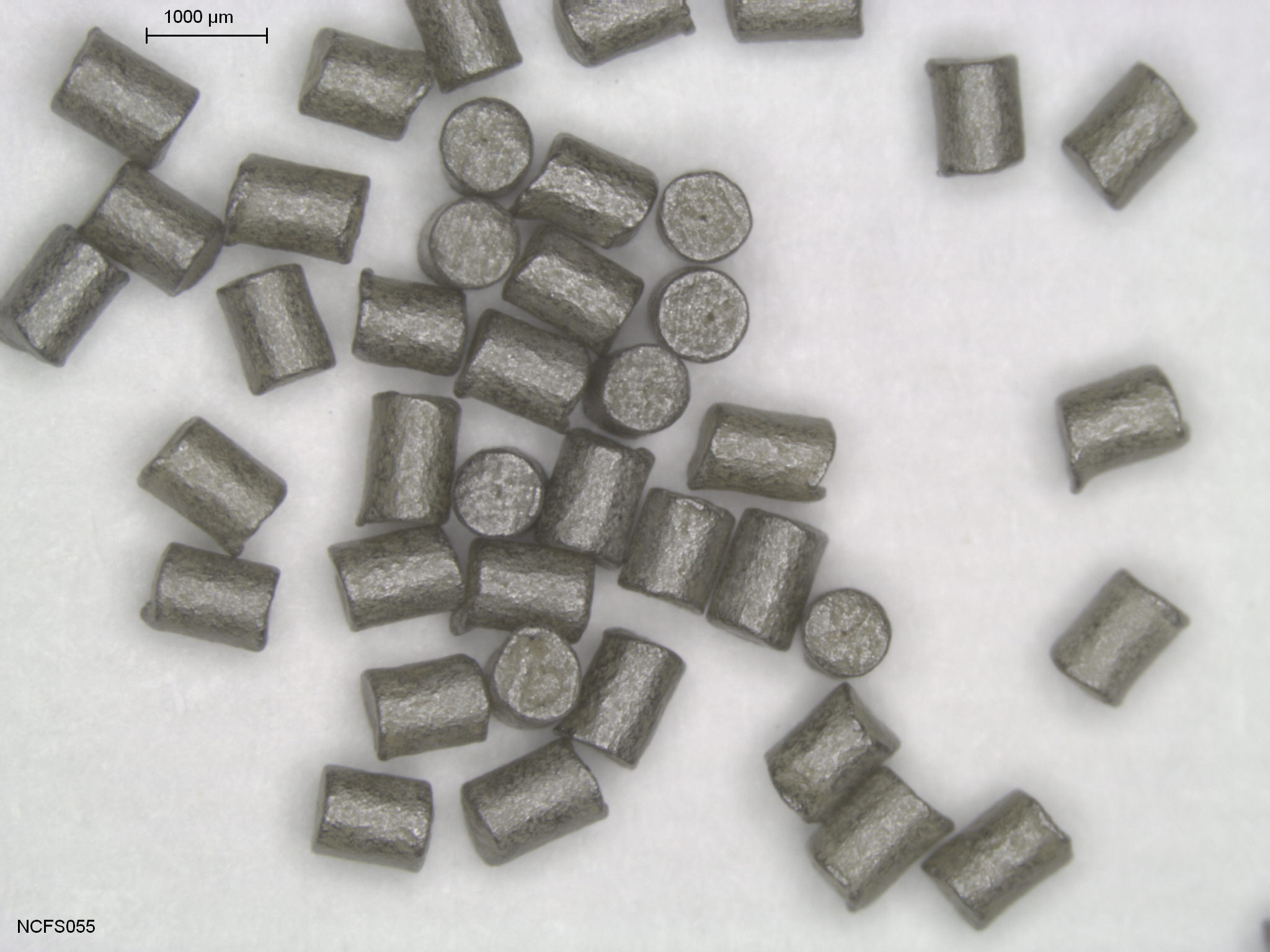

TAC is considered a ball powder, which when speaking in generalities is subject to all the ignition issues with ball powders.
It is double base, meters well in progressives and powder measures, and very easy to work with in load development, but.... you will want to test for primer sensitivity and cold weather ignition issues.

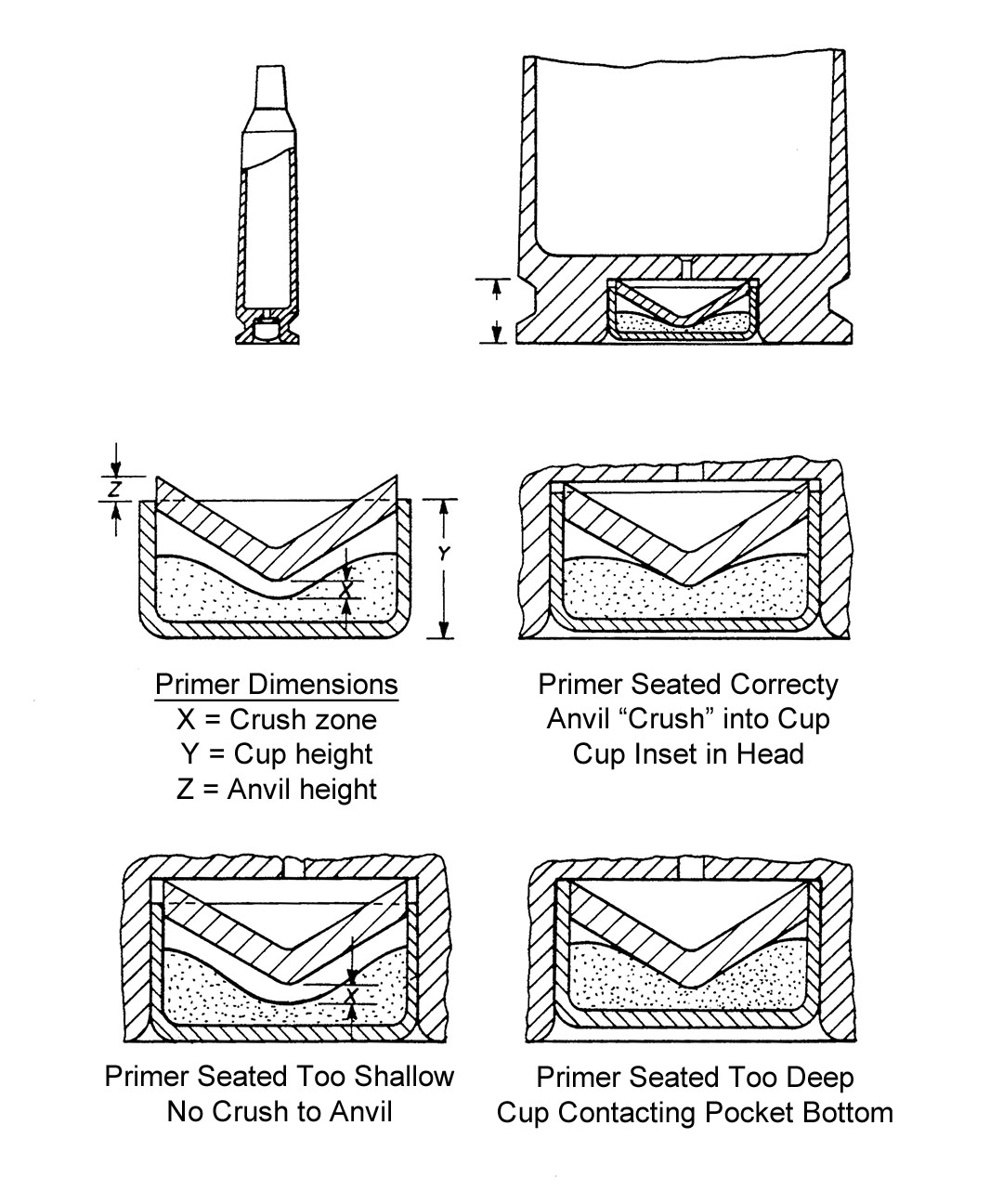

The primer seating depth?
Flush…hand primer
Primers should never be "flush".
They should be no less than touching the bottom of the primer pocket and then compressed.
The old terminology for that additional compression was "sensitized" but folks nowadays call that "crush" on the forums.
Try pushing those primers to where the anvils are forced in about 0.004" - 0.008" beyond touching.
Pocket depth tells us how deep the hole is. Primer overall height subtracted from pocket depth gives you a baseline value, then you go an additional 0.006" +/-0.002"
ETA: Example Let's suppose the primer pocket depth is 0.120" and the primers are 0.119"
0.120 - 0.119 = 0.001" to touch the bottom the primer is 0.001" below flush, then adding 0.006" crush your nominal should be roughly 0.007" below flush.

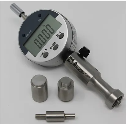

Primer "crush" isn't a direct measurement, it is a combination of tolerances and inspections.
As far as how to achieve good primer seating depth, it is done by two major steps.
The First.... is the math on your particular primer pocket depths and primers to determine the best seating depth.
The Second... is the inspection of the depth below the case head.
Neither of those steps has anything to do with a Primal Rights Seater.
Although that one works just fine, there are many primer seaters and it really doesn't matter which one you use as long as you use it to get intentional results by inspection of the installed depth.
If you have a typical caliper, you can just use the tailstock with a little dexterity and practice.
If you want to invest in your personal skills and toolset, I would recommend this one for it's simplicity and reliability.
https://bullettipping.com/products/precision-primer-gauge/
