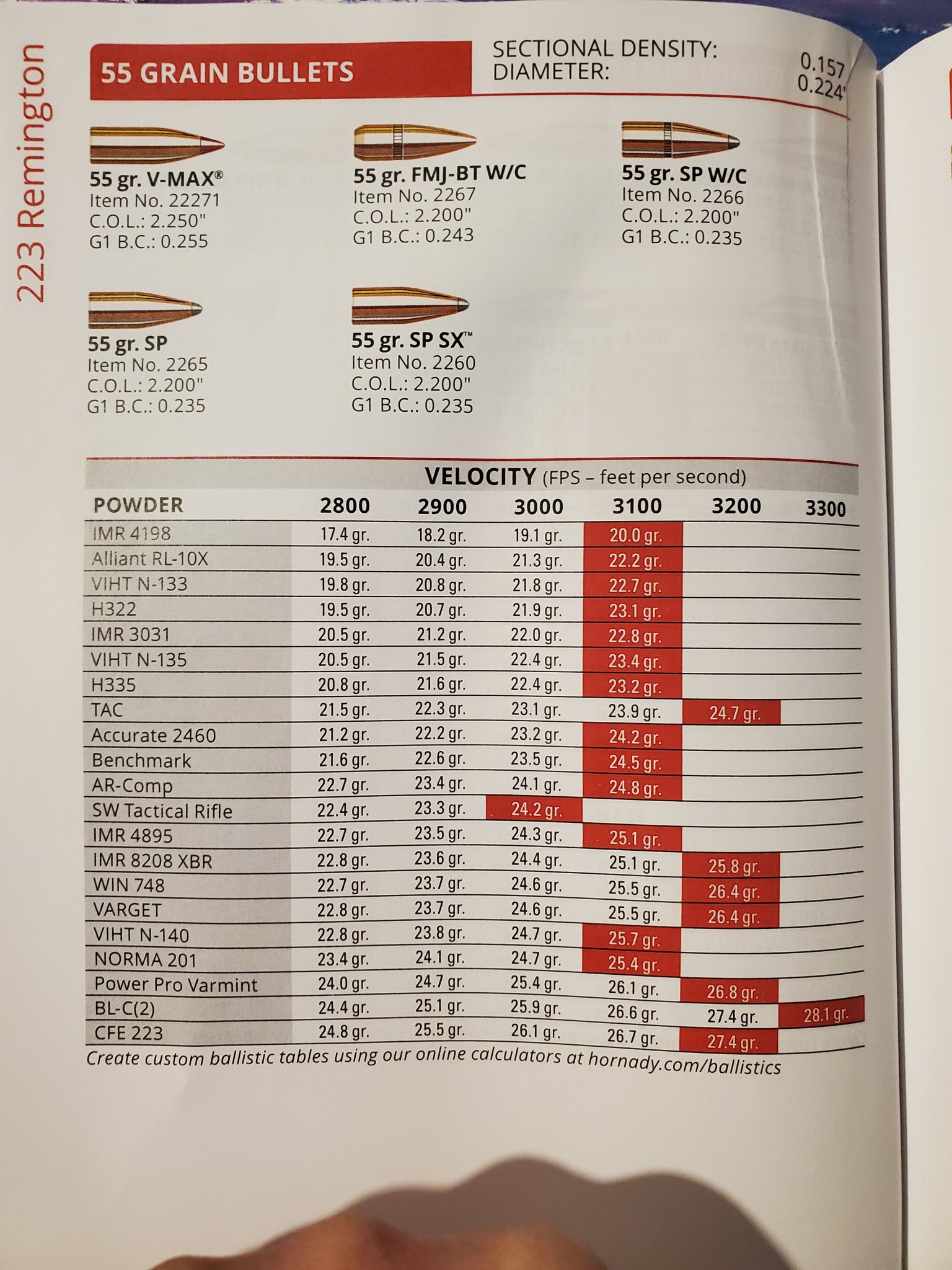

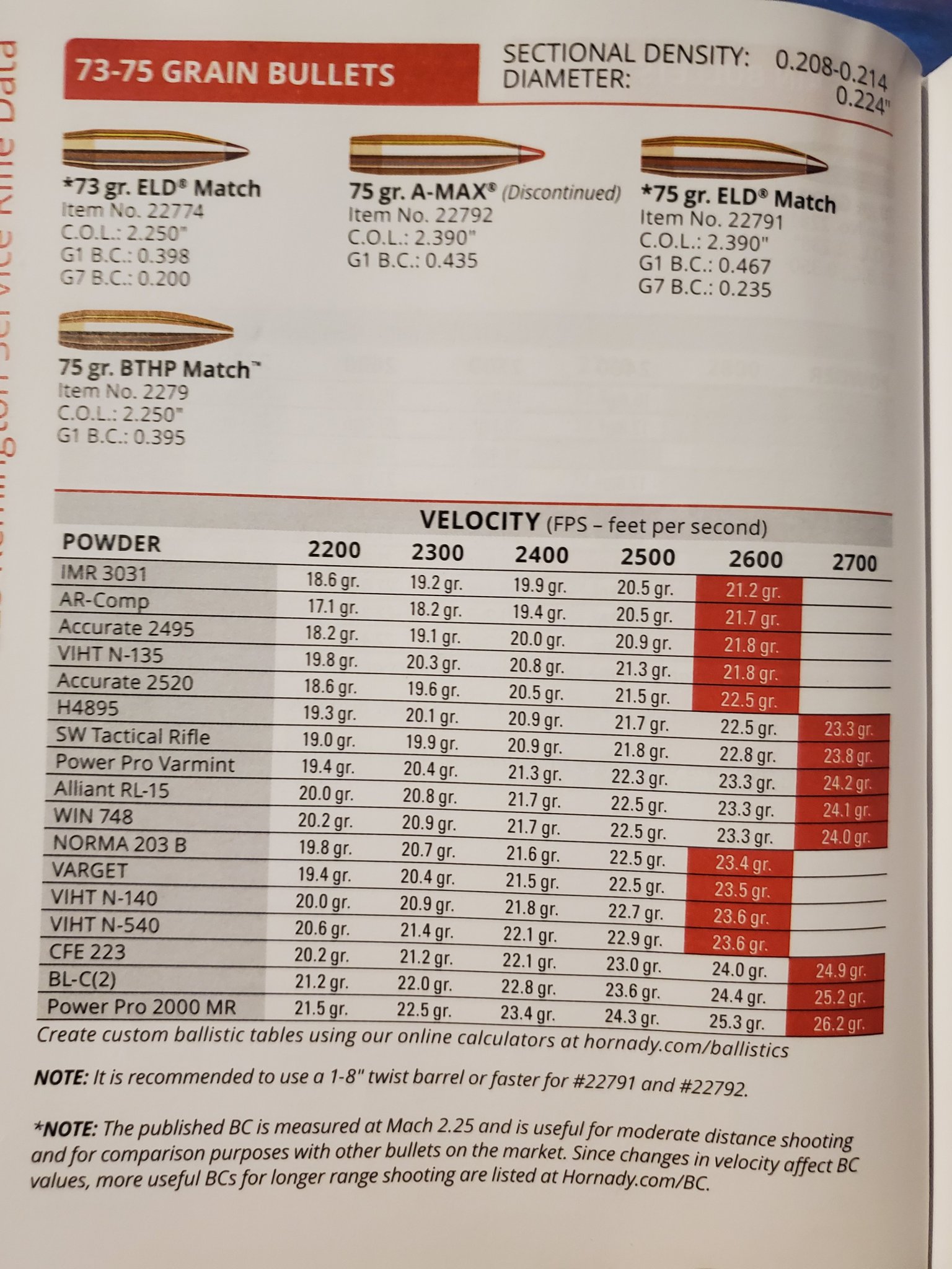

    Sorry if this has been beaten to death. I'm new to reloading. (Loading for first time next week.)
    I have 55 grain spire points and 73 grain eld-m for my 223. Its a stag varminter, 24" bull barrel. 8 twist.
    A friend of my has 2 pounds of ramshot tac that he's willing to sell. Been reading about it, and some don't seem to like it for smaller grain bullets? Is this true? If so what other powders would you suggest, that is in a perfect world we're I could actually find it for future reference. I'm trying to pull as much accuracy out of this as possible. Thanks.

    Tried looking at ramshot tac, maybe it's my phone, but it does not have a 223 rem as a selectable caliber. I'll try the laptop.
    Depends on the chamber. .223 or 5.56?
    The load data is really different. Then Hornady has a Service Rifle section. Sierra doesn’t list 5.56 data. So really like anything else in reloading. It varies.
