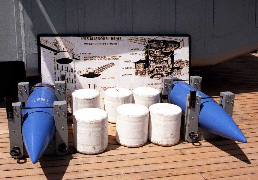

    Wonder what smokeless powder the 16" powder bags contained ?. I know they had 4.4 lb. black powder sewn in them for kicker ignition . Each powder bag weighed 55Kg. aka 110 lb. and #6 per load = 660 lb. charge 2101 lb. shell at 2900 fps. ,so muzzle energy would be 98,406 ft. tons . OUCH
