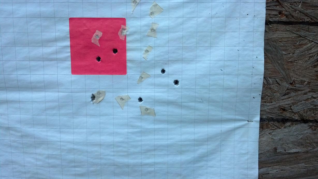

I have a remington 700 338 LM and have been working loads for it. It doesn't seem to like the heavier bullets but shoots the 250 Hornady match bullets real well with 92.3 grains H1000 the 3 shot group to the right was 2.88" at 500 yards. The group to the left was 3.66" with 92.4 grains of H1000 also 500 Yards. Both of these loads are in the 2800fps range. They were seated 30 thousandths off the lands.
