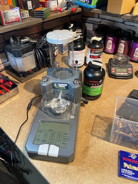

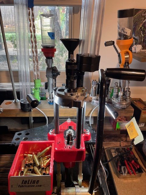

For my pistol rounds I use the lee powder measure but for precision loads I use the Frankford Arsenal perfect powder measure and
a powder through die in my turret press
Reactions: RegionRat

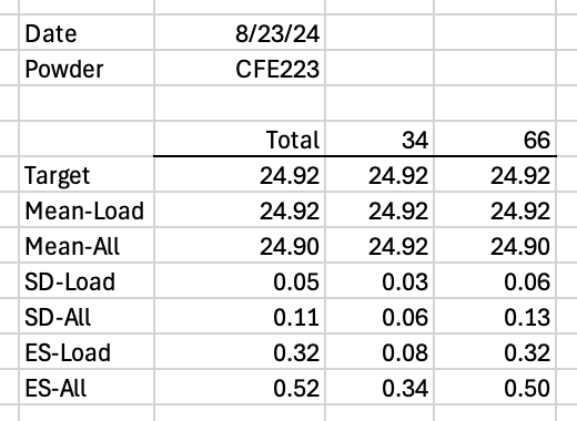

I recently loaded 50 rounds and tested my Harrells BR with CFE223 checking every throw on my FX-120i to see if I could just skip clearing out my ST in the future. I had to throw 100 charges & discard 50 to get 50 loaded rounds. I "double tapped" the lever up for the 34 column and "triple tapped" the 66 column, both produced 25 loaded rounds.
Obviously I wouldn't have known which to discard without the FX-120i, so the more precise "Load" numbers aren't representative. For <600 yards, the double tap is good enough for me. 1,000? I'd use the ST & a different powder.
