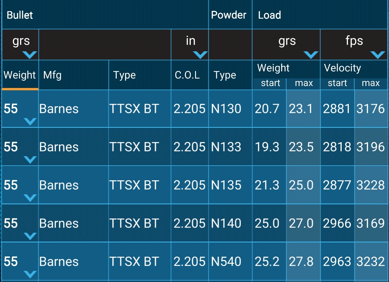

Looks like N530 is not shown for TTSX that I picked as example for CX. But 135 or 540 should be there.
