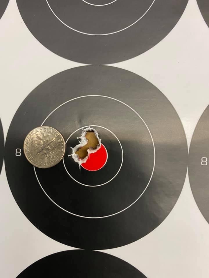

Thank you, I may end up going this route if I can find several lbs of h1000. What kinda of velocities are you getting with the 175?
2950 fps in a 26 inch barrel with 70.0 grains. The picture is a 5 shot group.

I ended up finding some Retumbo. I'm getting 3013 average on a 184.
Group is .6 ( iirc) shooting out the back of my truck haha. I'ma try it for a while.
