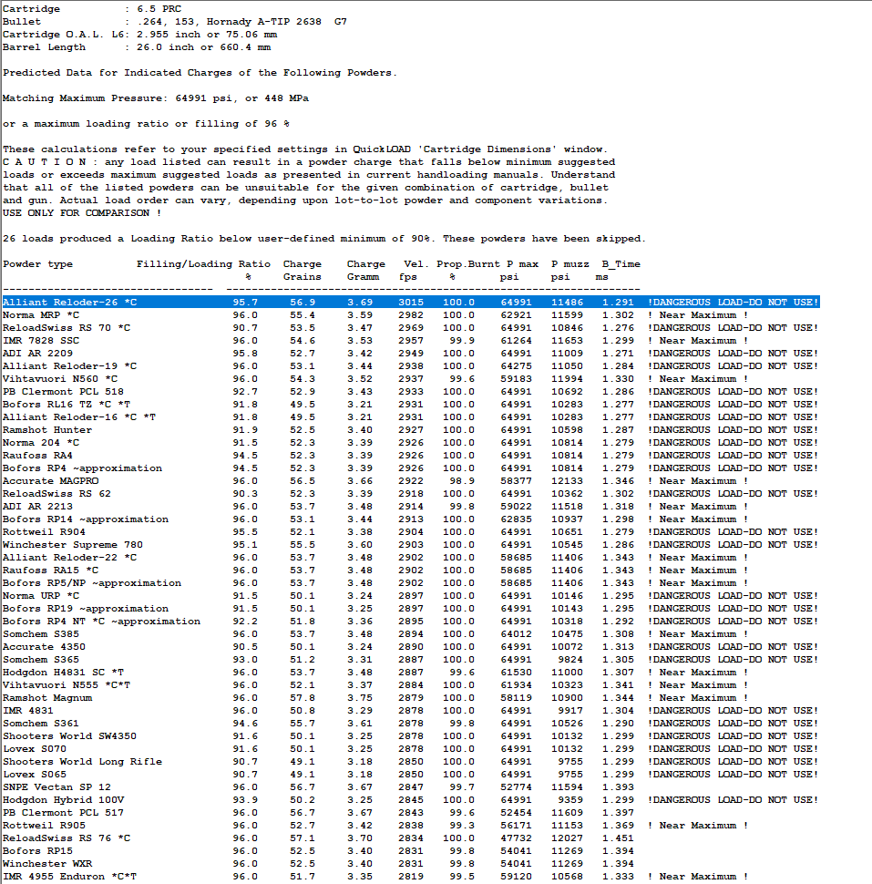

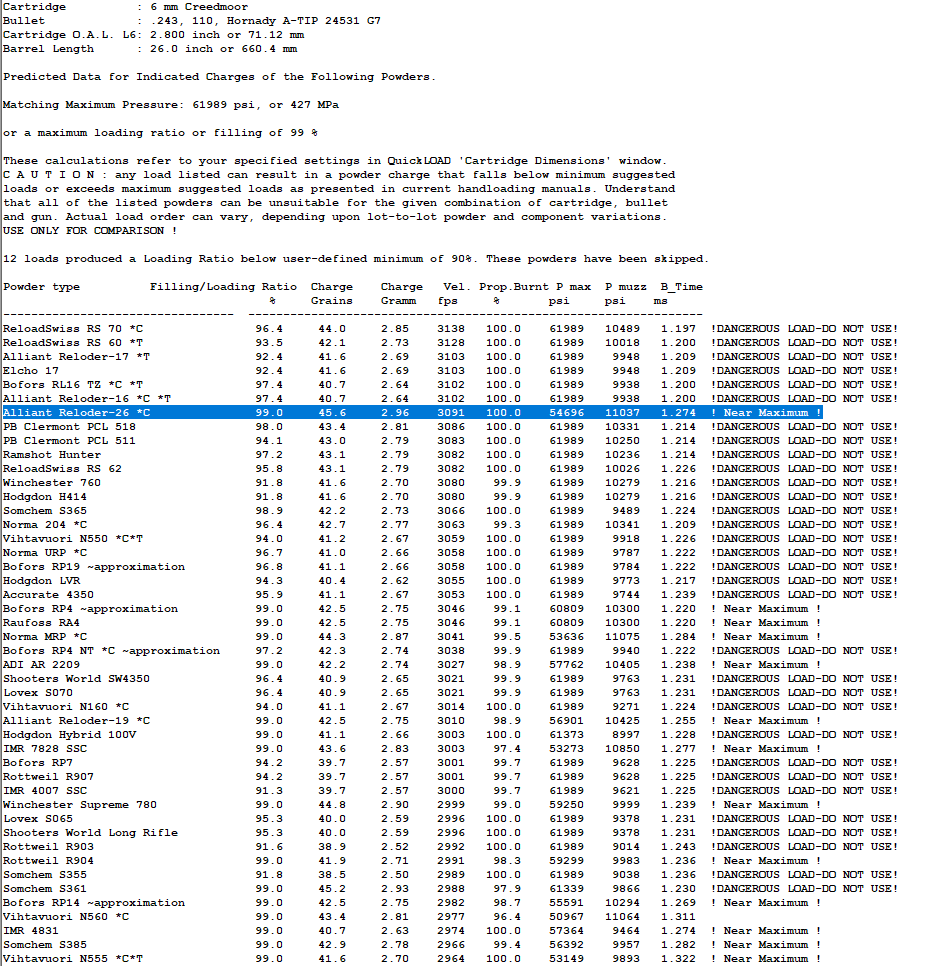

Have a look at the load data from Hodgdon for both with H4350 H1000. That’s a great powder for 6mmC It’ll work with a heavy bullet like 110 A-Tips out of 6mmC and it might be slow enough in 6.5PRC with a 130-ish grain bullet. But honestly, with a 6.5PRC you should be aiming to get the heavy bullets going fast, otherwise what’s the point of a 6.5PRC over a 6.5 Creedmoor?

6.5PRC
6mmC
