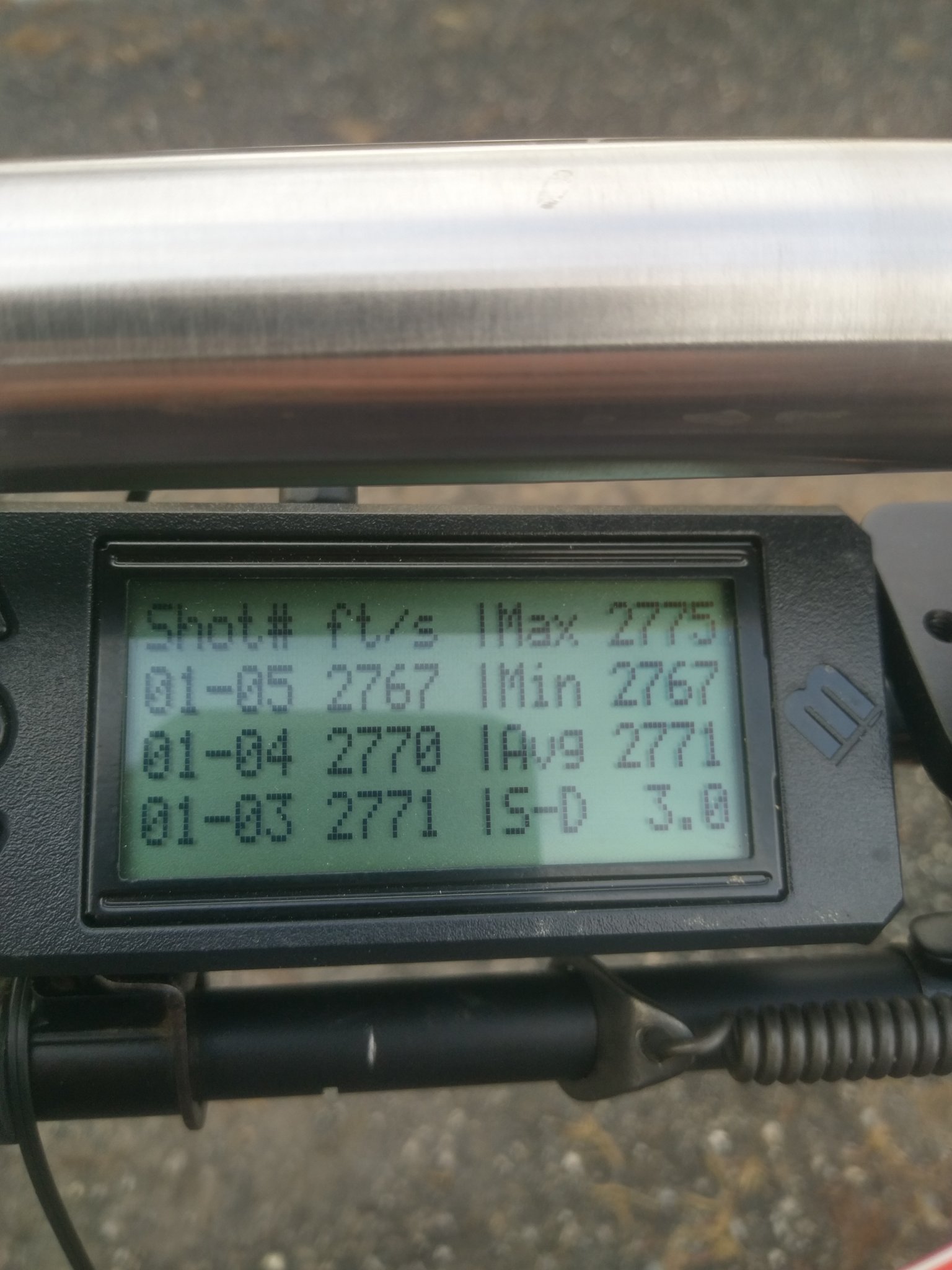

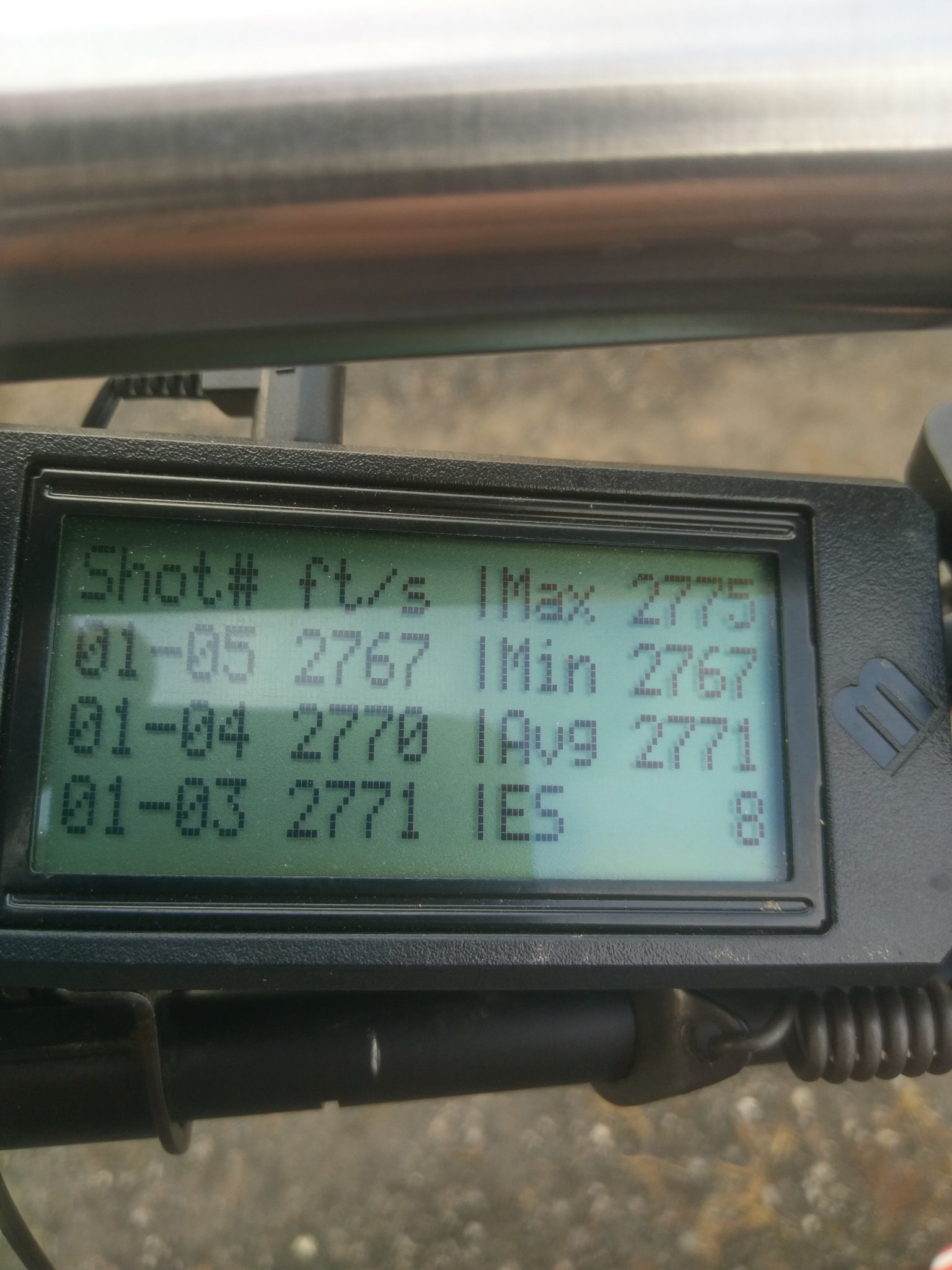

loaded on a Dillon 650 using two different chargemasters to throw the charges. The only mod to either of them is the typical bushing and speed settings. This is a 130 Berger hybrid from a 22" PVA tube in around 20° f temps with H4350.
