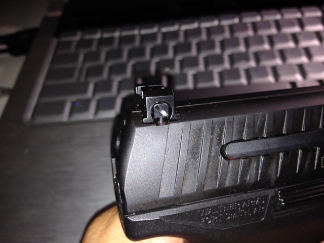

Has anyone here had an issue with the rear sights on a PPQ? Mine wants to slide freely from side to side. I've heard of shimming ondernesth the sight or using loc-tite to provide the necessary friction, but wanted to see if anyone else has tried to fix this problem.

If the PPQ has the same type rear as the P99 it sounds like (this is sort of a WAG) the plunger is gone and the threads aren't holding on the windage screw?
What you should be seeing:
Is anything missing on yours?
Hey Gimpy, are you still around? Did you ever find a solution to this problem? I'm asking because I'm experiencing the same issue with my PPQ, ever since I installed a set of Trijicon night sights. Or, if anybody else has experienced this issue, I'd sure like to hear about it. Thanks.
Djach
The best advice I can give is to look at the picture posted by Veer G. My problem ended up being how that set screw was sitting.
Thanks for the quick reply. I guess I'll just have to experiment with it some more at the range.

I had been struggling with the loose rear sight for two days, until I logged onto this forum. The above picture from Veer G was the thing that helped solve the problem. What I learned subsequently was that, to lock in the sight, the slot on the plunger head needs to be parallel with the screw. Hope this helps. I love this gun but the sights are not worthy. Weird design and I've learned my lesson- don't tweek the PPQ rear sight! I'm done.
