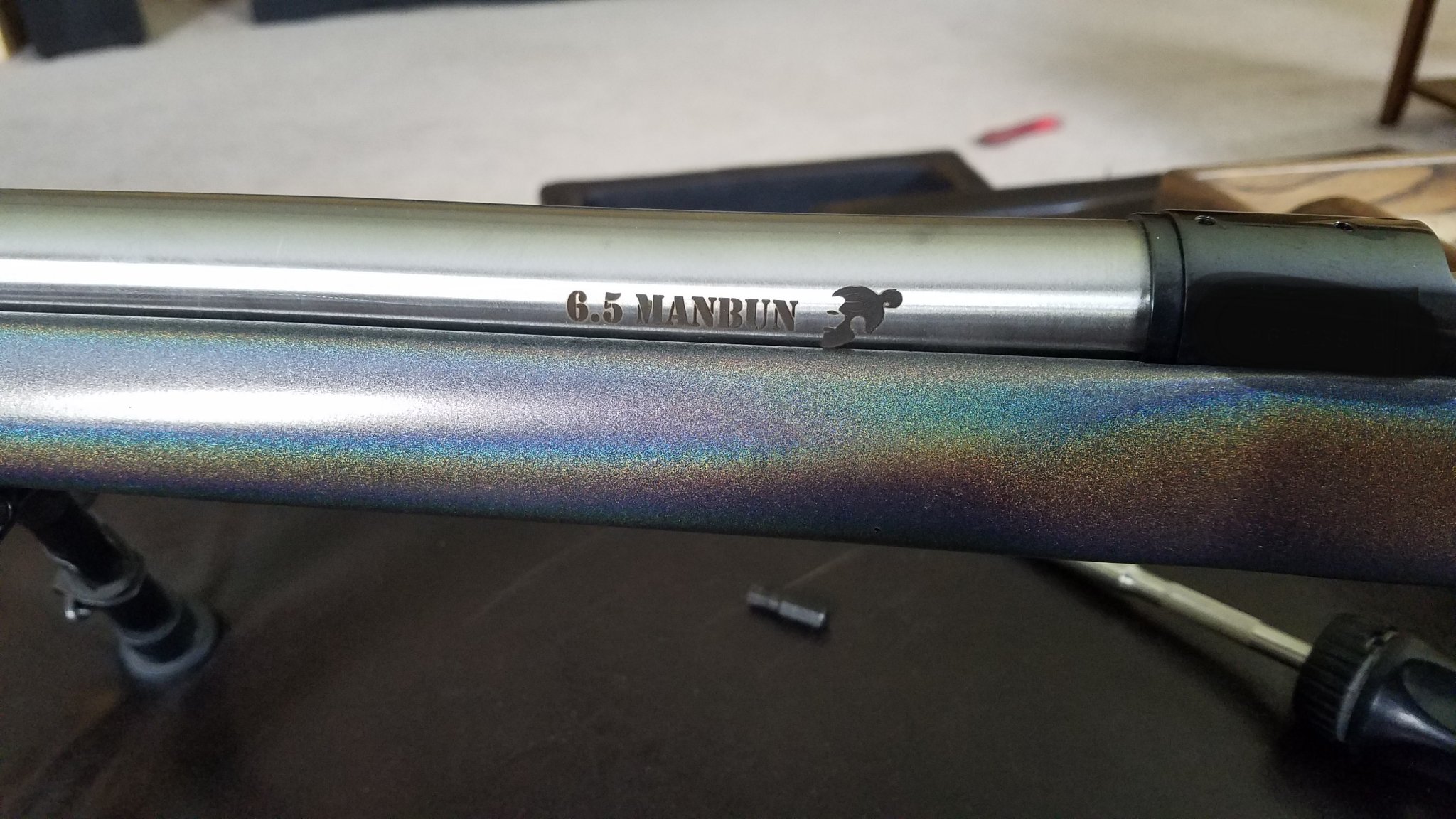

I have a 25" Manbun barrel because I didn't want a 24" or a 26"...
