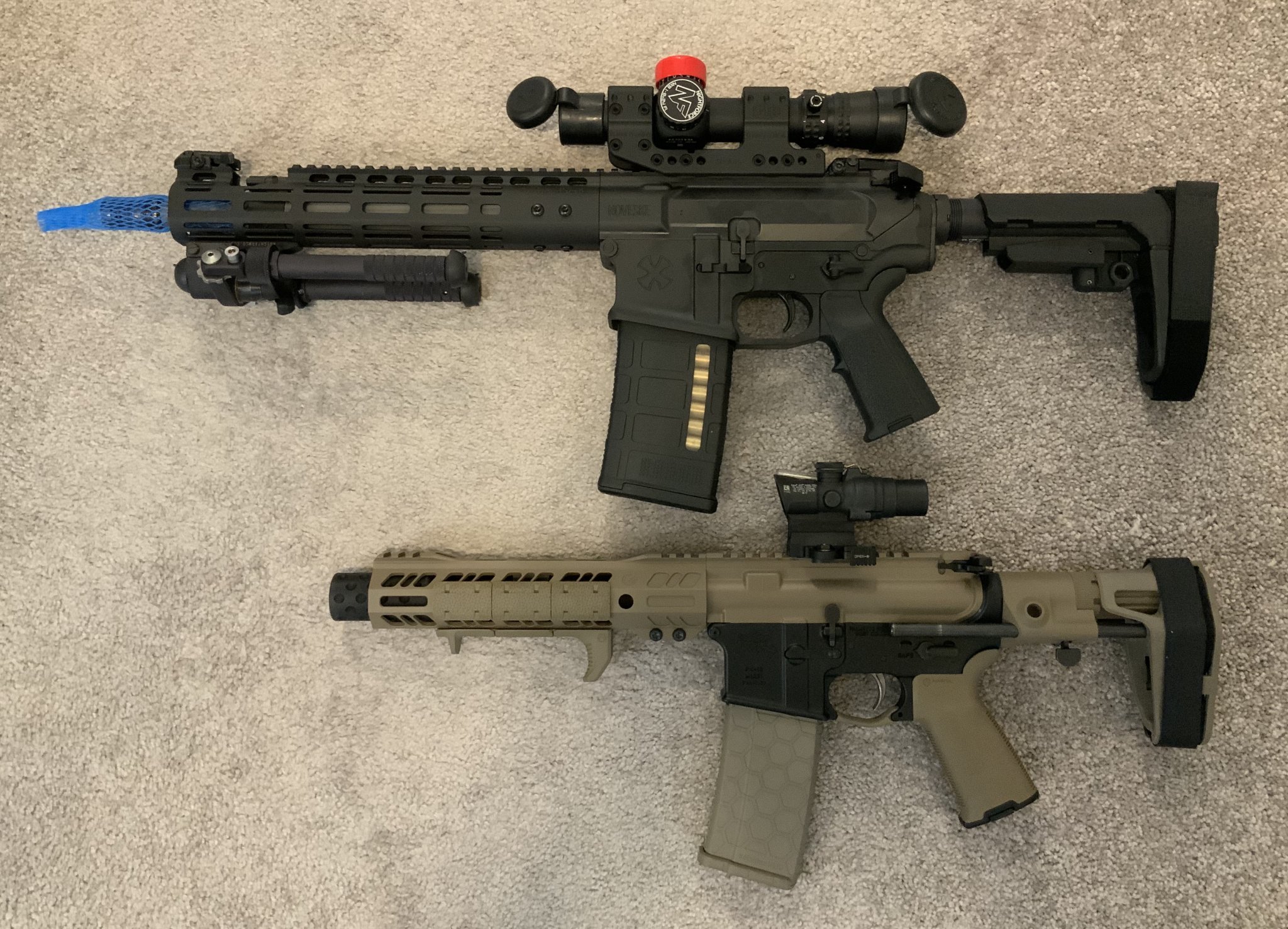

I have both a Noveske 12.5 in 308 pistol and a 300 BLK Pistol. Although I enjoy the 308 as a range gun there is no way I would use it as a close quarters/ HD pistol indoors without it being supressed. Although compact, its bulky and a flame thrower. Also with a shortened barrel I find that it is harder to stay on target for longer distance shots rather than the 300 BLK without a lot of practice. For functionality they are about the same and with a 25rd mag of 308 capacity is not much of an issue. FWIW...Some positives for a 300 BLK is the modularity with switching out 556 uppers , cannibalizing M4 mags, and no special adjustments or swap outs on a PC makes it a bit more versatile. Here is a pict for comparison:

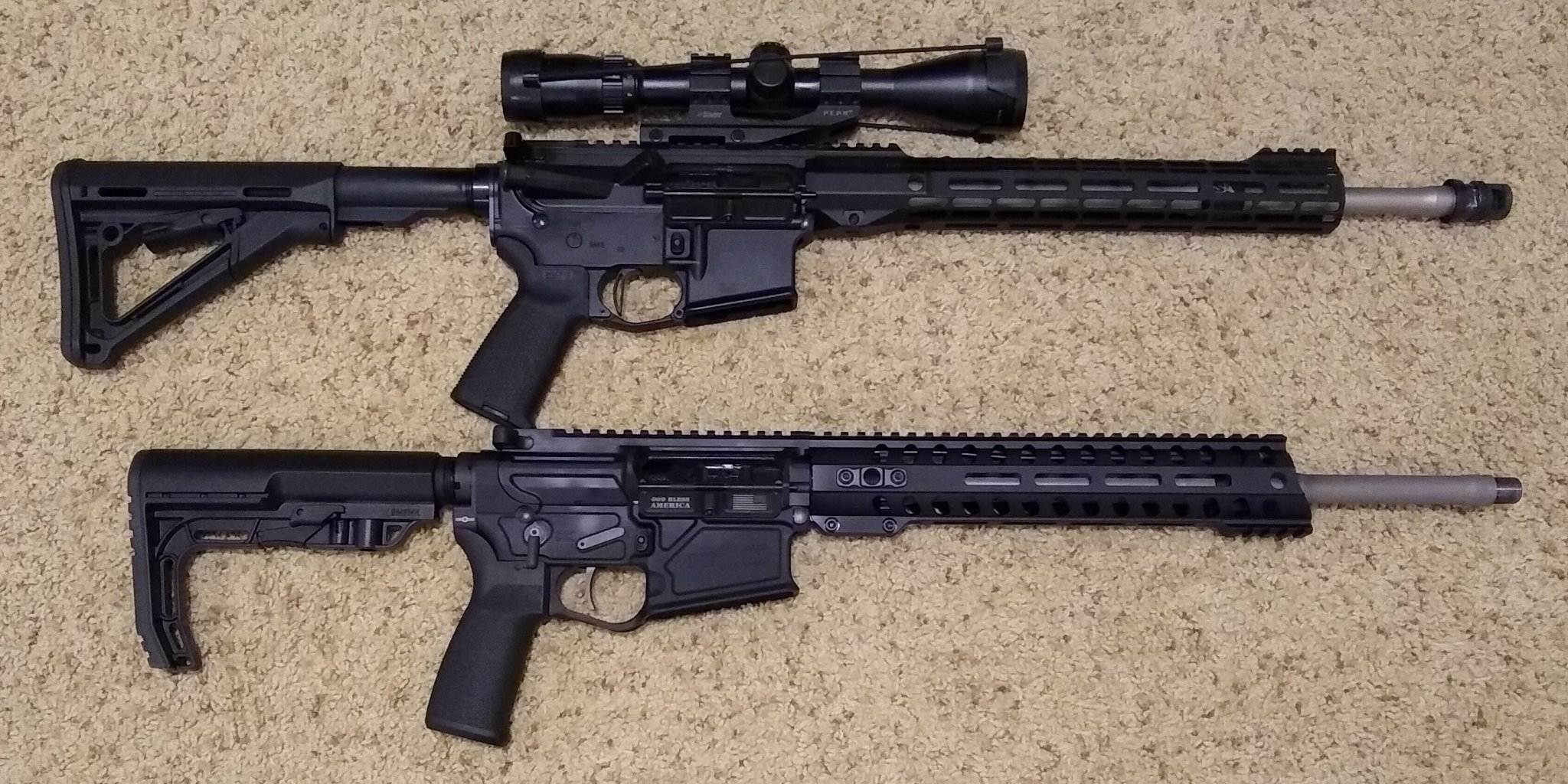

FYI I have a 6.5 Grendel that was doing 2450 when it was 16" and now does 2315 cut down to 12". That's with 123 SST. It blows away the 300 BLK. For such a short light gun its got plenty of power. I've killed a pig at 350ish (lasered) yards with it. I've only used 110 VMAX in the 300 BLK. I've killed a handful of animals with it and don't suggest that particular combo.

My Rogue, was compact (literally AR-15 size), light and accurate. It was not great, however, when suppressed. I went through two different AGBs and some different buffer weights but regardless, when suppressed with the AGB one or two clicks into cycling, it was tearing up brass. I think the timing of the mid-length gas on a .308 just didn't work well with a can, even when flow volume was cut to the minimum. Maybe that's why intermediate gas systems are a thing on 16" .308s, and I think that the Revolution actually has a longer intermediate system. Again, excellent rifle unsuppressed, but since you plan on shooting mostly suppressed, wouldn't recommend the Rogue.
My Rogue, was compact (literally AR-15 size), light and accurate. It was not great, however, when suppressed. I went through different AGBs, and some different buffer weights, and when suppressed, with the GB one or two clicks into cycling, it was tearing up brass. I think the timing of the mid-length gas just didn't work well with a can, even when flow volume was cut to the minimum. Maybe that's why intermediate gas systems are a thing on 16" .308s, and I think that the Revolution actually has a longer intermediate system. Again, excellent rifle unsuppressed, but since you plan on shooting mostly suppressed, wouldn't recommend the Rogue.
Ah, thanks. I had wondered what the differences in rogue and revo were. I thought it was just lighter weight and no adjustable block. Good info homie.
I can't speak for the Revolution, either regular or DI, they might be fine suppressed.
The size and weight of the Rogue was excellent though, here it is below my 16" light-ish Grendel (runs great suppressed). The rogue was actually a tad lighter.
I put a DIctator gas block on my Rogue before I even shot it. Aside from the fact that FGM 175s shoot just outside MOA, I've had few complaints with mine. Runs fine with either a Harvester or a Resonator K. A couple clicks on the gas block and it runs Atomic 260gr subs flawlessly. It shoots most factory match ammo at 1.25 moa, and 130gr SOST at 1.5 moa, which is all the better id expect an 1/8 308 to do. Mine is just a truck gun so thats good enough for its purpose.

If you build a 12.5" .308, you will hate it and eventually turn it into something else. As several have pointed out: heavy, painfully concussive, ridiculously filthy, it won't like the same .308 ammo your normal .308 guns like, and at most 200-300 fps advantage (in a 12.5") over 300 blk because you can only burn so much powder at a safe pressure in a certain length barrel -the excess is fireball.
With the 300 blk, you can use one load for ANY length barrel. In my opinion, the best bullet for the 300 is the Speer 125 TNT. It will do 2050 in an 8" up to 2300 in a 16". The bullet gives match grade accuracy, outstanding performance on deer and hogs, ideal for home defense; one round to do everything and does it all exceptionally well.
I have been running my 12.5" Noveske Switchblock 308 for years and love it. Coupled with my 1-8 ATACR it is nothing to shoot hogs out to 600yds. I usually use 168 or 175smk for accuracy purposes. The barrel likes both loads. Now it will never be no was it ever intended to be a 1000yd gun but I love the enerhy on target at the diatances I hunt at and is much lighter than my 16" Novekse 308 and my Scar20 308.
