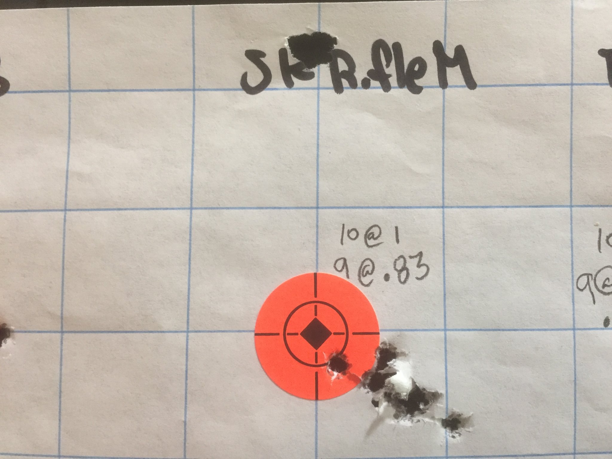

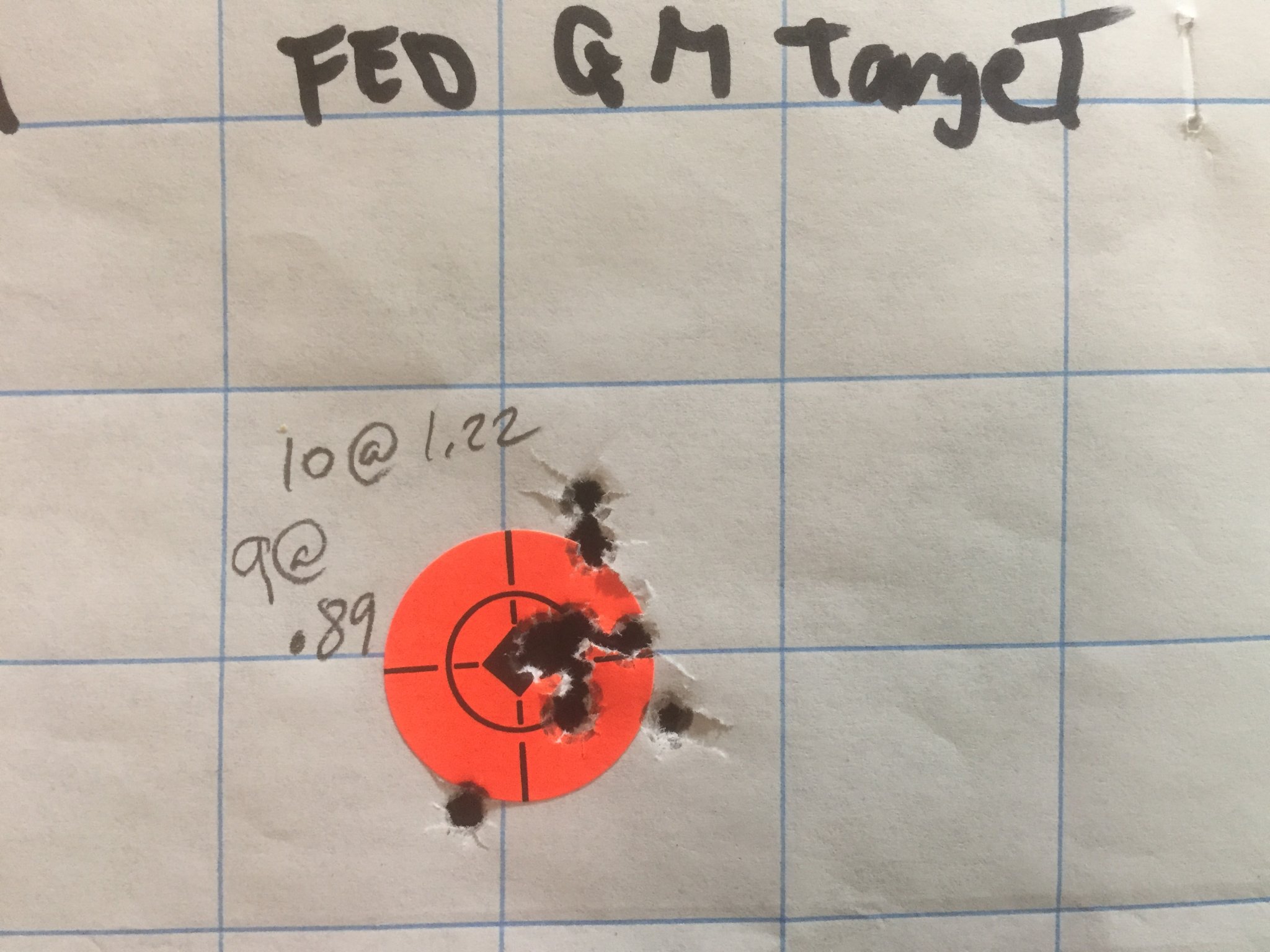

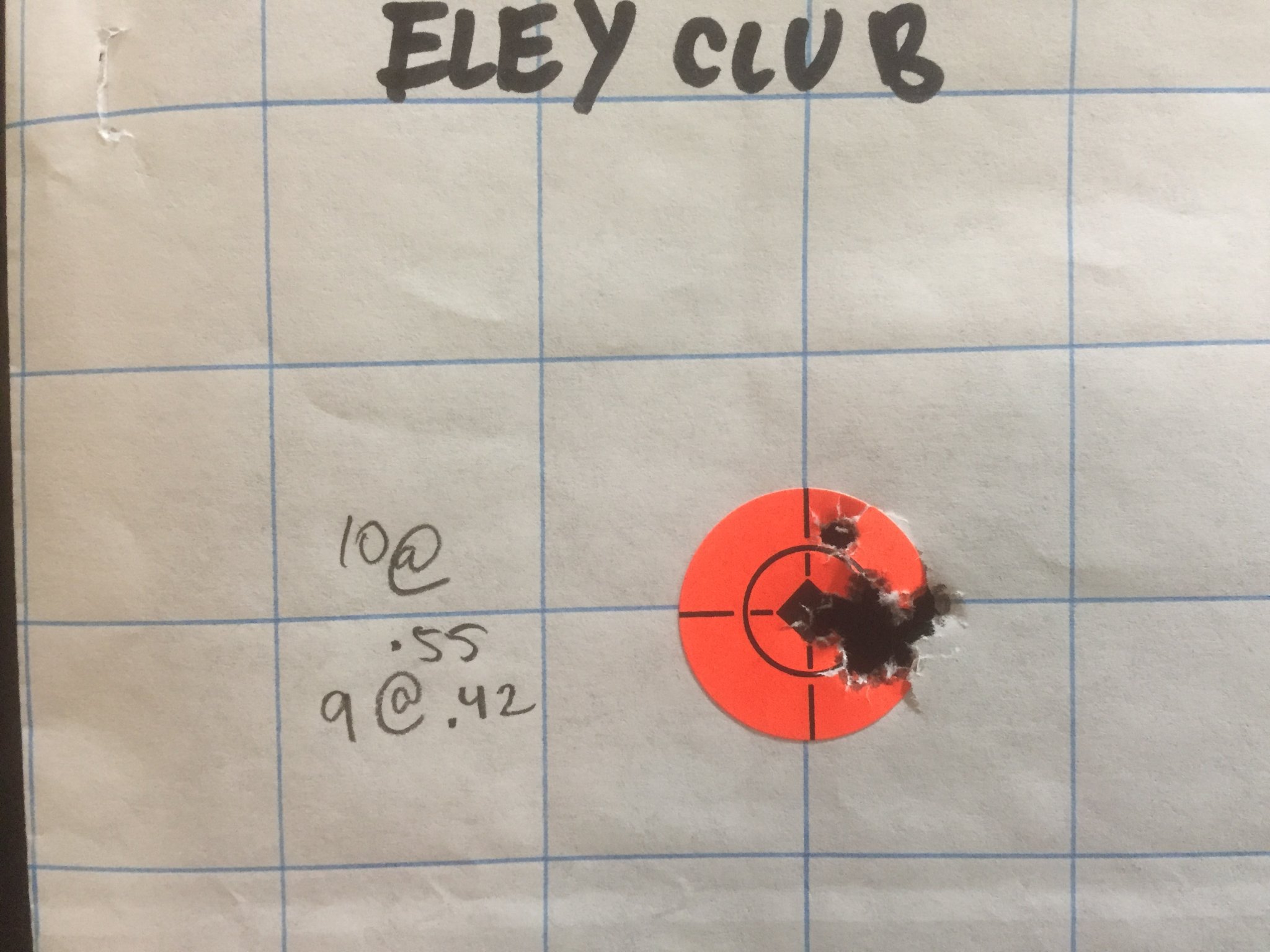

My KIDD rifle with the 20 inch straight taper SS barrel had POI shift with Eley Club, SK Rifle Match and FED GM target. The Eley I picked up at 6 - 7 dollars a box on sale and the SK RM was a bunch purchased at 6.81 so I just shoot what the rifle likes. These here are ten shot groups and Eley was more consistent with less flyers. Under each target is 4 X 5 shot groups of each ammo. The SK had some of the better 5 shot groups but had to throw a flyer now and then.
View attachment 7034827View attachment 7034829View attachment 7034830
Please annotate range to target when you post this stuff! I am one to appreciate good feedback w/pics certainly. That said what was your range to tgt? Downrange and atmospheric conditions? I have trouble personally understanding what was meant by "10@X" and 9@Y" with my feedback being with respect.
10 @ .55 would annotate 10 shots for a group of .55 inches etc
the shooting was done at 50 yards I apologize about leaving that out.
70 deg, 20% humidity, 1800 feet DA and wind 3-7 mph swirling from left and right and straight on.
Under each target was 4 more targets with 5 shot groups. Eley had two 5 shot groups at .5ish one at .6ish and one at .7ish
SK had some good groups one at .4 and one at .36 (inches) then a nice group with a flyer to go .6 and another with a flyer to go .8
FED ammo would like to be good, three rounds touching then two wide to make for so so groups.
ahhh got it. I like that you toss the flier out of each 10 round group....is it is producing solid performance 90% of the time so-to-speak Ide consider it consistent enough (as far as 22lr goes) Thanks for the update and sharing
