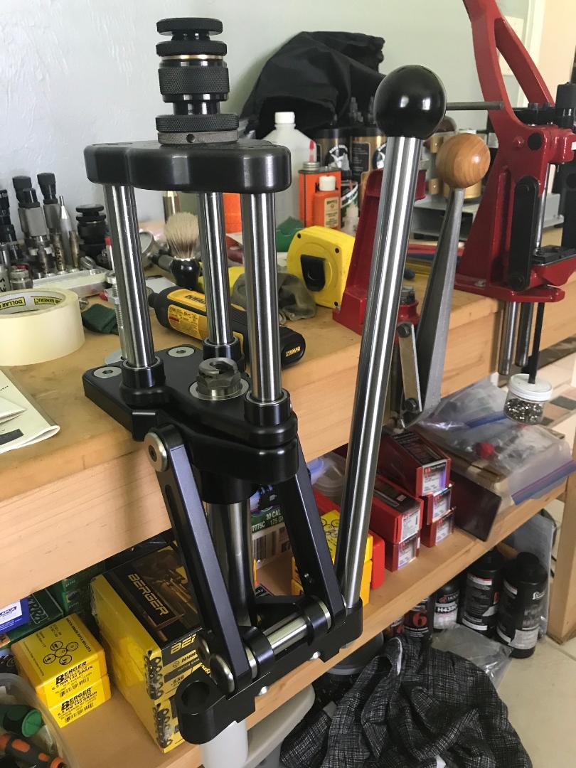

I've been using the Heavy Prazipress 140mm for about 6 months now with Triebel dies for .338LM, .300WM and .308 Winchester. The press is built like a block shit house with no wiggle whatsoever in the ram. It may be as much a factor of the dies, although I believe everything contributes, but run out to the third decimal place is consistently zero.
I've had the 140mm a little over a year now, still amazed at the quality of German engineering, perfect press for my Warner dies, my CoAx is being used for depriming now :p
