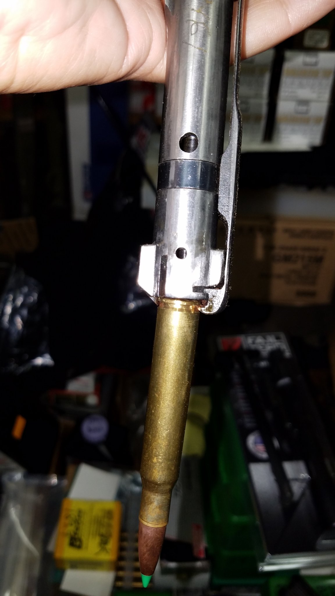

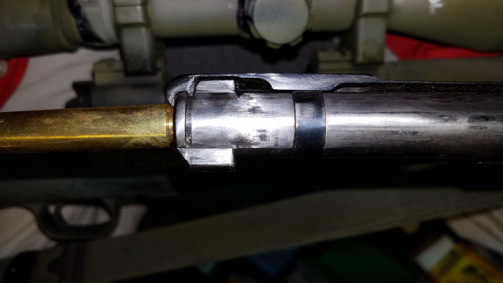

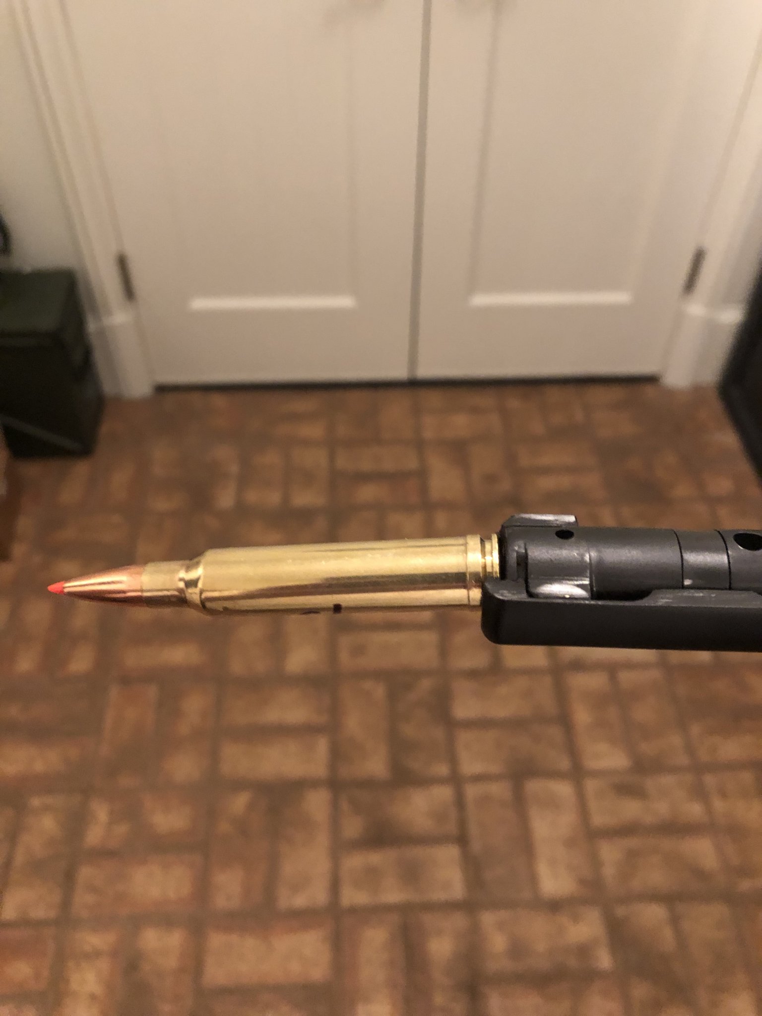

    Two pics follow... round held in place by extractor like its supposed to be.
    2nd pic, lack of space btw cartridge base and bolt face, correct.
    How close to this is yours ?
    If it were a non contoured/non cut std, you couldn't get the round in the bolt. It would be too deep into the case space.
    That's an awful lot of gap.. like cut too deep, first glance and first impression. I could be wrong, be happy to be wrong.
    Good news is you can interchange a post 64 control feed extractor on a pre 64, so, if the extractor is cut/contoured wrong, you can find a replacement.
