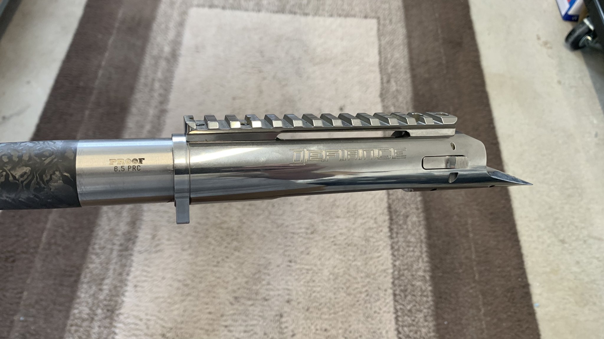

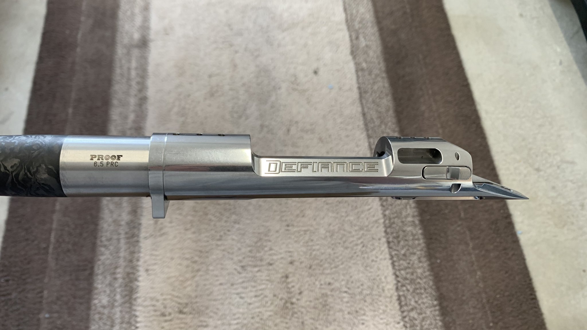

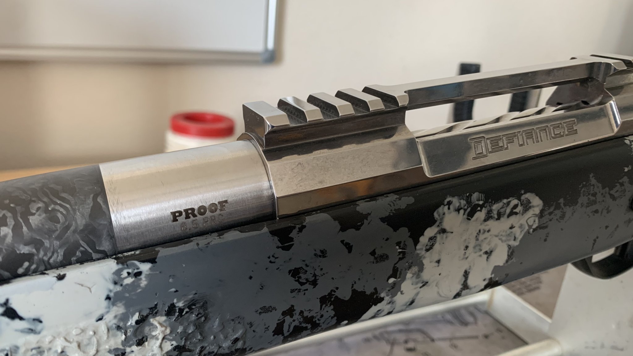

    How can you check the indexing ?
    I'm simply referring to the indexing of the markings on the tenon; the "PROOF" logo & "6.5 PRC" text end up below the stock line.
    PROOF says they're supposed to end at 3 o'clock (or 9 depending on direction you're facing), but they don't guarantee.
    Oh I get it now, my prefit Benchmade is exactly at 3 o'clock just above the stock line, I'll have to check my Southern Precision Bartlein - would it affect accuracy otherwise ?
    My understanding from PROOF, no it won't affect anything.
    Though I was a little disappointed as I had to have the barrel re-marked at additional cost.
