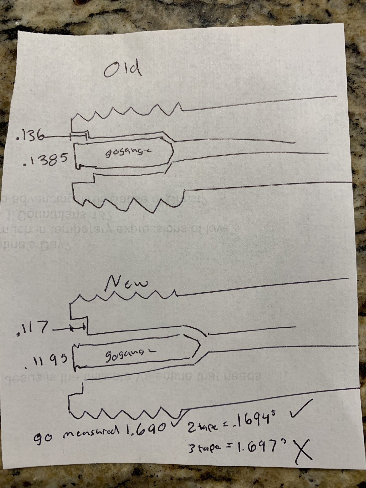

    If I send a smith my action, smith measures said action, cuts a barrel, then sends me the action & barrel separately, is that a prefit or a "custom" barrel?
    If the action mfg sends tenon print, smith cuts barrel based on tenon print, and then smith torques the barrel to the action, is that a prefit or a "custom"?
    If smith has action in hand, measures action, and the measurements match the mfg print, is the barrel that gets subsequently cut a prefit or a "custom"?
    Is the difference whether or not bore curvature is timed? Is the difference whether or not the smith torques the action to the barrel themselves? Does the engraving need to be timed? Is there something else that you are thinking of that differentiates the two?

    Here is my beef with the prefits and why for the most part we don't offer it as a standard.
    Argue all you want about cnc this or that and how much better the actions are held to spec. wise... the reality is... the receivers and bolts still have a tolerance. Not naming one but I'll pick one and say the receiver and bolt are supposed to be held to +/-.002".
    Even when we've done a prefit for close customers/guys and I personally delivered the barrel and we put it on the action together and we held the barrels breech length and head space right to the middle of the tolerance spec... we put the barrel on and the headspace ended up right at .000". If we would've been only .001" on the short side... the bolt wouldn't have closed on the go gauge.
    Bolt, barrel, and the receiver... you start stacking the tolerances and it can turn into a quicksand pit.
    One custom gun/receiver manufacturer that we have made a lot of bolt gun barrels for they supplied us with a master receiver and a master bolt to be used as a master gauge for inspection on the barrel fit etc..... we threaded and chambered the barrels to a given spec and we checked fit with they're master gauges but they had us hold the headspace to the short side... so when we would ship a 100pcs at a time... if a bolt or receiver tolerance was stacked and things where tight headspace wise... they would go in with they're chamber reamer and bump the chamber to set the headspace.
    So if you get a prefit and it doesn't shoot... doesn't mean the barrel is necessarily bad etc... you need to check fit/clearances/headspace etc...who's doing it for the customer? The barrel should first go back to the shop and they should double check everything.
    Also we use to offer prefits for CZ actions for example. Based on what we seen.... one out of every 10 barrels we shipped there was a issue. Every time it happen we had the customer send us the barrel along with his bolt and receiver. I can't recall a single time that the barrel breech details was out of spec... tolerances smack dab in the middle of the factory CZ barrel specs... every time it was either the receiver was slightly different or the bolt was slightly different spec wise or the tolerances stacked. Then we have to do the rework which cost time and money. We seen receivers where the barrel wouldn't go on at all or it went on but the bolt wouldn't close or if it did the headspace was off. That's one of the reasons we no longer offer prefits for CZ stuff (besides being to busy). I hated getting the phone call and at times the customer was bent sideways and it was automatically our fault they assumed. Then on top of that we get them to send the stuff in and you can see where they were forcing things to make it fit/work and even more of a mess to deal with. Like I said... a quick sand pit!

    To me the issue is tolerances and the stacking of tolerances. A .0001" let alone a .001" can make all the difference in the world.

    Frank, is it fair to say that your contention with prefits isn't in accuracy then? Just basic function?
    Function and accuracy bud.
    You could have a function issue along with a accuracy issue. For example if there isn't enough clearance between the bolt and the breech face of the barrel.... it could cause accuracy issues. Gun can chamber, cycle and go bang etc... but it can affect accuracy as well.
    I can't even count how many guns I/we've seen over the years where the bolt was touching the breech face of the barrel.... give it .005" more clearance and presto... groups come right in and no more flyers.
    IMO coming from the machining QC world the best way forward is the prefit setups that use a barrel nut. Two reasons: the first is that it allows an easy remedy to situation such as Frank described where actions on the short side of acceptable tolerance can still be used with barrels on the long side of tolerance. The second is that it allows for very slightly more flatness variance in the mating faces of the action and the ‘shoulder’ (now the nut instead of the barrel) when torquing to spec. The why for the second one is more a topic for a Mech Eng classroom, but shouldn’t be overlooked.
    I will say however on the topic that a gunsmith is more likely to know how to torque to proper spec and have the tools to do so than your average customer who is just as likely to use german torque: gudntight

    On the comparison of the actions: Let's take this scenario
    Take a TL3-SA that the action headspace is 0.9248 and the print says 0.9250 +/-0.0005" with a Class 3B tenon thread.
    I cut a tenon for it that headspaces to 0.9240 +/-0.0005"
    Against the prints the worst case is 0.9235 barrel headspace and 0.9255 action headspace.
    That's 0.002" apart.
    Tightest they get is 0.001" apart.
    Thread fit: I cut to a Class 3 ring set. The fit is guaranteed to be Class 3 by both parties.
    By all data driven metrics this barrel is just as tight as a standard BR install comes from any of the OG guys. Is it less somehow because it was done in a machine in 20 mins instead of 2+ hours? Hardly. The data says the fit is there and it's backed by the inspection process.
