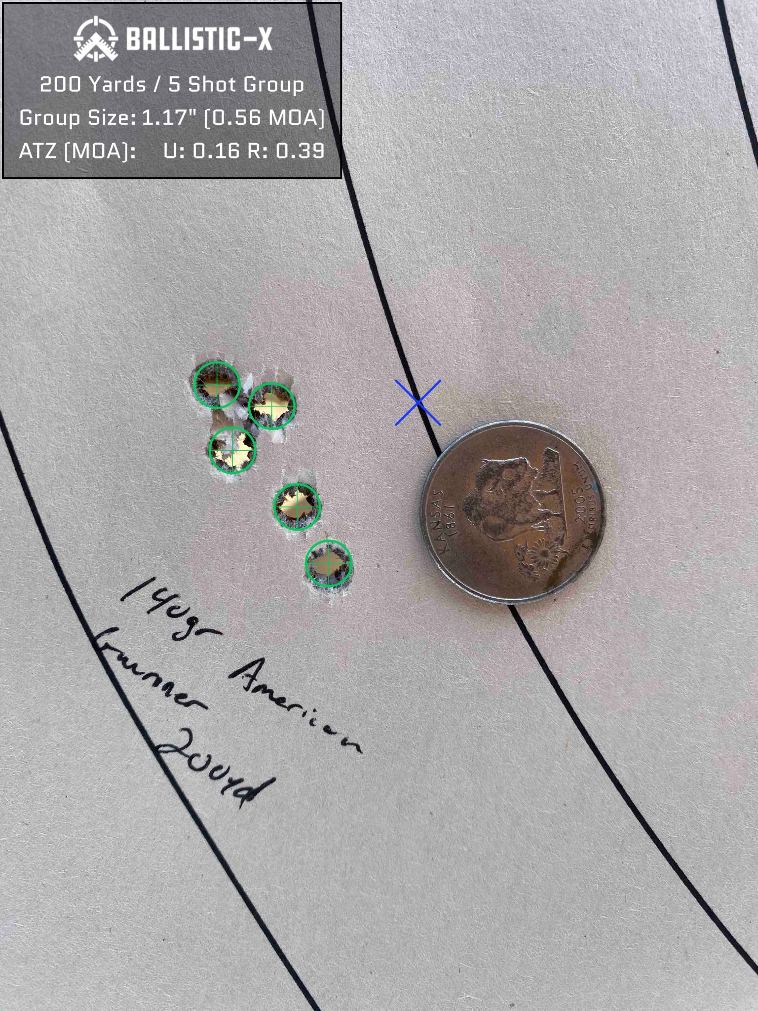

First group out of a tikka prefit earlier today.

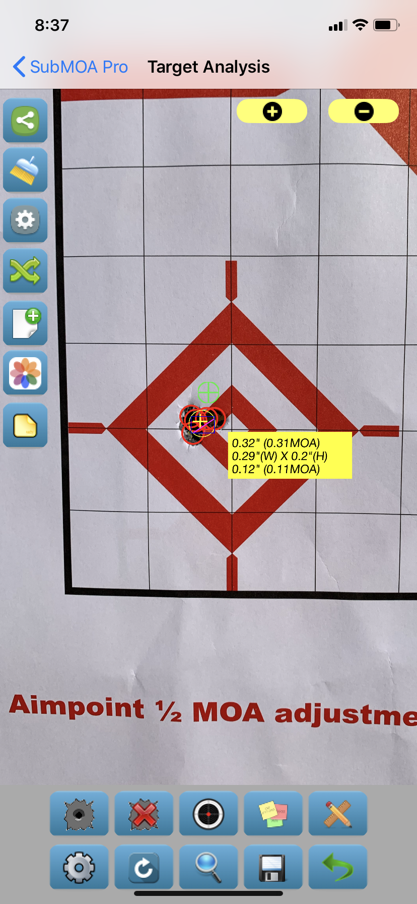

Groups at 100 and 200yds with my tikka prefit w/ barrel nut. Going out on a limb to say the only way it’s going to shoot better is if someone who has more experience is behind the trigger

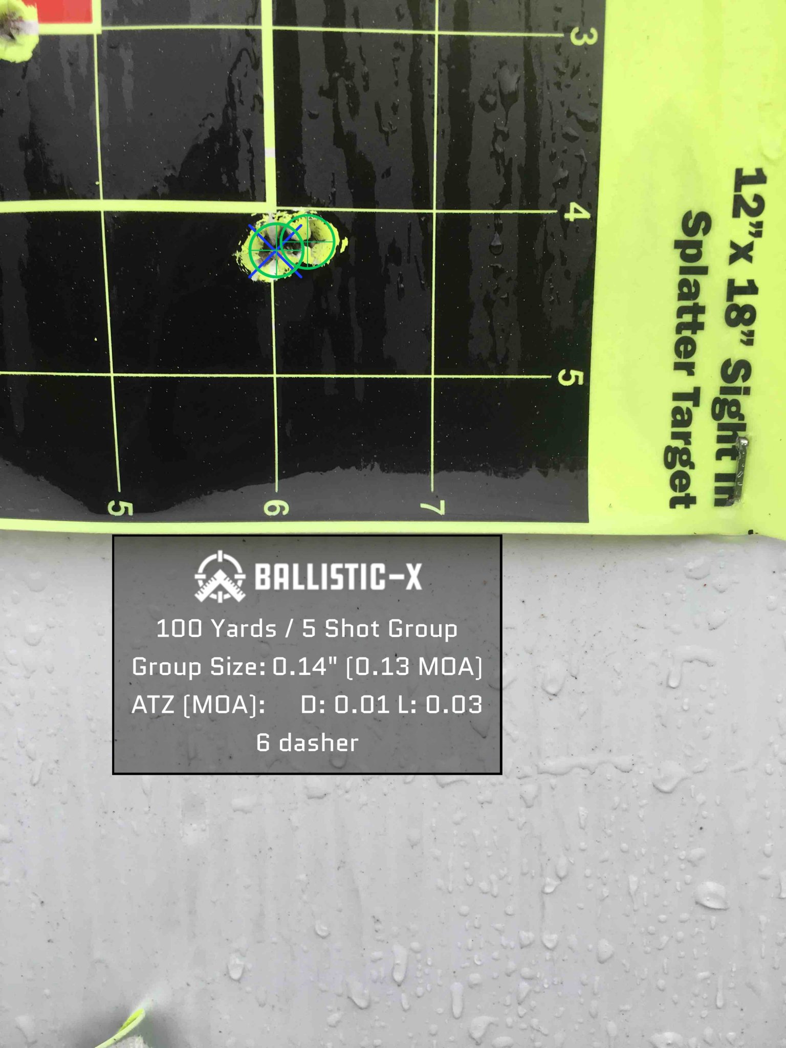

Group in the picture is from a PVA shouldered Prefit 6mm dasher with about 1500 rounds on it for my TL3. This was shot to check zero after dropping the rifle off a barricade accidentally. POA is the corner of the square. I’d say it’s pretty well zero’d and it surely took much more than a “wack” on the barrel.
