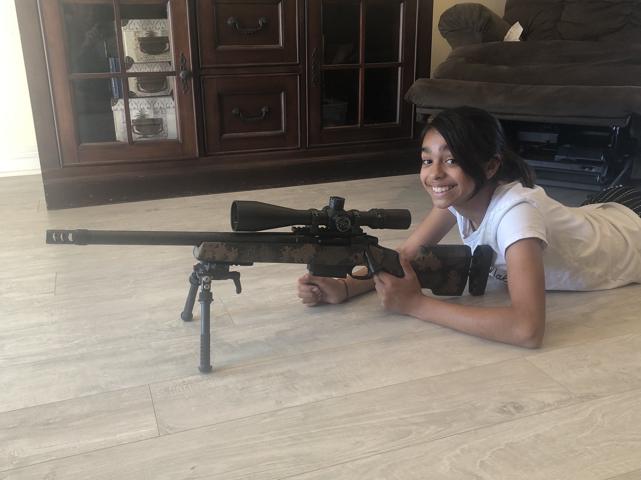

    Got her rifle all finished up. Her 1st one. Built it for hunting / and SS barrel for match shooting. Ready for her to fill her 1st Elk tag in October.
    McMillan LH Compact Stock
    Bighorn Origin LH
    16.5” Proof Sendero 6.5CM 1:8
    Area 419 Hellfire MB
    Trigger Tech Special
    NF 3.5-15x50
    I also have a 224 Valk Barrel for training for her, along with all the boltheads from 223 - Mag for when she gets a little bigger.

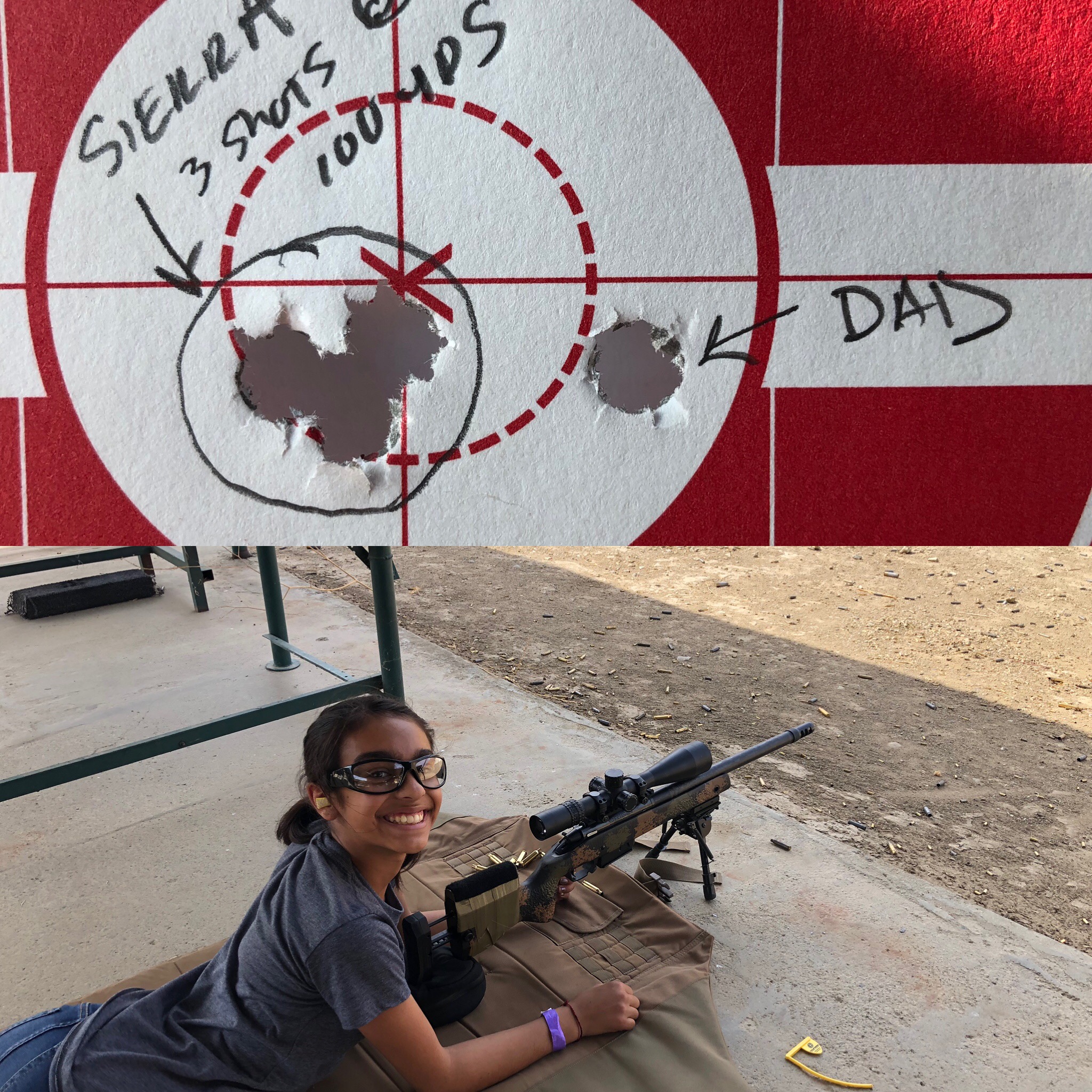

    So, got a chance to get the kiddo to the range with her new rifle and after I got it dialed in, she proceeds to show me how it’s done! ??, 1st 3 rounds she’s ever fired out of this rifle and lays down a .283” group. Factory Hornady 120gn ELDM’s...... Proud dad to say the least. I’ve spent some time training her on a 22 but this is the 1st centerfire she’s got her hands on. Hell of job by @fng23 on the barrel work!
    That's awesome, hope to see my kids smiling that happy doing the same someday--kid's a natural!
