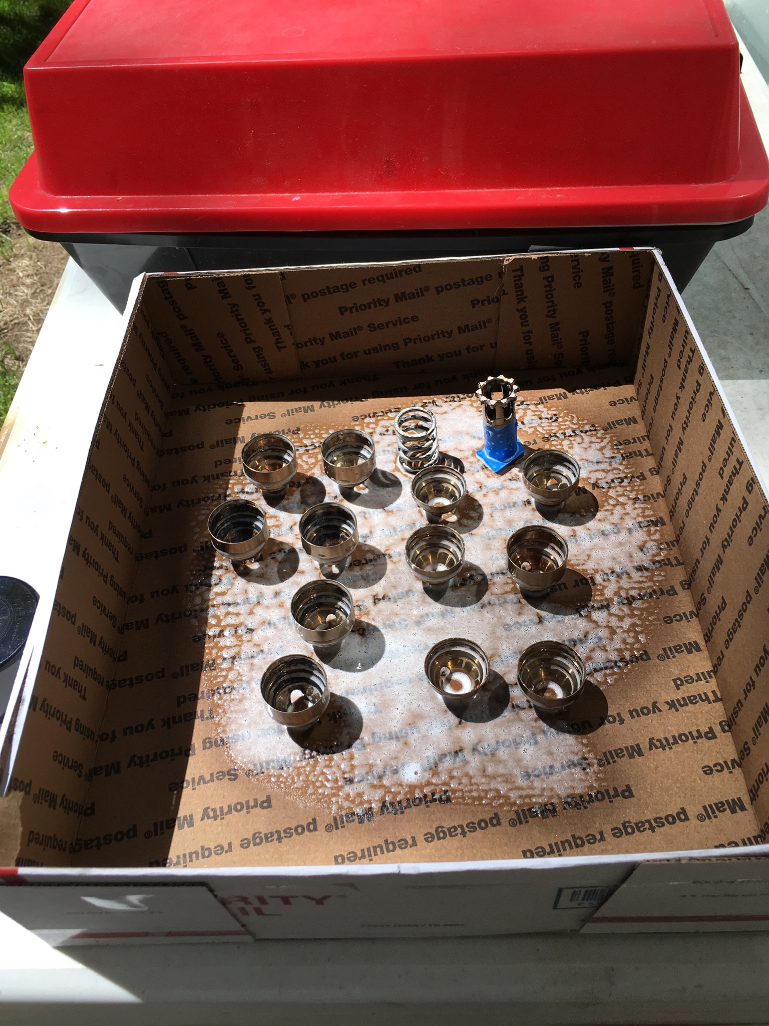

Do you have to re-treat your baffles periodically? In other words, after several shooting sessions and cleaning afterwards have you felt the need to re-treat the baffles with silicone oil?
So how long should I let the baffles soak in silicone oil after heating them in the oven? I'm thinking of taking them out as soon as the cool.

I don’t remember this hobart stuff being that caustic. Aside from that I use my brain 🧠(what little there is), and spray them outside wearing long sleeve shirt, rubber gloves, glasses and a respirator.....
