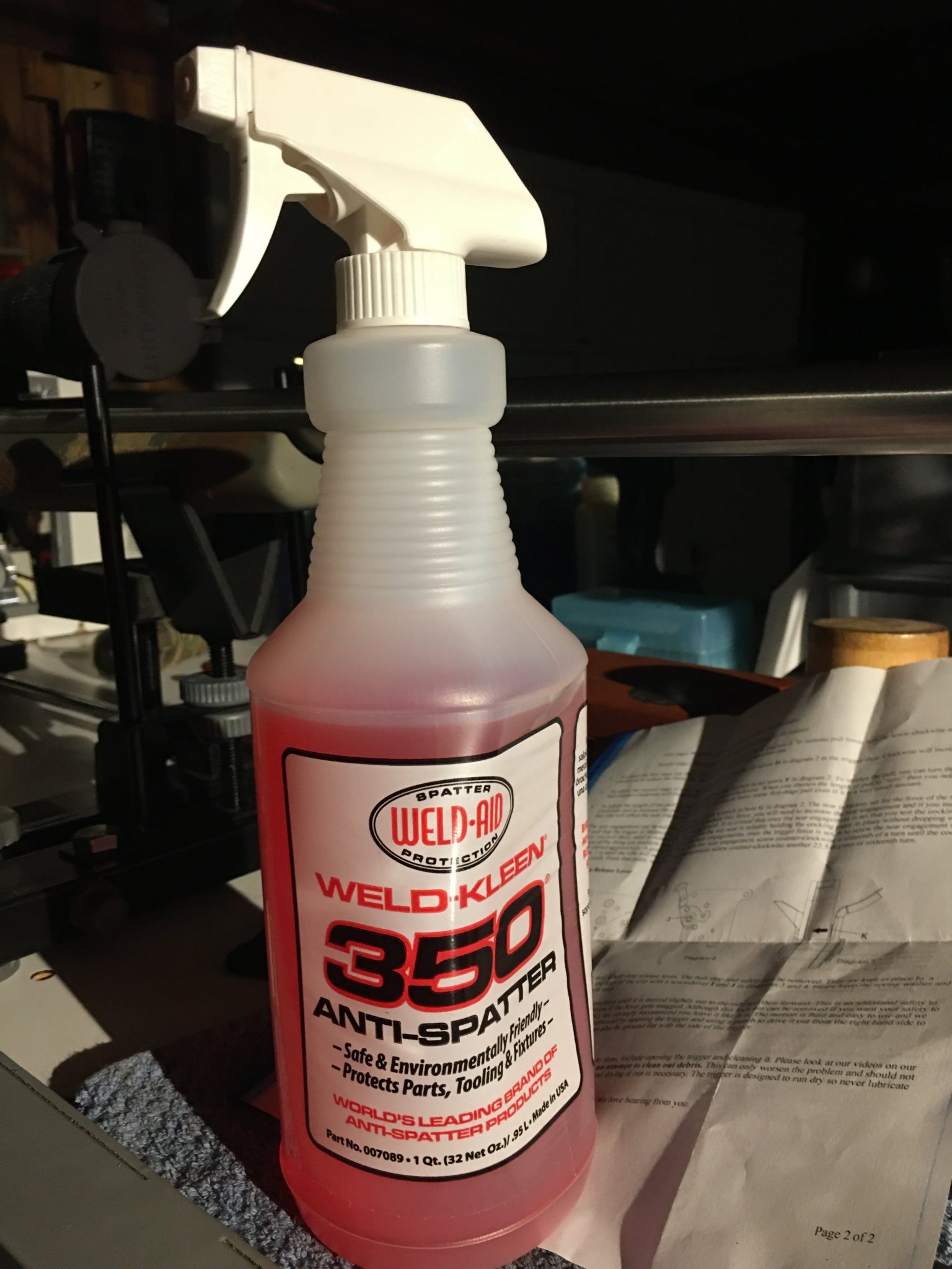

Anybody pretreating your Aluminum baffles to make them easier to clean? I have heard of people using Anti-spatter MIG Welding Spray. Is it safe on Aluminum? Also heard of people using FIRECLean anti-fouling oil.
Thanks
I'm using anti-spatter as a pre-treatment. Not on aluminum though. I don't know of any negative side effects, but you might e-mail or call the mfr. Here's what I use;
