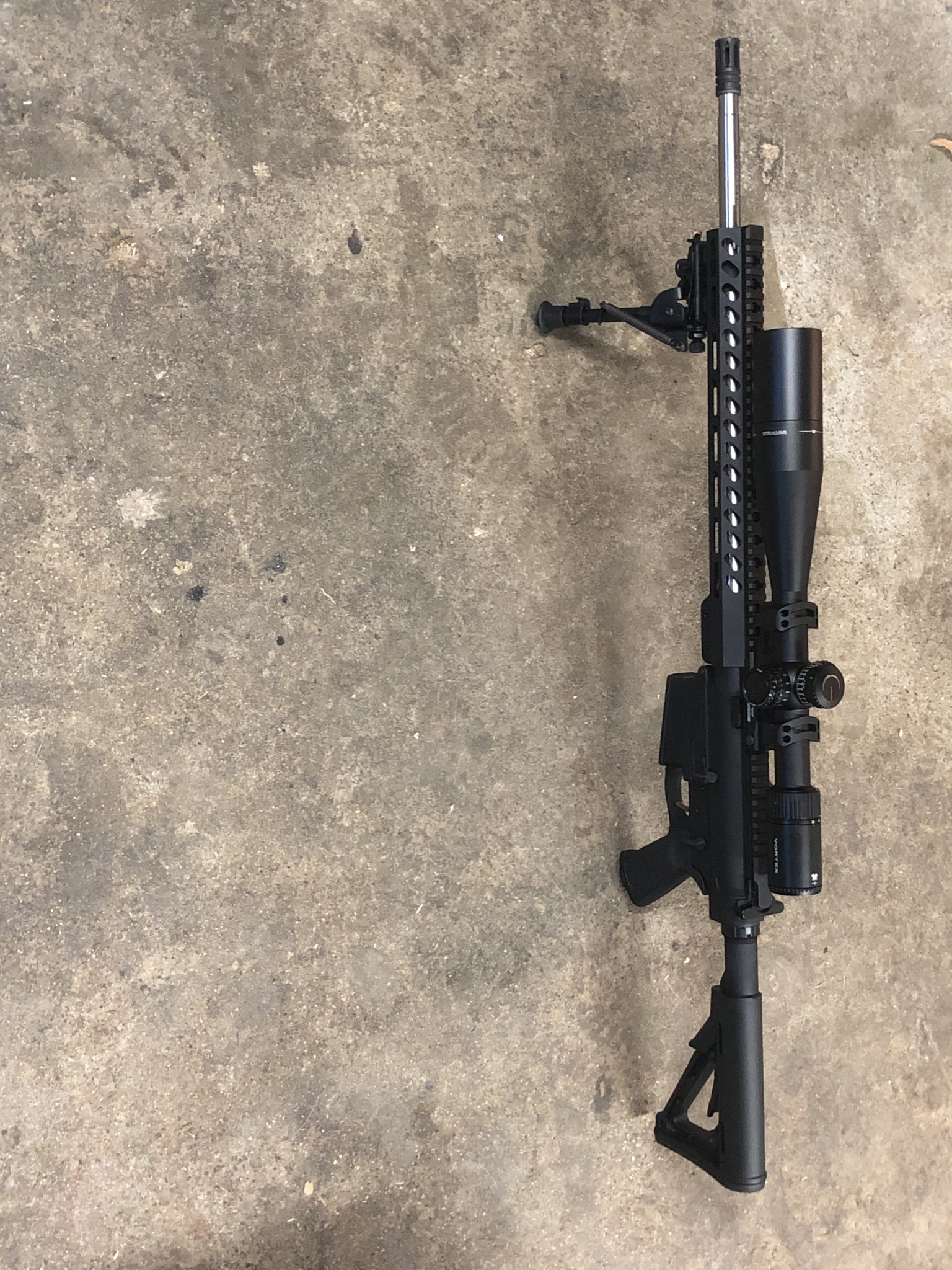

Here’s the rifle as it sits by the way, nothing special, just a regular pa-10 with a 20 inch ss barrel and free float mlok, with an enhanced polished trigger(not terrible but not great either),
A magpul ctr stock and magpul grip.

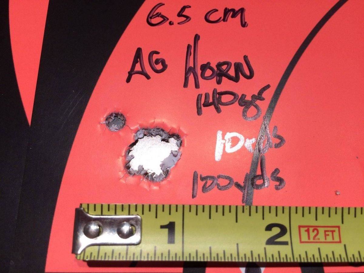

My first shots from my JP 6.5 with 140eldm ammo:

22" Criterion Hybrid 6.5CM... the 6.5CM cheats side winds far better then a .308.. built it right and I am very happy.
10rds Hornady 140gr American Gunner.. 100yds , benched scoped etc..... guess who flubbed the fliers on both groups... Lol
10rds .308 155gr Hornady American Gunner , FN CHF CL 20", 100yds benched , scoped, etc...
Same thing build 'em right and you'll be happy
Both rifles assm. on PSA uppers and lowers, lapped upper receivers , barrels Loctited in, Adj. GB's ( SLR ) Lantac Muzzle brakes ( both .308 ) Heavy 9.3oz rifle length buffers, .308 Tubbs Flatwire recoil springs. Upper to Lower snug fit.
Both groups produced from freshly cleaned barrels.
Reactions: benchmstr and TACC

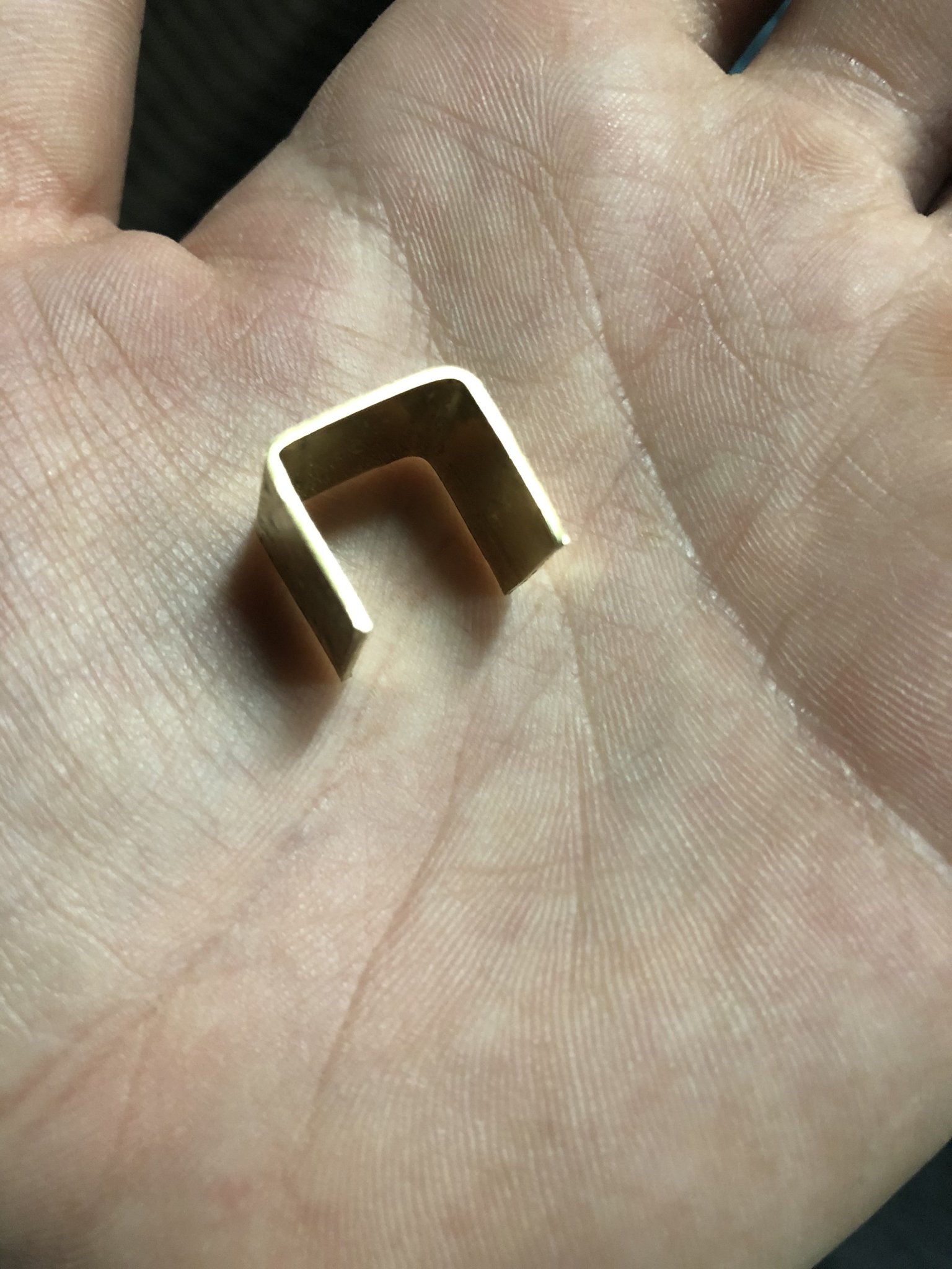

How did you go about getting the upper and lower a snug fit?
Did you bed it or were you just lucky? I’d like to bed them together but for now I made a custom accuwedge out of brass that wraps around the takedown lug.It takes away 95 percent of the movement and will not compress or degrade with time or heat or move at all so I know it will never cause an issue. i plan to make a thin shim for the pivot pin lug to remove the tiny bit of play remaining in the front.
